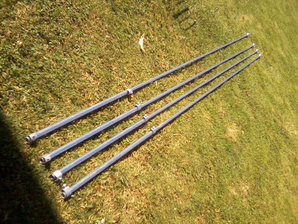

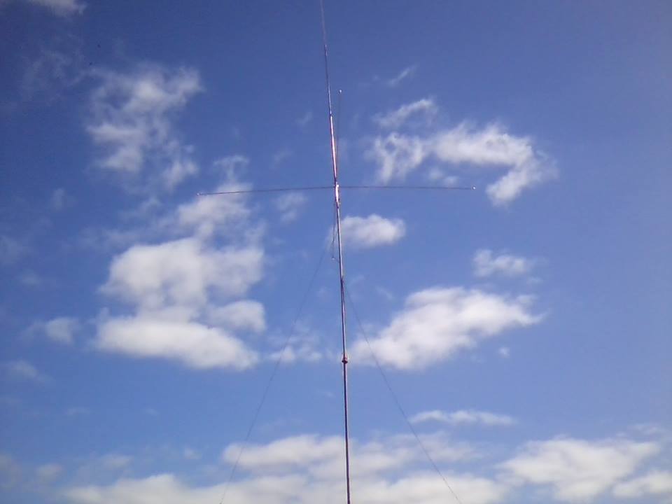

If you want sturdy sturdy quality built, gotta pay the price. just grab an Antron99, youʻll have alot left over for everything else and try to get a Maco Groundplane.
works better than the GP kit made for the A99. I have my SWR @ 1.2-1,3:1. I painted the antenna so the fibrglas wouldnʻt fray. I keep painting it evry time I bring it down.

Question on the Imax. Do you have the ground plane kit? Ive read that a 5/8 requires one to work properly.
A 5/8 wavelength antenna doesn't have to have a ground plane to work. That is not to say that you won't see a benefit from using a ground plane kit, but it is definately not required. The thing is, if you do see a performance benefit it isn't actually from a performance increase, but from lessening a problem you likely didn't know you had.
Also, with that length of antenna, stick with a ground plane kit that has horizontal radials. Wearther you notice it or not, the angled radials will cause more of your signal to warm some clouds...
