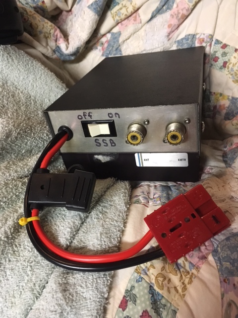

I can't seem to find what I use right now but I got them from Redmans cb shop e-bay store. It's #8 or #10 wire both red and black together with a fuse holder on the red side. They are about 10 inches long. I add them to all my small amplifiers along with an anderson style red quick disconnect. Ill work on posting a pic here if I can figure it out.

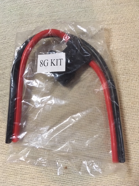

I got these off e-bay for like 6 bucks each with free shipping. Can't find them now but I really like the whole set up like this. That is a Texas Star 250 with a #10 kit installed.

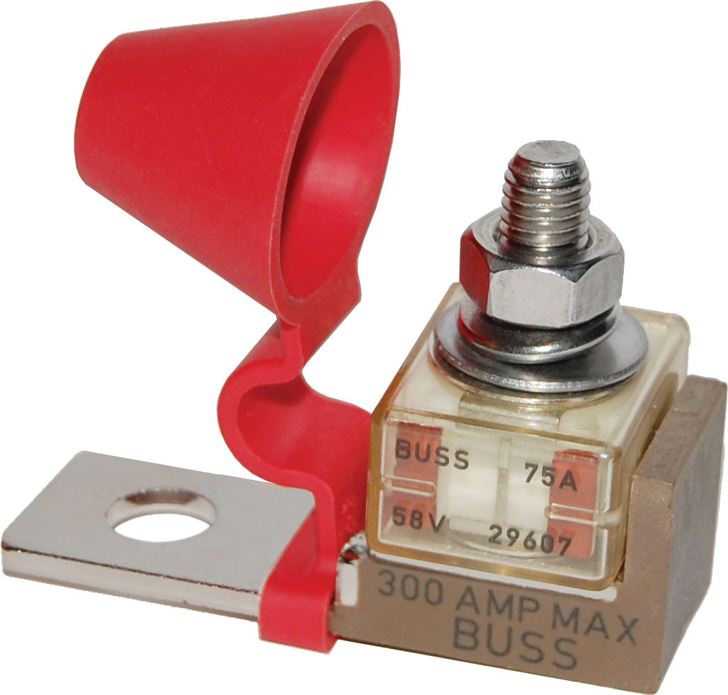

Blue Sea Termination Fuse Holder

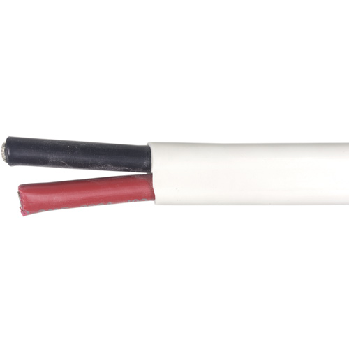

And ANCOR “Marine Grade” 8/2-Duplex Safety Wire:
Not cheap, but USCG standard works very well in mobile install. No solder (vibration), thus ANCOR adhesive-lined terminations.
