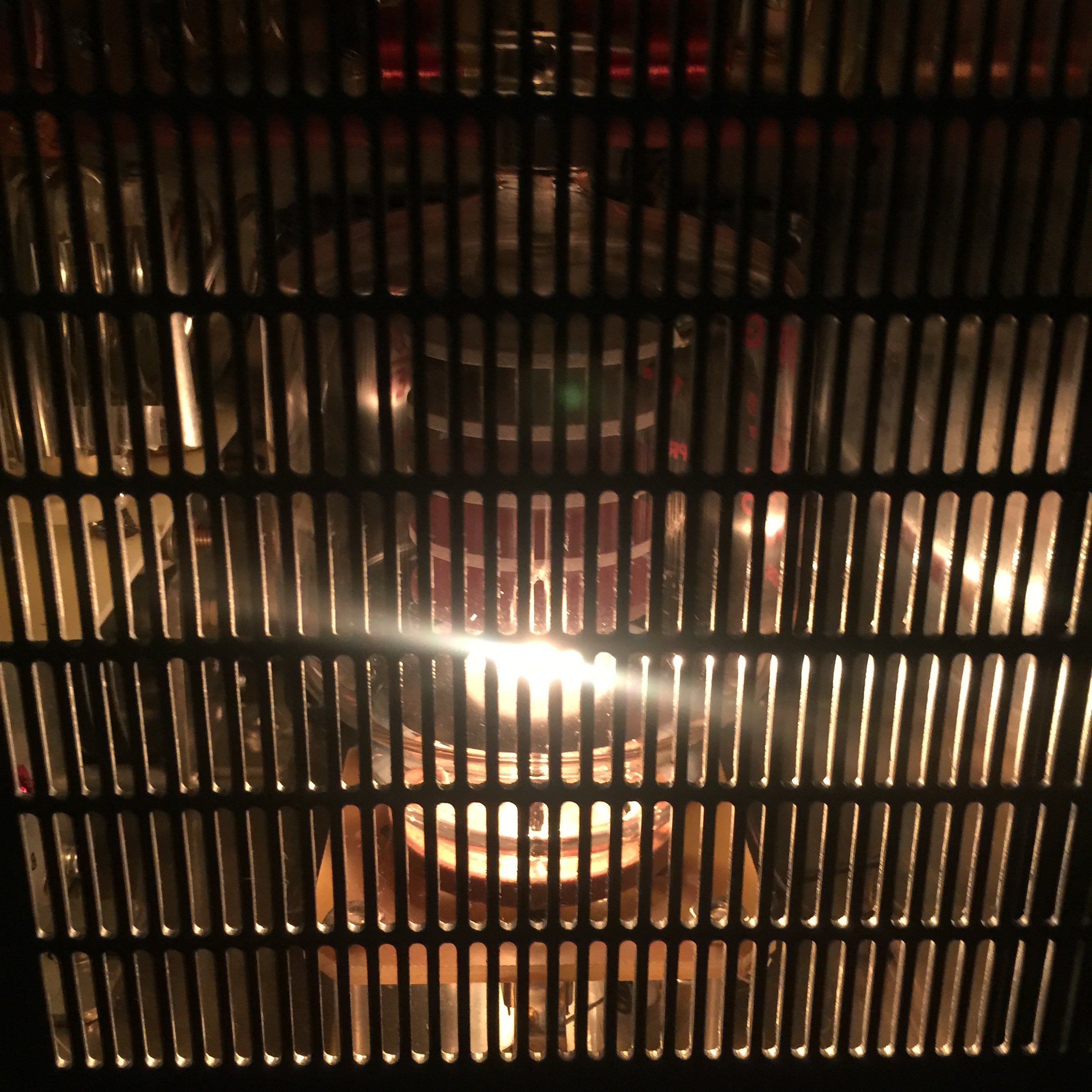

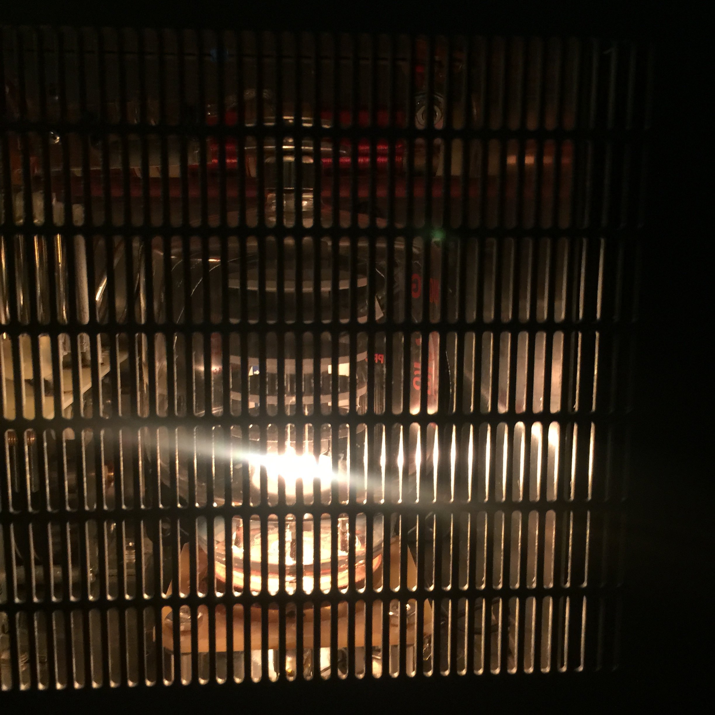

Tube idle
looks good, graphite type tube, little color, I have seen those 3-500 look like my avatar before.
need to get those tubes glowing, getter is the term.
google how to getter 3-500Z, W8JI has some good info on the 3-500Z triodes
