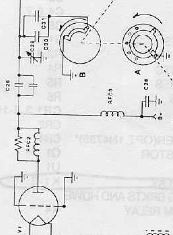

Hard to tell from picture those caps appear they are the Plate Blocking capacitors, which block the DC B+ voltage from getting to the (AC) RF Tank circuit.
You may get by with those in a sweep tube amp at lower voltage and power rating, however IMHO there is NO WAY I would ever use a disc type for the purpose in a high power amp.

BTW, I don't have a LK-500ZB schematic but the LK-500ZC schematic only shows 1 of these being used (C26).
LK-450 (1) 3-500z schematic shows 2 1000pF 5kV caps in parallel:
LK-500ZC (2) 3-500Z and LK-550 (3) 3-500Z only show 1 1000pF 5kV cap:
Personally, I don't like running HV caps in parallel. I prefer to run a single cap of sufficient capacity and voltage.
Putting them in parallel increases the current rating, since the circuit current is shared 50-50 between them. The added capacitance alone might be relevant on 160 meters, but won't mean much above 3.5 MHz.
One thing to NEVER do when putting large disc caps in parallel, is to position them alongside each other too closely. The two outer surfaces will arc to each other if they're too close. The epoxy-like outer layer has a breakdown voltage well below the capacitor's breakdown rating. The adjacent side surfaces of two parallel HV disc caps should be separated by a half-inch or more.
You'll never guess how I discovered this pitfall.
