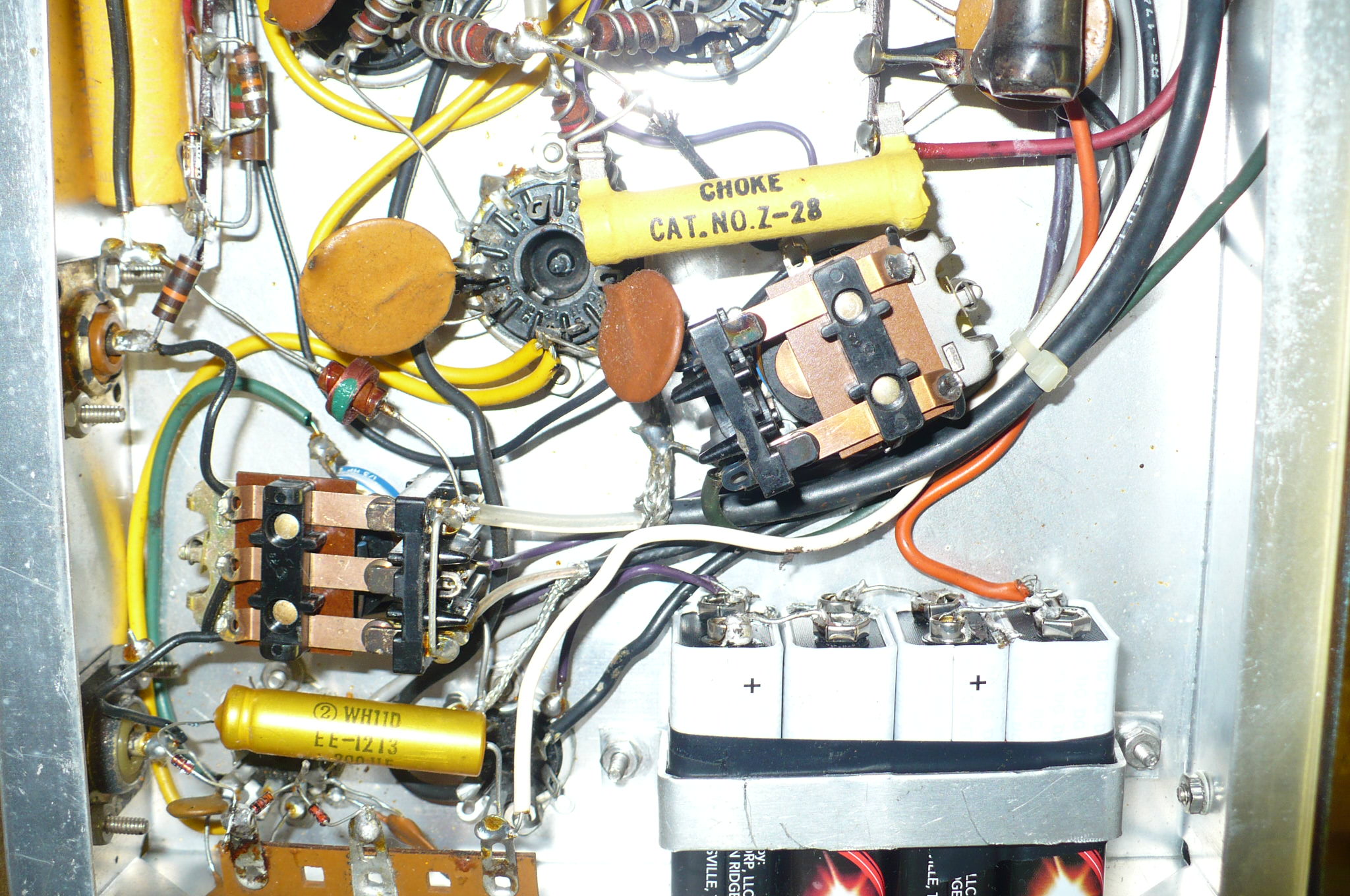

I have had a amp brought to me that has 4 9volt batteries wired in a series in it has anyone seen this before and what do they do? They are bad so I am going to replace them and see if amp works. Here is a picture of bottom with batteries. Thanks jimbo165

The only thing that comes to mind is that the batteries are a work-around for one of the tube voltages.
RX cut-off bias maybe? No idea why the batteries. The batteries would not be able to power the filaments at all due to current and 36 volts is not high enough for the plates although there were tubes made that would run with 12 volts on the plates. I know it has SO-239 jacks on it but it does not really look like it was meant for RF. Audio maybe? What kind of tubes are in it and can we see more pictures of the other side?

Think you hit the nail on the head. This I have seen before. Most likely an add on circuit.
Looks like too many hands have been inside this amp. The batteries were probably installed because there was no negative bias supply in the amp. The amp is grid driven but bias is applied through the cathode. Notice the three yellow cathode bypass caps on a pins 2? They have all been arced over with black marks on them because the cathode was allowed to float well below DC ground when someone connected the purple bias wire to pin 1 rather than pin 2.
The batteries are not needed here and do not have a low enough internal impedance to stabilize the bias voltage anyhow. The zener or a zener with a transistor buffer is a much better way to establish cathode bias here. Bad news is if the voltage on pins 2 was enough to arc the caps, it could have easily damaged the tubes too.

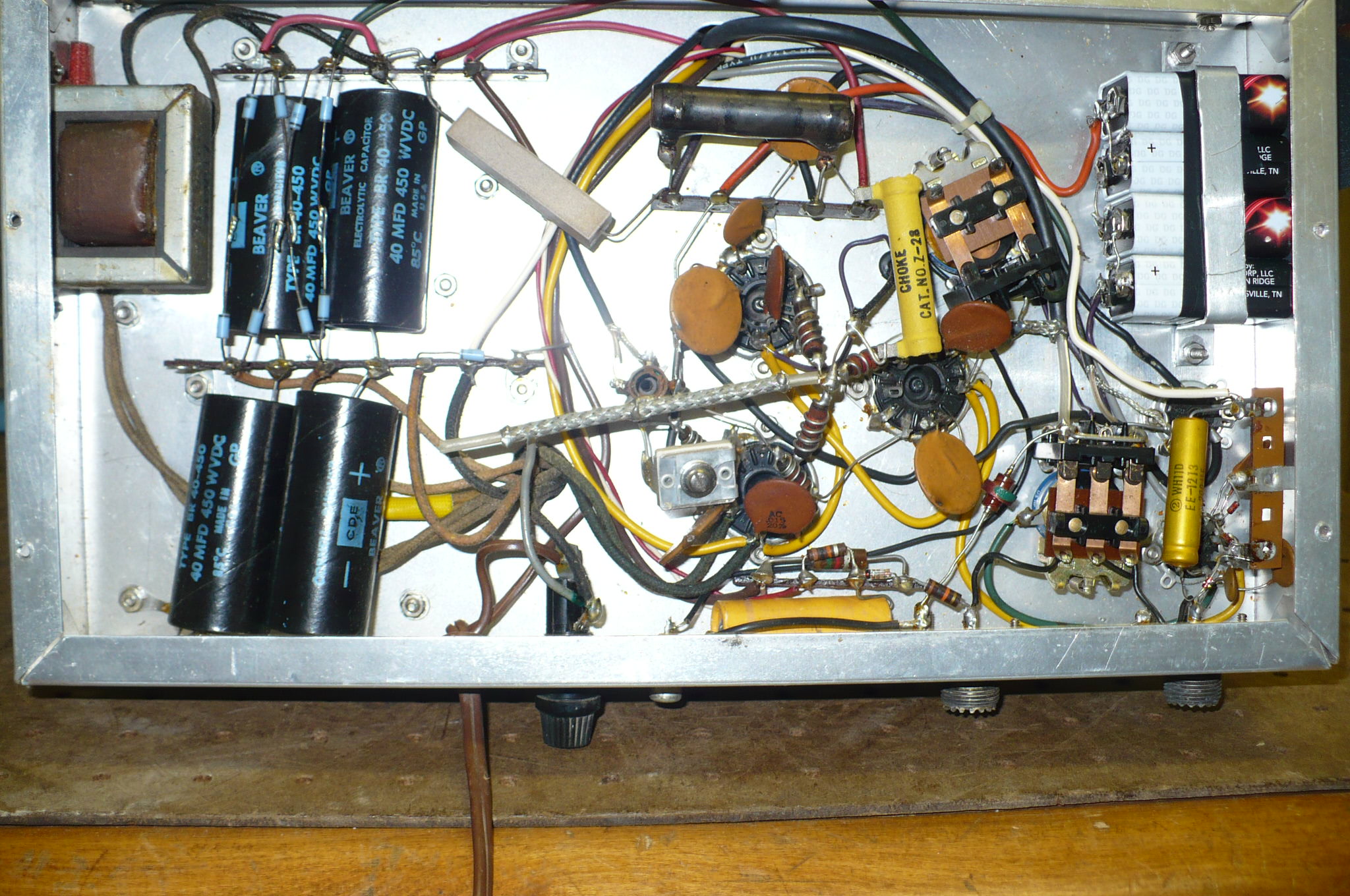

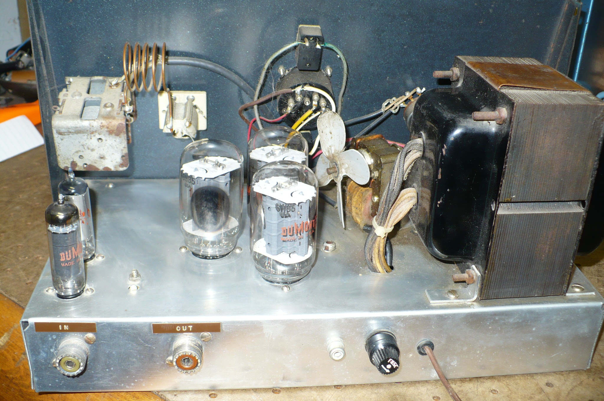

Here are some more pictures of amplifier the large tubes are 6HB5 I have not installed new batteries yet looking at comments on forum first. Thanks to all for their input. Jimbo165
