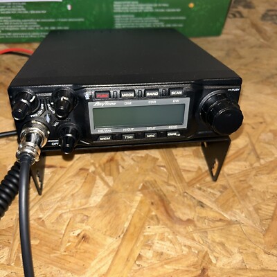

Unfortunately, I ran across another person with a Q6pro that has the same "issue" that I do. He is selling his on ebay because of it. That makes 2 people with the same "issue" that I know of.
I just disable my SWR protect and I can still use mine at full SSB output - I just can't use the built-in SWR meter on SSB.
This is going into a Dummy load. If SWR protect is enabled, radio shuts down TX above a certain power level. Full power AM/FM show a 1.0 SWR.
I think a component voltage rating is/has been exceeded in the SSB SWR circuit.

Thanks for the info. That is an interesting one. What does the LCD report as the SWR value when this occurs? Does the displayed SWR peak higher than it should with modulation, and drop again without modulation, or does it "hang" (maybe indicating self oscillation).
Also, can you try a different dummy load / different test setup (coax, meter, load, etc)? Common mode current could cause this to occur, especially on SSB due to the larger, faster variations in power output compared to AM/FM modes. But it's definitely not "normal!".
I assume this is happening on an antenna, separate to your test setup as well?
(ps - it's up to you, but I would prefer to keep all of the info here to keep the info in the one place).
