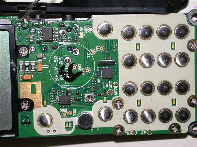

First, thanks for the forum!
I can confirm that the Kenwood PG-4P cable works and yes, I did have to shove it in pretty hard to get it to work.
And for inquiring minds here is a pic of of the innards. I have a few more closer, higher rez views if anyone is interested.
Hi kazak. What are the two wires on top right corner soldered to the board ?
