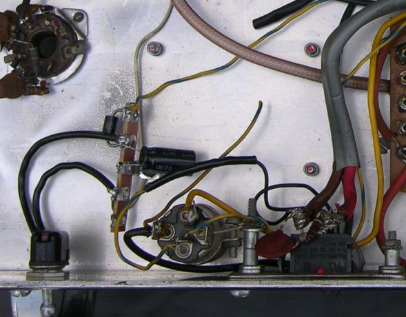

JB2000. Wasn't stored well. Brings to mind the old wisdom "just because you can doesn't mean you should".
But the HV winding on the transformer passed the leakage/breakdown test, and the owner wants it fixed. Several decades of experience working for this guy makes me confident he is serious. Besides, he'll come up with tubes. This one has a bum tube that won't light the filament.
And it's crusty.

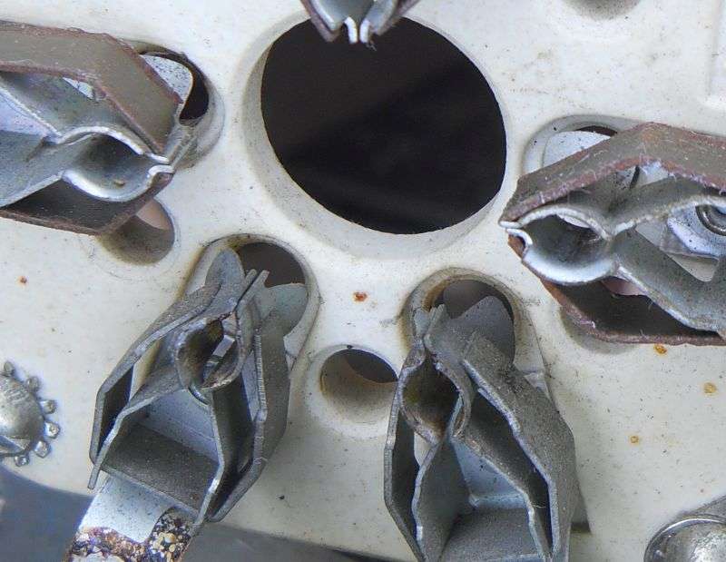

This tube socket is grungy enough the heat from the poor connection is probably what melted the solder from the bad tube's filament pin.
Just don't plug a good tube into a socket that looks like this. It won't be good for long.
Bit by bit the question comes to mind "How many boats did you anchor with this amplifier?"
But wait: There's more.

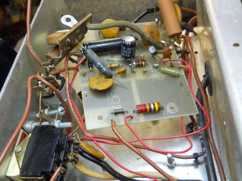

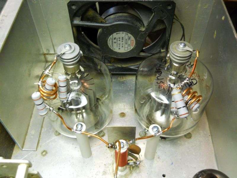

The owner thought this was a low-drive JB. Someone had added a second 8417 driver tube alongside the original socket. But it wasn't hooked up. The drive had been routed directly to the cathodes of the 3-500Z tubes. And the old low-drive input circuit was gone. A big relief, that. Every one of this model we have fixed for decades has been converted to high (direct) drive to the big tubes. The built-in driver is just a bad idea. Never mind why. How do I count the ways?
So the old driver-tube circuit board goes away.

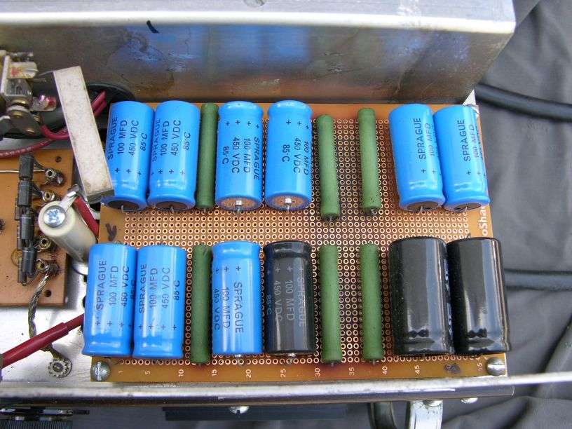

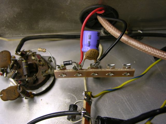

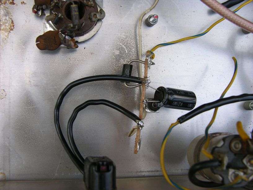

The 12 Volts DC for the antenna relay will come from a rectifier and filter mounted on a tie strip. The keying circuit will be bolted to the rear panel alongside the relay. Not sufficiently interesting to merit a pic.

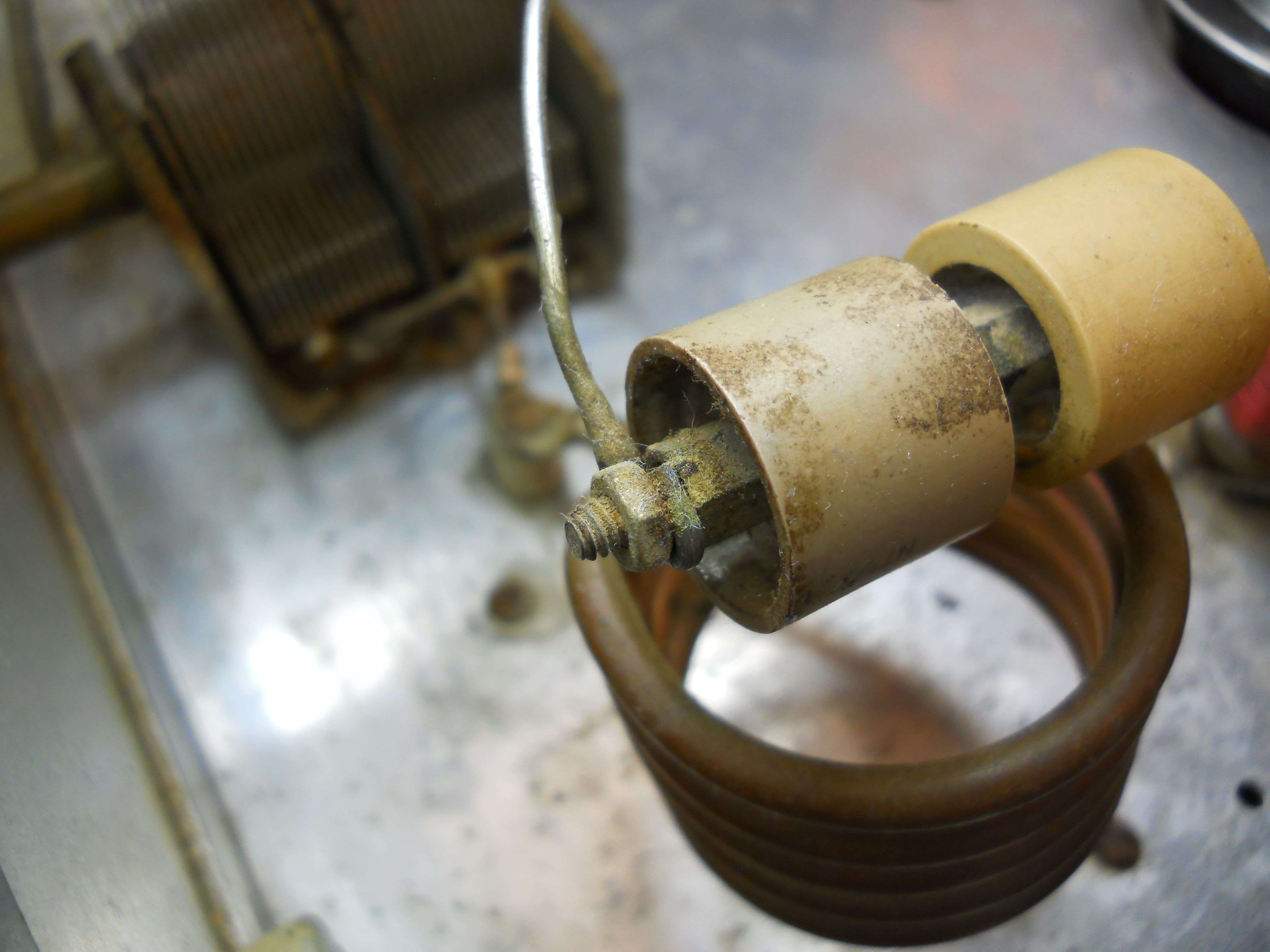

Air conditioner coil cleaner is mostly phosphoric acid, water and blue dye. But soaking the plate caps in it, and a stainless-wire brush got them presentable again.
The tubes get a tuned input circuit. The coil is wound on a half-inch form, 68pf to ground on the input side, 27pf to ground on the tube side. The tiny glimpse of green at the bottom of the pic is our diode-bias board, but with only 25 diodes in series. This amplifier runs on 2500 Volts to the plates, so we could use the same HV board that puts a full-wave doubler into a Pride. Not interesting enough for a pic.

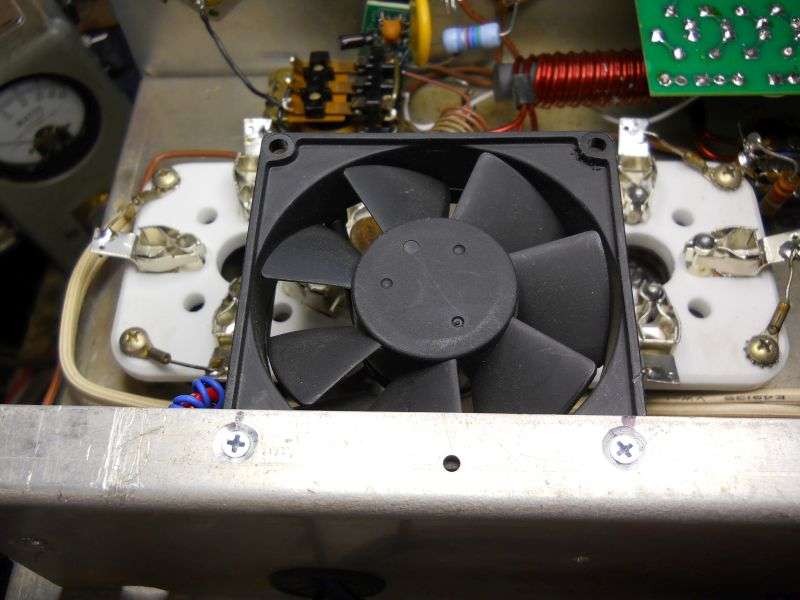

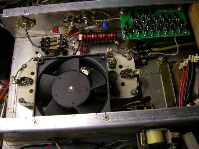

The new tube sockets will last longer with a breeze on the undersides. Doesn't take much. This fan runs from the 12 Volts DC that powers the relay.

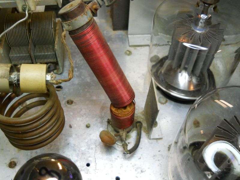

The new plate choke is one we make for the Heath SB220, Pride DX300 and others. But it's a bit short compared to the original. The solution is to take two of the ceramic pillars we use to make the choke and anchor the long parasitic-choke leads separately from the choke's connections. Should be more durable when tubes get changed. If I had anchored each parasitic directly to the top of the plate choke, the leverage would have destroyed it before long.
This sure seems like a long post, but I left out a lot. And yes, I did get paid for this job. Anyone who has done this sort of work will have horror stories of orphaned jobs that had good money spent to finish them and never got taken home.
But if you bring me one of these that looks like this one I'll probably make the Dracula sign and tell you not to bother.

What do you use to clean the tube sockets ?? Or ... do you just replace them. I've been using TARN-X that I've reduced about 50% or so. 100% is too tough on the plating.
- 399
Chris -
- 399
Wear gloves. Tarn-x is one of those things that everyone had and everyone thinks is safe, but this one is actually bad to get on you. Some of the ingredients are cancerous, some are bad for your thyroid and iodine uptake, some bad for your swimmers, its quite a coctail of bad stuff.
Its a very useful product though, not trashing tarn-x. Hydrochloric acid, tin and thiourea (tarnx ingredient, can use tarn-x here) makes a solution capable of tinning copper boards!!
Reactions: unit_399
Agree 100%. Half of the text on the TARN-X label is disclaimers and warnings. Stuff is really strong. Still cleans almost as well even when reduced 50-50 with distilled water, but no damage when soaking items a little too long.
- 399
Reactions: brandon7861
We use CRC brand "QD" cleaner, or 99% isopropyl. The sockets got replaced in this amplifier. Plating on the socket contacts is thin, and excess heat just removes it. No amount of cleaning will put it back. Fortunately the sockets are still made in China.

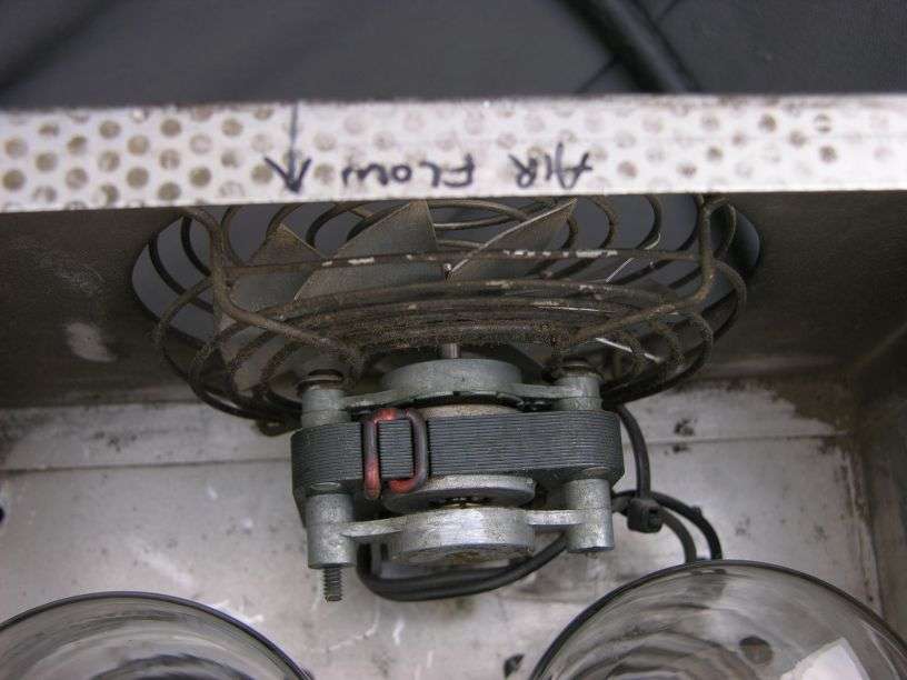

First issue will be cooling air. The original fan sucked hot air out the back of the unit. This will never put enough air onto the glass tube envelopes. The fan must be modified or replaced to blow inwards. Below the deck, there was never any airflow to speak of. That's what makes this one famous for melting the solder from the tubes' pins. This also ruins the sockets before long. Put a good tube into a damaged socket, and the solder will melt out of the pins even after you have installed a fan underneath. The airflow problem has two parts, upstairs AND downstairs. And if the socket contacts look dark or burned, (especially the two filament pins) you need new sockets, too. Good news is that chinese suppliers on fleabay are really cheap. Bad news is you'll wait a couple of weeks or more for them to arrive from China.

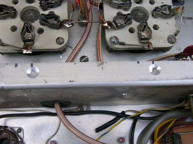

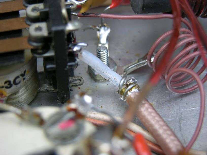

The output coax that runs from the Load control to the relay should get updated with teflon coax. If your output coax looks good, maybe you don't need to replace it. The teflon coax with a roughly quarter-inch outside diameter is plenty large enough. The "thin" stuff that is about one-eighth inch thick probably is not.
The original RG-58 coax in this unit had been resoldered and molested a few times. It was just too ragged to trust.
Just make sure the shield is grounded at BOTH ends. Don't use a ground lug that's held under a ceramic pilar. It can't be trusted to stay tight. If necessary, drill a new hole and use a ground lug with lockwasher teeth. These will penetrate the surface of the aluminum plate and make good contact with the metal under the surface patina.
The fan was already turned around in this one, didn't have to mess with it.

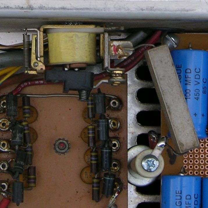

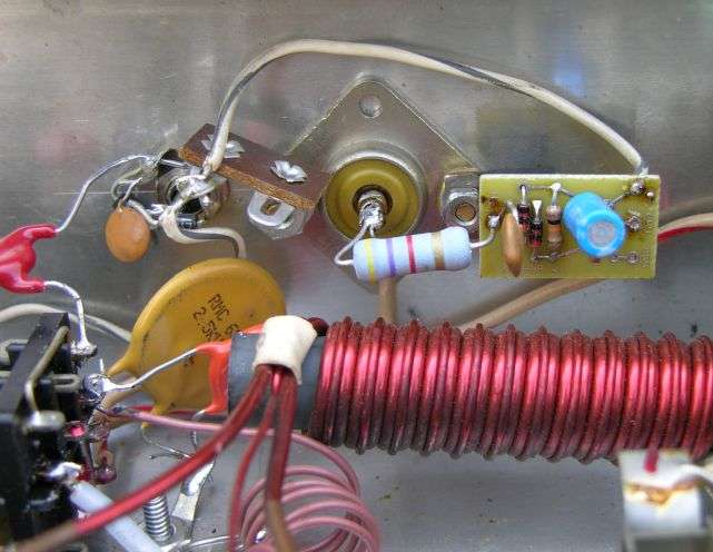

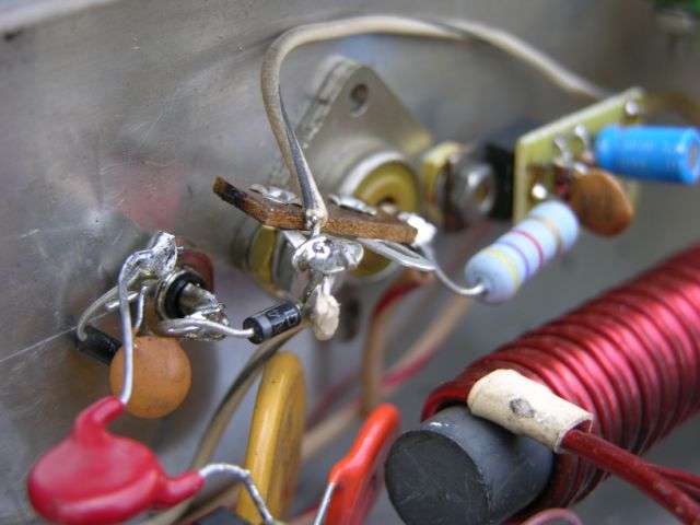

The original RF-sensing circuit was on the small pc board next to the driver tube. Make a note of which wire was attached to the rectifier diode that fed 12 Volts DC to the keying circuit. Mark it when the old driver board is removed. This wire will go to a new rectifier and filter. The old High/Low switch is the ideal choice to use as a standby switch.

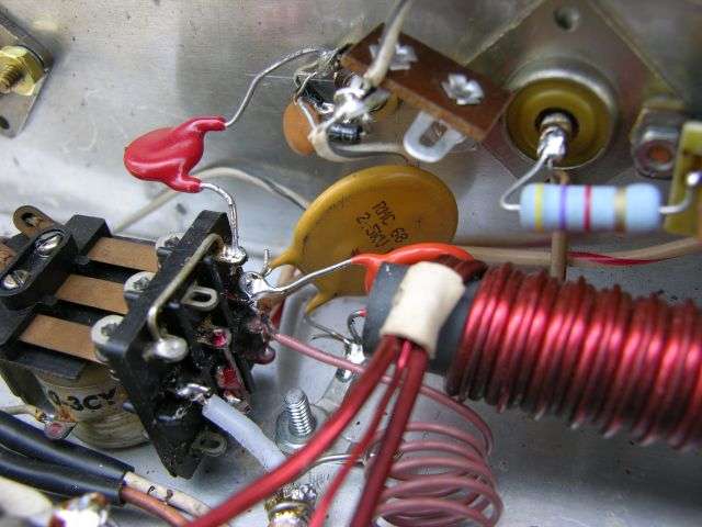

The coil of the main relay had two long wires on it that led to the old driver pc board. One of them goes to the new standby switch. The other one will go to a single tie-strip lug next to the RCA jack. The hole left where the original carrier-level control was mounted will serve for the new keying jack.
The jack has a disc capcitor from the center pin to ground, so RF won't sneak out the keying cable. A rectifier diode is in parallel with this disc cap, unbanded end (anode) to ground, the cathode to the jack's center pin. A second diode goes from the center pin of the jack to the single tie point. Cathode (band) to the RCA socket center pin, anode (no band) to the tie point. These diodes serve to protect the relay and keying circuit from accidental voltages. If you plug the wrong jumper into this socket, these two diodes will protect the new keying circuit, relay and its supply from damage. The collector of the new PNP keying transistor is grounded by bolting it to one side of the radio jack.
A word about the red disc capacitor. It's a 47pf disc soldered to the bypass jumper wire on the relay. The other end is grounded. This serves to reduce the "bump" in SWR that the radio will see when the JB is put in line. All the unshielded wire that carries your barefoot signal from the radio jack to the antenna jack will cause the radio to "see" a higher SWR than you would with a barrel connector in place of the amplifier. This capacitor serves to reduce this down to about 1.2. We use a cap rated for 2.5 kV, but 1000 Volts is probably okay.

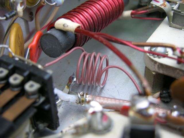

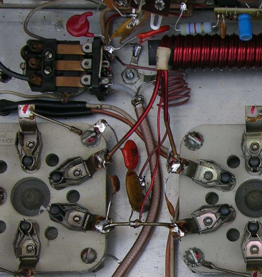

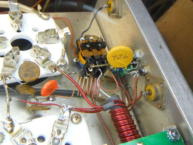

It's probably time to discuss the input matching. The skinny coax that used to feed the radio's drive power up front to the driver tube has been removed, along with most of the other driver components. The normally-open lug on the relay's input side now gets one end of a coil soldered to it. A capacitor with about 95 pf of capacitance also goes from this lug to ground. We used a 27pf(orange) and a 68pf(yellow) cap in parallel here.
The coil extends from the relay's NO input lug to the disc cap that feeds the tube cathodes. It's on a short ceramic pillar on the deck between the tube sockets. Unfortunately I didn't get a good pic of that. You'll have to take my word for it. Six turns of insulated #20 wire a half-inch diameter worked for this unit.
This isn't such a clear image, it's cropped from a wide shot, but you get the idea. You can barely see one more of the orange 27 pf disc caps from the tube end of the input coil to ground. Again, you may find that a different capacitance value gets the lowest input SWR measured between the radio and the JB's radio socket.

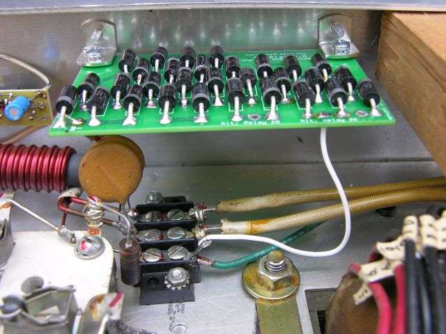

Operating bias can be obtained with a zener diode. Trouble is, zener diodes are prone to fail from surge stresses, and big ones aren't cheap. But 1N5402 rectifier diodes ARE cheap and plentiful. We use 26 of them in series for this model, installed on a pc board (we have them for sale, BTW). A piece of perfboard from RatShack works fine, too. Each diode will behave like a zener, but with only about 2/3 of a Volt each. Put 26 of them in series and you have a 17-Volt zener that's much tougher than a single zener diode could ever be. This will reduce the heat on the tubes from your AM carrier and allow you to run up to about 300 Watts carrier safely. The original instructions tell you 100 Watts, and even that much was pushing it.
The black barrier strip at the center has a wire leading from the front-most lug to the center pole of relay. Take that wire loose and put it onto the cathode (band) end of your series string of rectifier diodes. Add a wire from the anode (no band) end of the string to reach the spot where it was attached before. We added a solder lug under the screw for this. You could just solder the wire directly to the standby resistor where it attaches to the same spot.
There is more than one way to put a fan under the tube sockets. This example works, and there is plenty of room for creativity here. A fan that runs from 120 Volts AC is probably best, since the RF won't 'bleed' it and cause it to stop or slow down. Brushless-DC fans are plentiful and cheap, but if they stall when you key the mike, what was the point? A couple of simple precautions will usually prevent a DC fan from shutting down with RF overload.
The mount holes are countersunk, to use a flat-head screw. This prevents the screw heads from hanging up on the cabinet edge when you reassemble it.

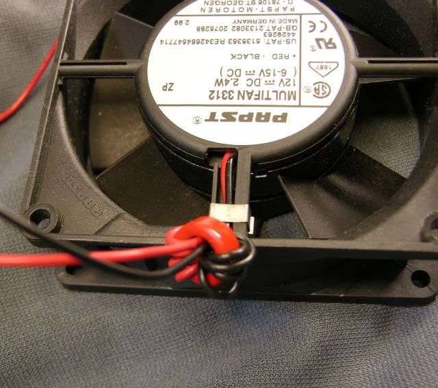

Placing a RF choke on BOTH wires as close to the body of the fan has worked best for us. This one has had the wires wound in opposite directions around a type "2" powdered-iron toroid core. Keeping the fan wires short helps, too. This one is powered by a separate half-wave rectifier and filter cap powered from the 7-Volt AC heater supply on the socket of the old driver tube. We won't get quite 12 Volts DC, but this keeps the fan quiet. Since it's so close to the sockets, reducing the speed won't reduce its effectiveness at keeping the sockets below melting temperatures.
Mounting the fan's supply here keeps the power leads short. Don't leave off the .01uf disc cap across the electrolytic. Might make a difference, might not. It's just cheap insurance.
A 120-Volt AC powered fan can be slowed down to a lower noise level with a 10-Watt resistor in series with it, but that's not how we did this one.

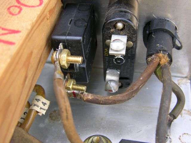

The original circuit breaker for this model is rated at 20 Amps. This is about right to use 120-Volt AC supply. You really should use a 240-Volt outlet to run an amplifier this large. Trouble is, now your breaker is about TWICE the safe size for 240-Volt operation.
Oops.
The new 10-Amp breaker was installed along side the original one, just in case someone wants to hook it back up for 120 Volts later on.

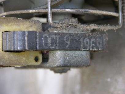

Couldn't get a clear shot of the faded date codes on the tubes, but they both said 1970. Can't imagine the amplifier is much newer than that.

Parts list:
1) 10-Amp circuit breaker like P&B W58XB1A4 or equ.
2) .01uf 500v disc ceramic
1) 95pf disc cap or equivalent parallel values, at least 2000 Volt
(edit) Um, yes we used a pair of 47pf in parallel.
1) 27pf or appropriate value disc cap, at least 2000 Volt
1) 47pf (or so) disc cap, 1000 Volts or more to reduce standby-side SWR
2) 1000uf 25-Volt electrolytic caps. Can probably use 470uf okay
1) 4700pf disc cap, 500 Volts or more. Can use smaller capacitance value.
1) input coil, 6 or 7 turns #20 or so wound on half-inch form. Insulated wire works fine.
4) 1N4001-type rectifiers. Larger 1N5400 types are fine, just clumsier to work with
1) single-lug tie strip for the keying jack
2) 3-lug (or more) tie strips for fan and relay rectifiers/filters
1) chassis-mount RCA socket
2) small 1/4-inch inside-tooth washers for the RCA jack
1) RF-keying circuit if desired. A TIP125, 2 diodes and two capacitors is all we used.
1) Cathode-bias zener made from 26 3-Amp rectifiers in series. You could buy our
board to do this, or just build it on perf board. Works the same.
1) 12-Volt DC fan, body thickness preferably 1 inch or less, diameter preferably
80 mm or more.
1) 250-Volt AC power plug, NEMA type 5-15P or 5-20P. Don't waste your time running it
from a 120-Volt circuit.
