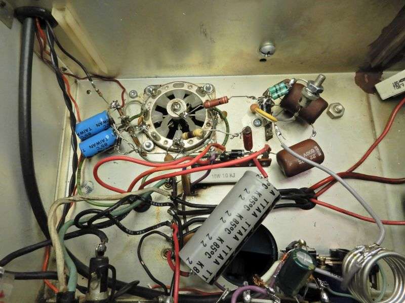

First look underneath prompts the question "Where are all the circuit boards?"

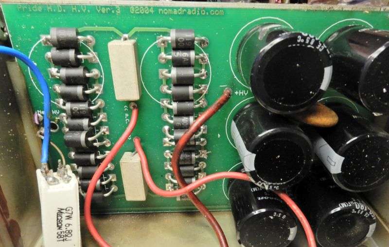

Oh, wait. Here's one, at least.
I'll probably replace it anyway, just because of the 2004 date on it. Got plenty of new ones on hand.

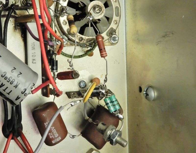

The bias circuit is pretty special. Not adustable. Measured only negative 40 Volts on the tube's grid. Probably the single biggest reason the tube was burned to a crisp. Needs about twice that much to run AM and survive.

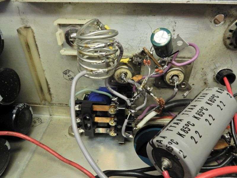

Relay and input-circuit wiring are genuinely artistic.
In all fairness, just because it's ugly doesn't mean it won't work.
