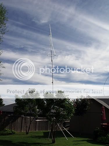

I have the Homebrew Astroplane back up temporarily as I do repairs and upgrades to the tip-over tower. The SWR is still great, and it works a charm.
HOMERBB IS IN THE HOUSEEEEEEEEEE > great job;)
I have the homebrew AP back in the air. The fellow I sold it to for the cost of the materials in it no longer needed it. His son was the recipient of the antenna. The son moved away and was no longer using it. It was given back to me for the price of taking it off the push up pole it was on. It has been in the air through thick and thin for 2-1/2 years now between my place and his, and still registers a very good SWR in spite of being CPVC skinned with aluminum duct tape.
