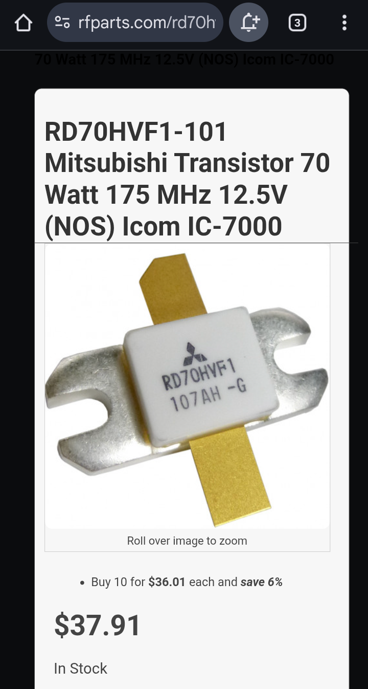

RD70HVF2
(Correct part number)
RF parts sells them for $38 new + ship and are here in the US

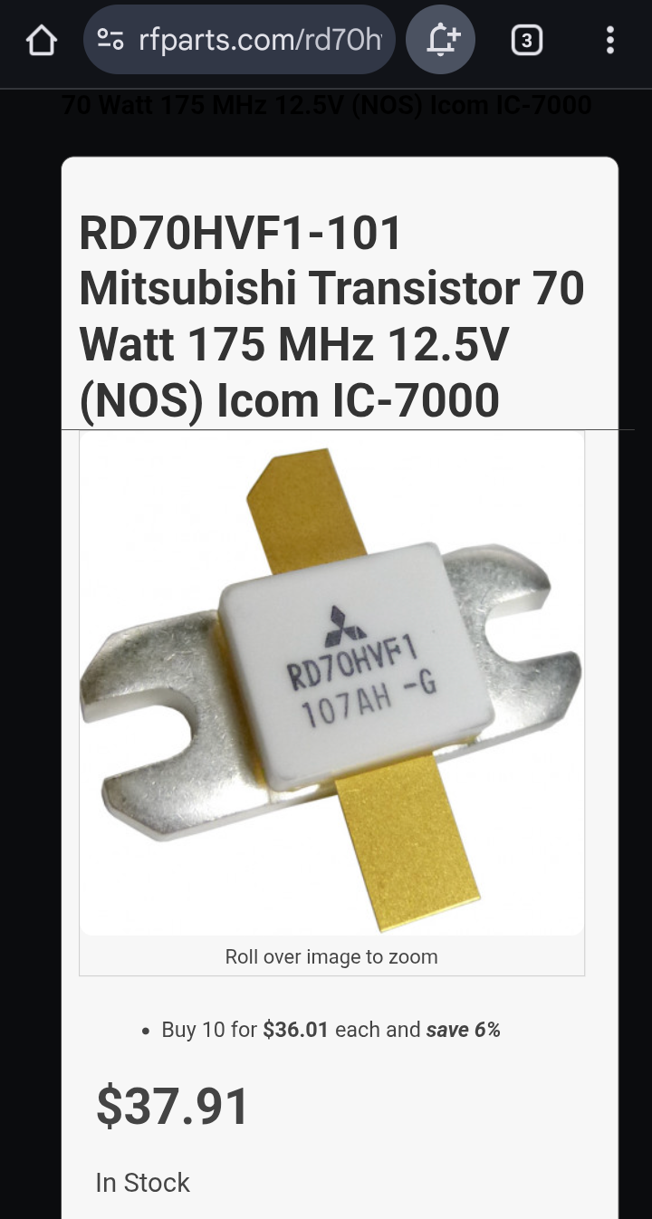

Bingo, that's what I would buy. How much is it worth broken? If you like the radio and plan on using it then might as well fix it with the correct final.

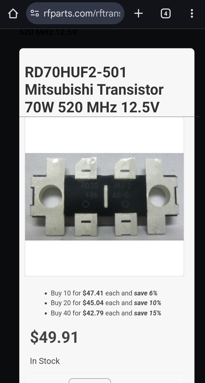

that 1 lots diffrent than mine. it has 3 lugs on each side and looks slimmer and longer. the number i gave shows identical replacement.

You are correct, I went with the V not the U in the part number

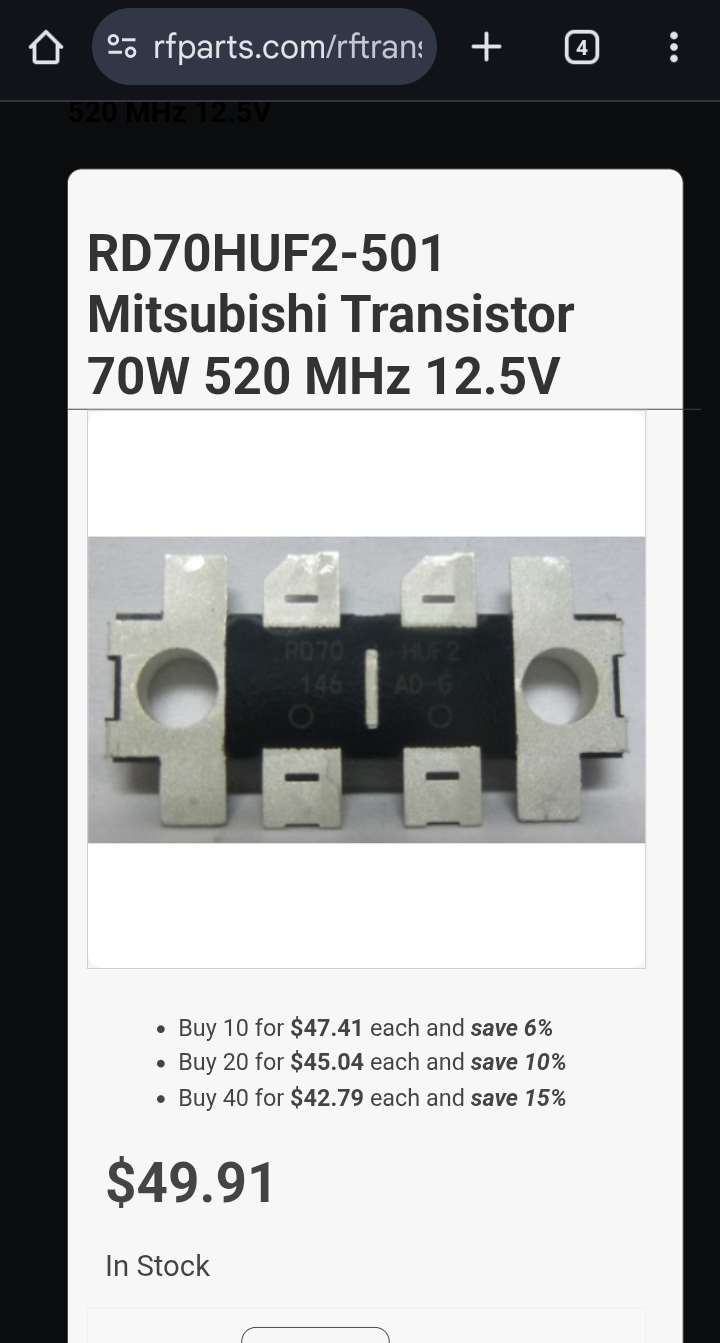

Is indeed a different package
RF parts has them, for $50+ship
