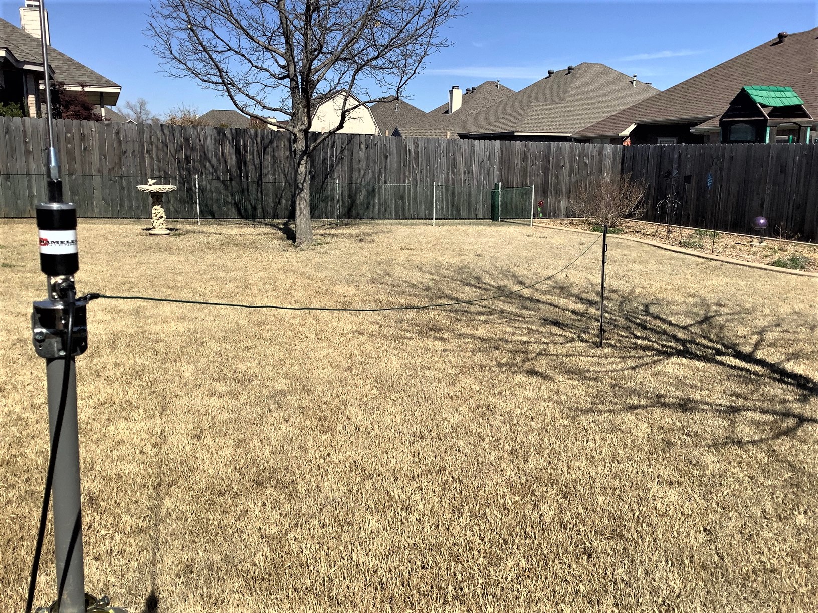

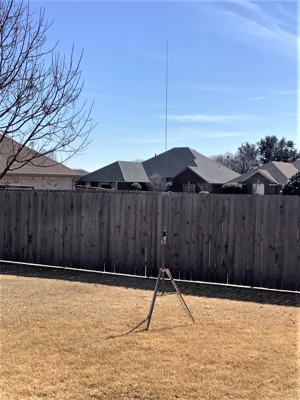

Since I've added a CB to my station, I decided to try something with my antenna. I removed the Chameleon Extension and am using only my 102" steel whip, the Chameleon Hybrid Micro and a single wire radial for counterpoise (16.5').
Am very pleased with the results! (y)
To save some typing, I am only showing the readings at the middle of each band.
2.8 @ 7.200
2.3 @ 14.250
1.5 @ 18.130
1.4 @ 21.300
1.2 @ 24.960
1.0 @ 27.205
1.1 @ 28.400
2.5 @ 50.200
80 Meters is now over 3.0 and out of the range of my internal tuner. But that's okay! The guys on 80 seem to only talk about politics anyway.
Previous readings (before the mod) can be found in Post #13.
All in all, a great day's work! (Actually, just 30 minutes.) :p

Well, the Chameleon Antenna was a good one. But the wire radial strung across the yard was a bother and a hazard.
Its replacement?
A Solarcon A99.
SWR's at middle of each band:
10 Meters - 2.2
11 Meters - 1.15
12 Meters - 2.3
15 Meters - 2.3
17 Meters - 1.3
20 Meters - Way High
Not much on 10, 12 and 15 these days. A little on 17. When the solar cycle gets over its Coronavirus, I'll be good to go. Meanwhile, a lot of local chat and some skip on 11.
Was growing tired of 20 and 40, so not having them is no problem. :D
Have fun, everybody! (y)

All good things must end.
Missed having 20 meters more than I thought I would. The Chameleon lives! Back to using the setup in Post #34.
Am once again amazed how well this thing works. Truly omnidirectional despite having a singe radial. If I can hear them, I can talk to them. And this thing hears like gangbusters.
Over and out. I know everyone is tired of hearing about me bouncing back and forth between radios and antennas. o_O So am I. :D
Stay safe, everybody!
