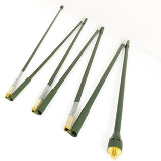

As an interesting alternative, I found (and purchased) this antenna on eBay...
https://www.ebay.com/itm/Radio-Mili...306754?hash=item2f38606e82:g:vAkAAOSwFOldtmEu
It appears to be the same antenna as the Chameleon Mil Whip, which Chameleon sells for $129. There are a few Chinese sellers offering this antenna for $40-50.
Sweet! Thanks for that. Ordering one for experimentation.

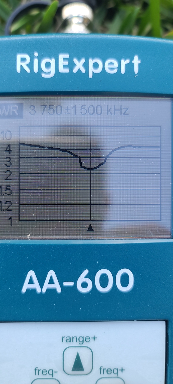

I tried this antenna in the back yard with the Buddipole load coil in between the extension and the whip with a single counterpoise cut for 80m. I didn't have much success getting it resonant on 80m in this configuration. As you can tell from the photo of the analyzer, the best I got is about 2.25:1.
