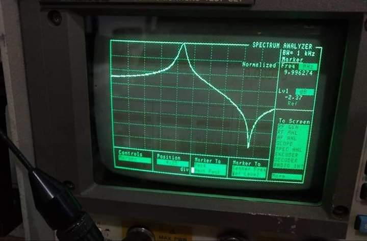

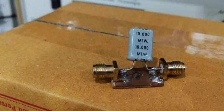

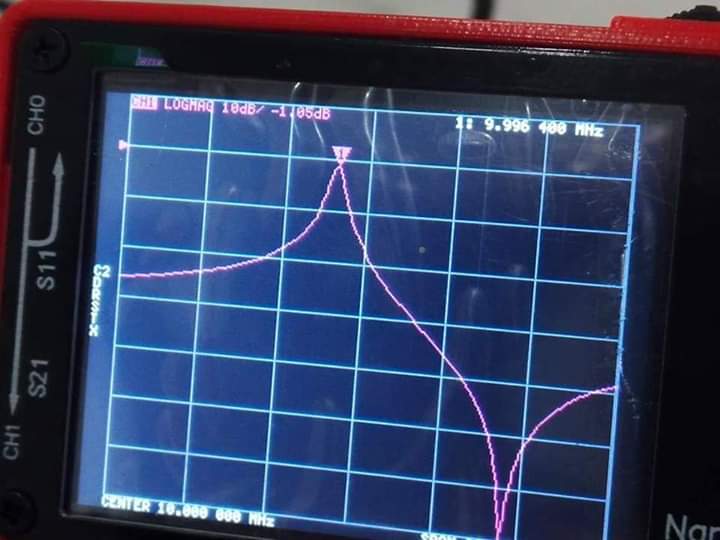

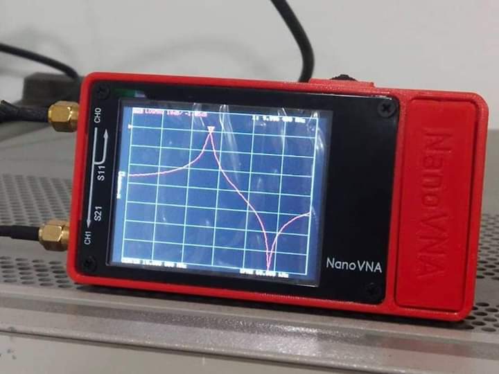

Comparison against HP8921A
Results posted to NanoVNA Facebook Group
Test of Crystal 10mhz HP8921A vs NanoVNA .
HP8921A - 9.996274 MHz
NanoVNA - 9.9964 MHz
