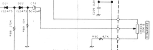

C61 is connected to the junction of D22 & R89
VR6 is the internal mic gain that on the 138XLR and 139XLR has been moved to the front of the radio and called Dynamike. On the 139XLR (base version), because it is a longer run, Cobra used a shielded pair and simply used the 3 holes of VR6 and wired it to the Dynamike pot on the front of the radio.
On the 138XLR, since the runs are shorter, Cobra just used regular wires coming from the Dynamike pot. I don't have a Sams of a 138XLR or a picture of a stock one, but I have no reason to believe it wouldn't follow the schematic.
If you want to restore your Dynamike to match the schematic, then remove the jumper that goes across VR6 and the insulated (red) jumper on the bottom of the board where R90 goes, then restore C78 (50v .47) & R90 (4.7k), make sure your Dynamike pot is a 20K B - linear taper. Solder the middle wire (wiper) from the Dynamike to the hole just below "VR6". The white wire in the photo is covering up the other 2 holes. The wire on the high side of the Dynamike goes to the hole where the jumper is currently (lower right end). And the low side of the Dynamike goes to the hole closest to R90 straight to the left of the high side hole.

@Switch Kit - It isn't normal that the Dynamike is that "touchy". Something has definitely been "modified". For sure the solder side jumper with red insulation. It isn't even functional in it's current state. One side is soldered to ground but nothing is connected to the other side. It's not doing anything. It appears to me that part of the circuit was modified twice. Initially, R90 was jumped. This allows the Dynamike to turn "off" the mic audio rather than just turn "down" the mic audio in schematic form. Later the R90 jumper was bypassed all together. BTW, Cobra used bluish-green sleeving on leads that might short out. Also, all the SB's that I can find for that radio, none of them modify that part of the circuit.
Realistic 858's (449, 457, 458), which don't have an external mic adjustment, have a 20K VR6 installed with the low side going directly to ground.
