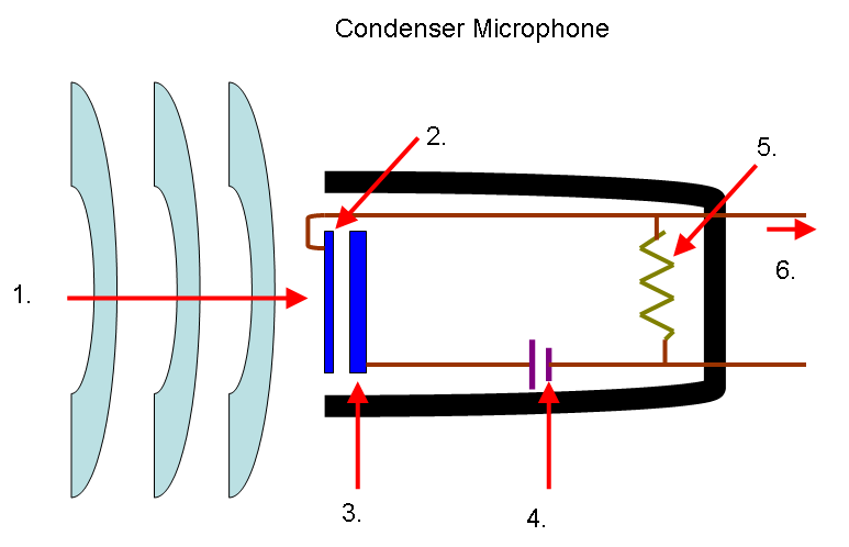

However, condenser mics have a diaphragm that is restricted as well. Be a neat trick if you can charge the diaphragm and turn it into a condenser element.
Sensitive at an arms length away, wide dynamic range, low distortion, and flat response. Better than the OEM xtal element - by far.
Like I said, it would be a neat trick - indeed . . .
Using a 9v battery and a xformer to jump the voltage up to ~50v could be done inside the D-104. Might require more than one battery to supply enough current.

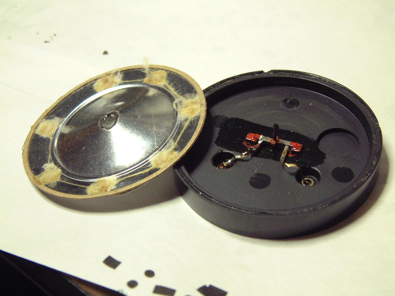

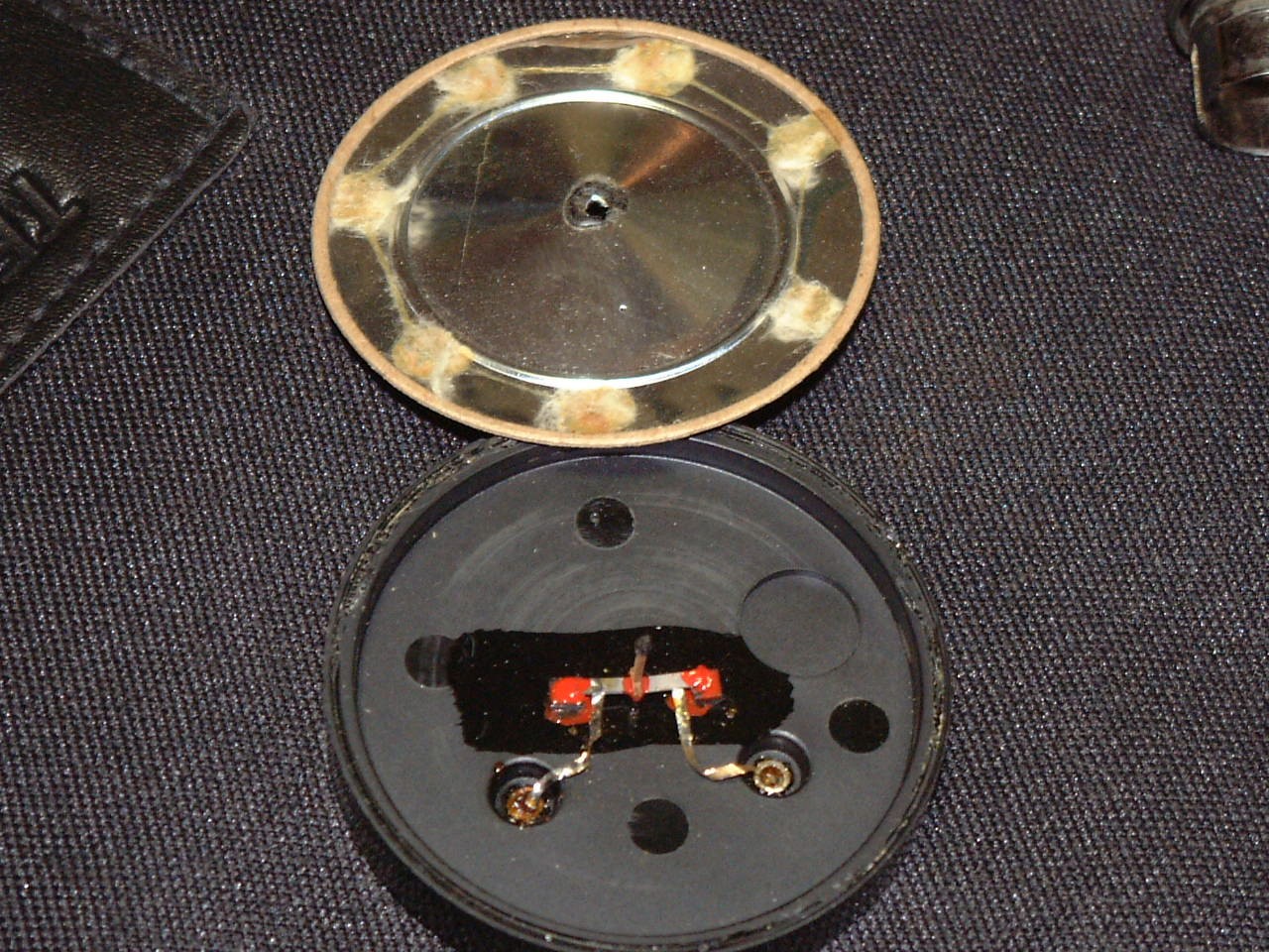

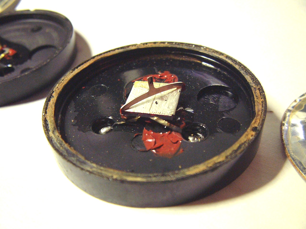

What we found is that the rochelle-salt element is usually just fine. Yes, I know the conventional wisdom is that they deteriorate from years of humidity. The failure we usually find is much more mundane and entirely mechanical in nature, not chemical.
Two weak points in the crystal-element "MC320" cartridge cause it to become weak and tinny sounding.
Using the mike as a 'straight' D104 without amplification makes this deterioration apparent at once.
The amplified version may fool you into thinking the cartridge is okay. The amplifier in the base of the mike has a buttload of gain, and will make up for a weak cartridge, at least for a while. Eventually that "hollow" sound takes over and the condition of the cartridge becomes too poor to ignore.
First, there is a daub of wax at the center of the aluminum diaphragm. It bonds the upside-down "Y" part that is glued to opposite corners of the rectangular crystal element inside. This piece, or "yoke" is made of fairly rigid brass.
The bond to this wax can come loose. Reheating it can fix this problem.
Much more common is failure of the glue that attaches the crystal element to the element's plastic "cup" housing.
The crystal element rests on two tiny blocks of hard rubber. The glue holds these each to one diagonally-opposite corner of the element. Each block is also glued to the inside of the cup. The Y-shaped yoke that links the other two diagonal corners of the element to the diaphragm is arranged to put a maximum twisting motion onto the element.

I'd love to find the alloy used for that aluminum diaphragm, and make a die to form new ones. No way to disassemble a MC320 without destroying the old one.
Pretty sure a bit of the right glue, a new diaphragm and wax would rehab the MC320 cartridge back to original performance.
