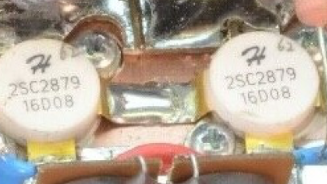

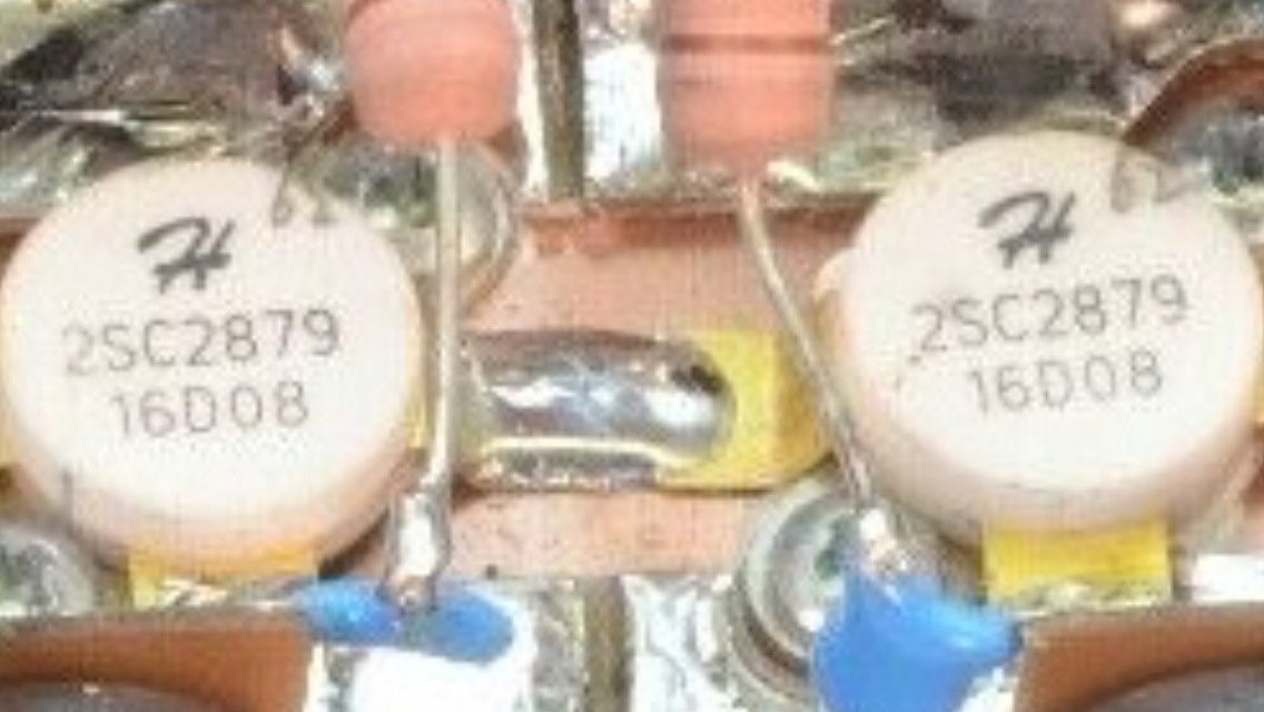

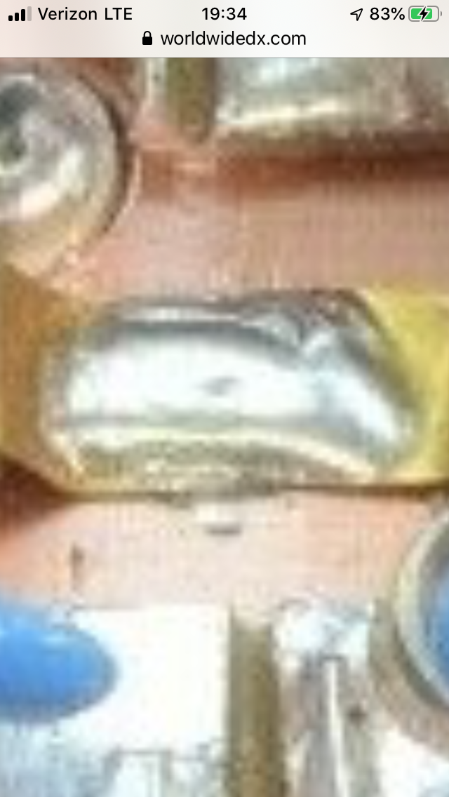

No comments on the solder, lol.
It’s not even wetted to the board.
View attachment 32649 View attachment 32650 View attachment 32651
I have pointed this out in another thread. The most important connections related to amplifier stability are totally compromised by using copper sheet metal which conducts heat so fast that it makes soldering the emitter ground connections nearly impossible. He basically mounted a copper heat spreader on a heatsink and then expected to properly solder to it. Current may even be pulled in series now through other transistors that are grounded.

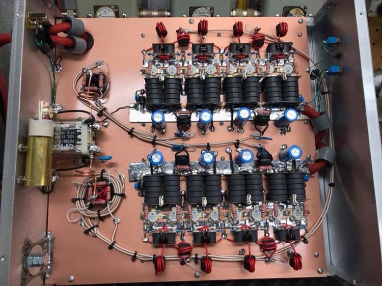

Here is a better pic of his amp View attachment 32670 for you
Notice how much care was taken to insure every picture does not show the center tap of the input transformers, DC ground connection through the RF choke? Almost like he wants you to think it's not soldered to ground and could be connected to a bias line. That's all I was looking for to determine class C but the absence of any other bias wire or circuit in the area insures it is class C and the other end of the choke is soldered to ground.
