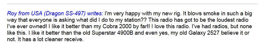

Yeah the reason I'm asking is because I have a Dragon ss497 lined up to buy now, yet I have a Cherokee CBS 1000 I already own. You are correct on the FM/weather radio difference though. But this Dragon ss497 has dual clarifer (fine and corase) for one which is cool. I heard that there are some better made ones of these typically so called they all look alike to throw them all in one pile and consider them the same conclusion situation. For instance some do NOT have the same exact PCB board and actually have better overall recieve and transmit audio so overall better radios, and I'd like own the better of the pack, so I'm trying to determine is all... I read someone also claiming the Dragon one was better than his Cobra 2000gtl and his Galaxy 2527 and I'm attaching a pic of what he said.
Thanks for the reply and maybe someone has more info, can kick in on this, Retro

Since you said that, I can tell you that back in the day my neighbor had a Cobra 2000GTL and a Dragon SS497 and the Dragon was the better of the two.

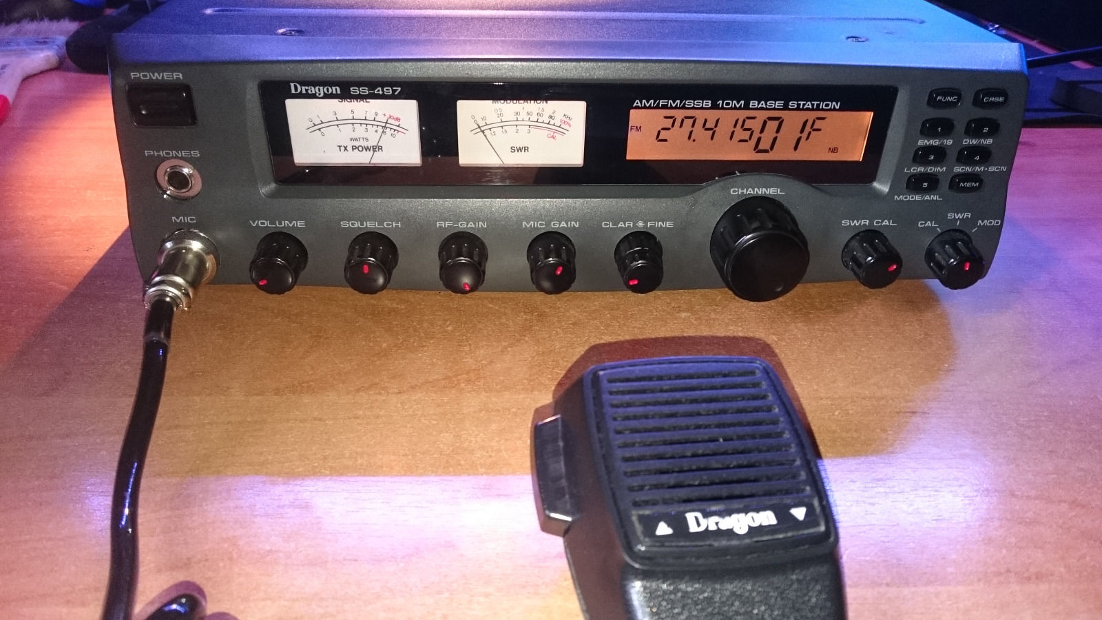

Well I just sent payment to get it bro. Let's hope it is quite nice and holds up to what I've heard and read some. He tells me it has no problems and it's got the channel mod done already. Looks in great shape...
Retro

No channel mods required in that radio. Just press the Ch. 19 button and turn the power on. Hold the button for five seconds and it goes into band selection mode Bands A,B,C,D,E (regular 40 channels) ,F,G,H,I and J IIRC. It covers from about 25.165-29.695 MHz
