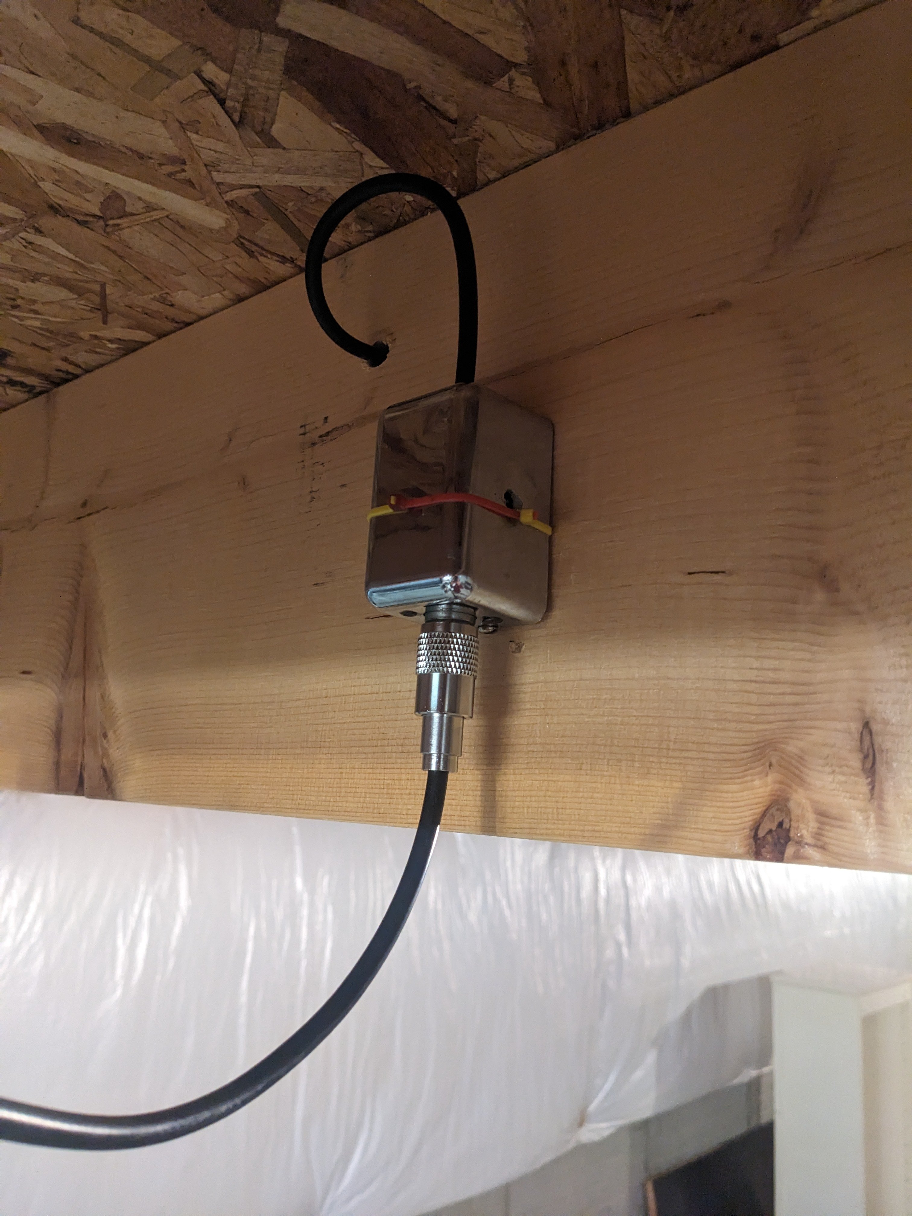

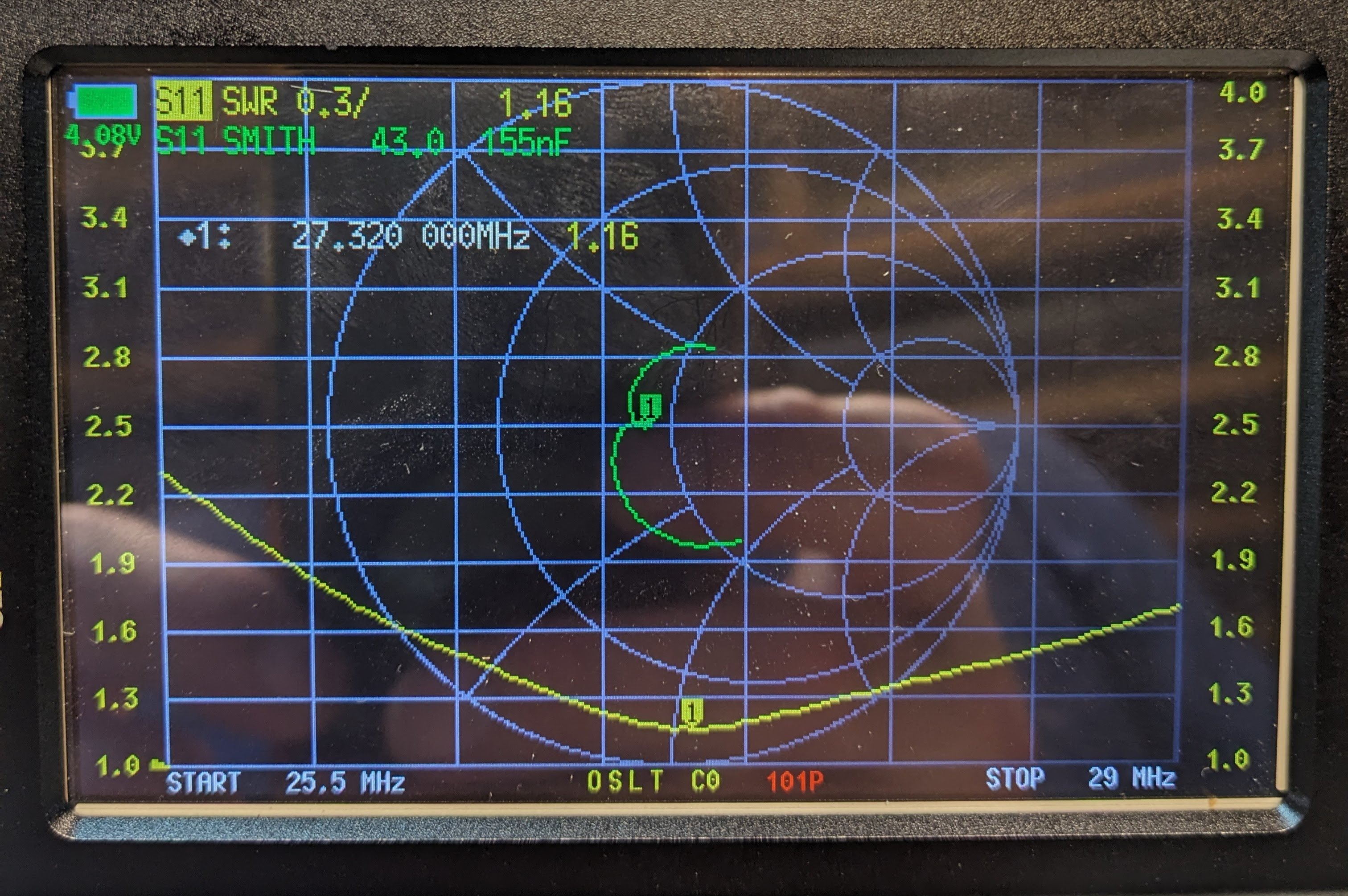

My antenna is an attic dipole with a 1:1 feedpoint choke and great match across the 11m band. When I switch to the antenna vs the dummy load I get a strange oscillation that I found gets better when the carrier is raised on the 350 or the channel frequency is raised on the 250.

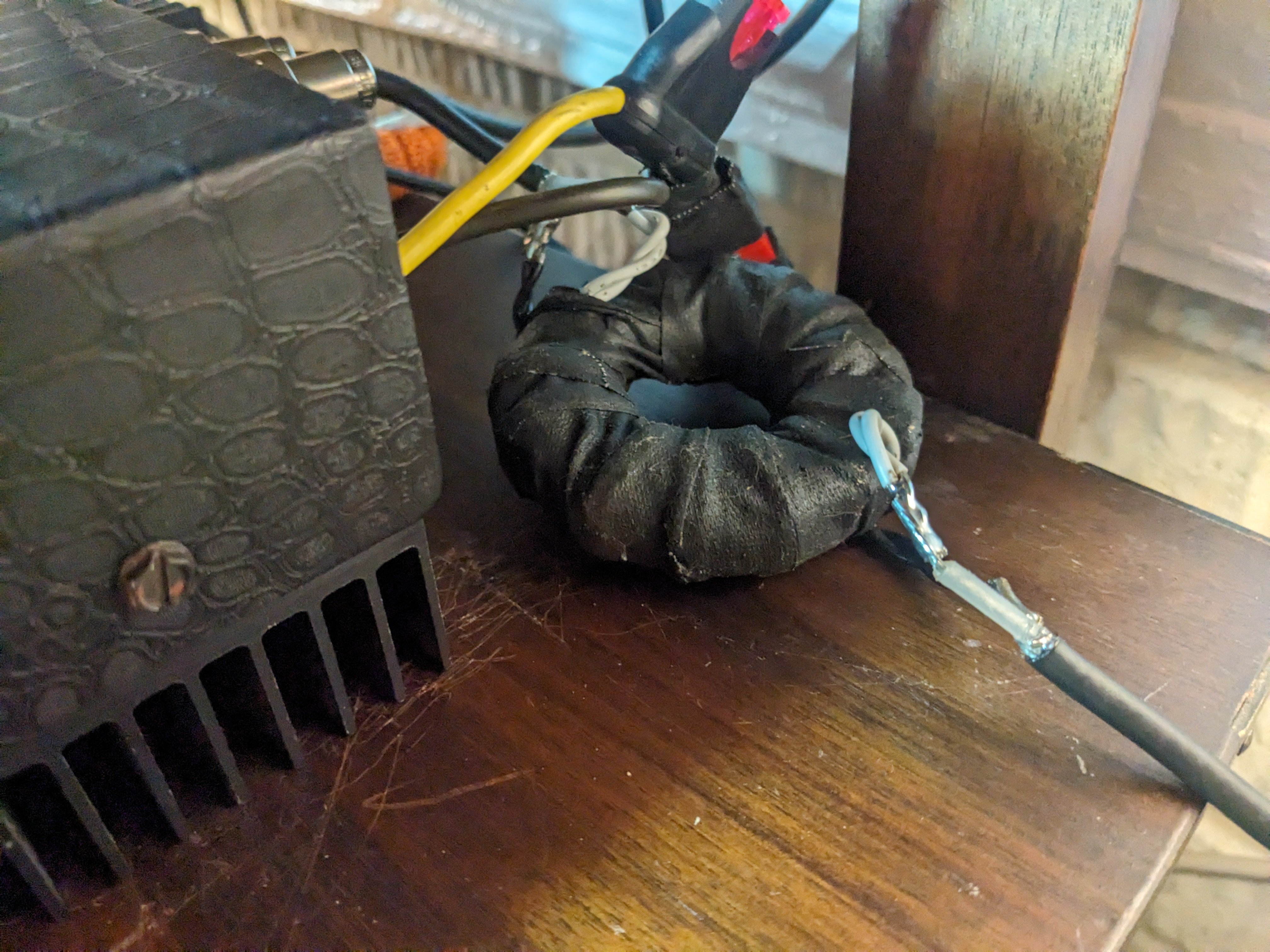

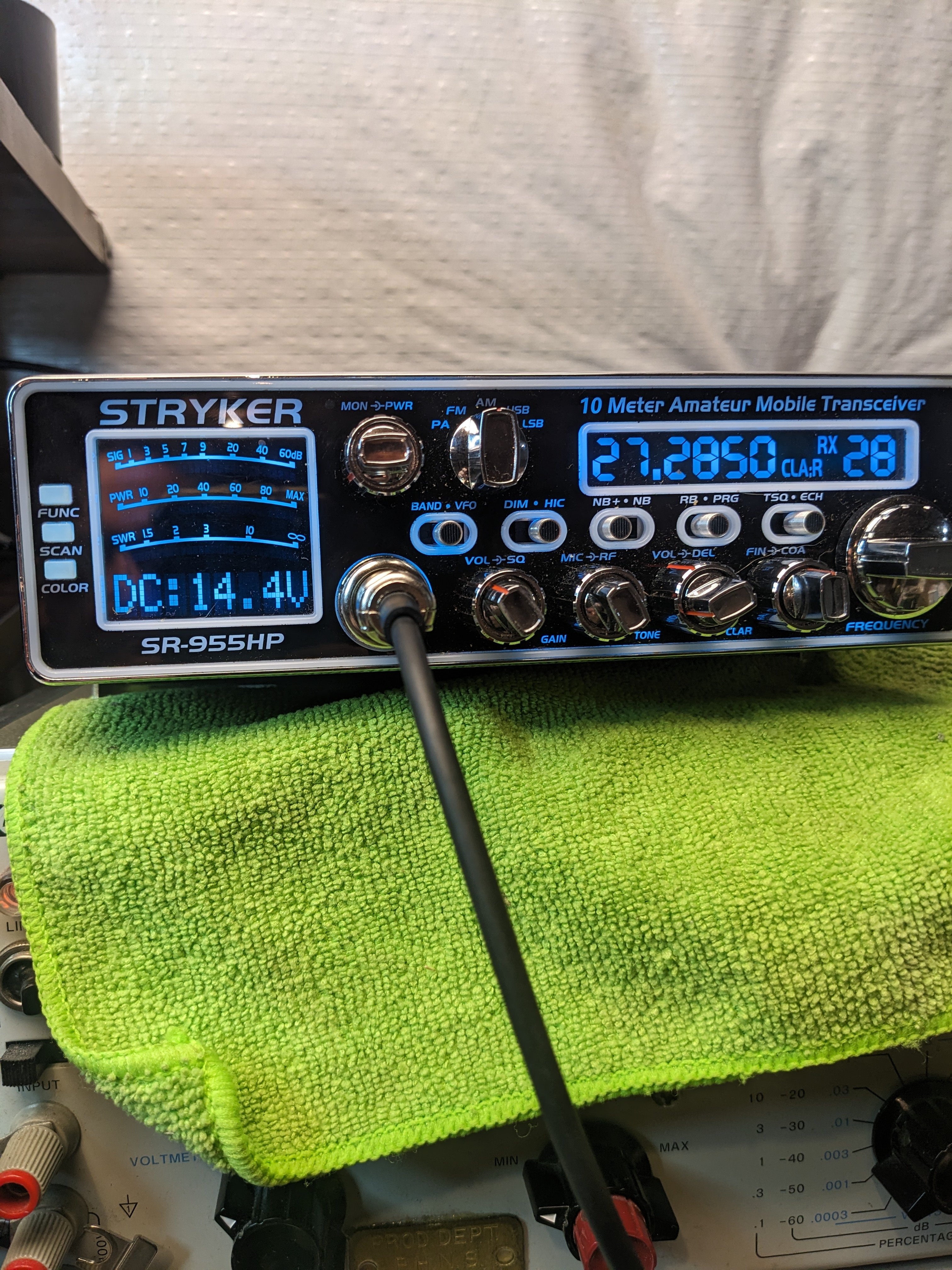

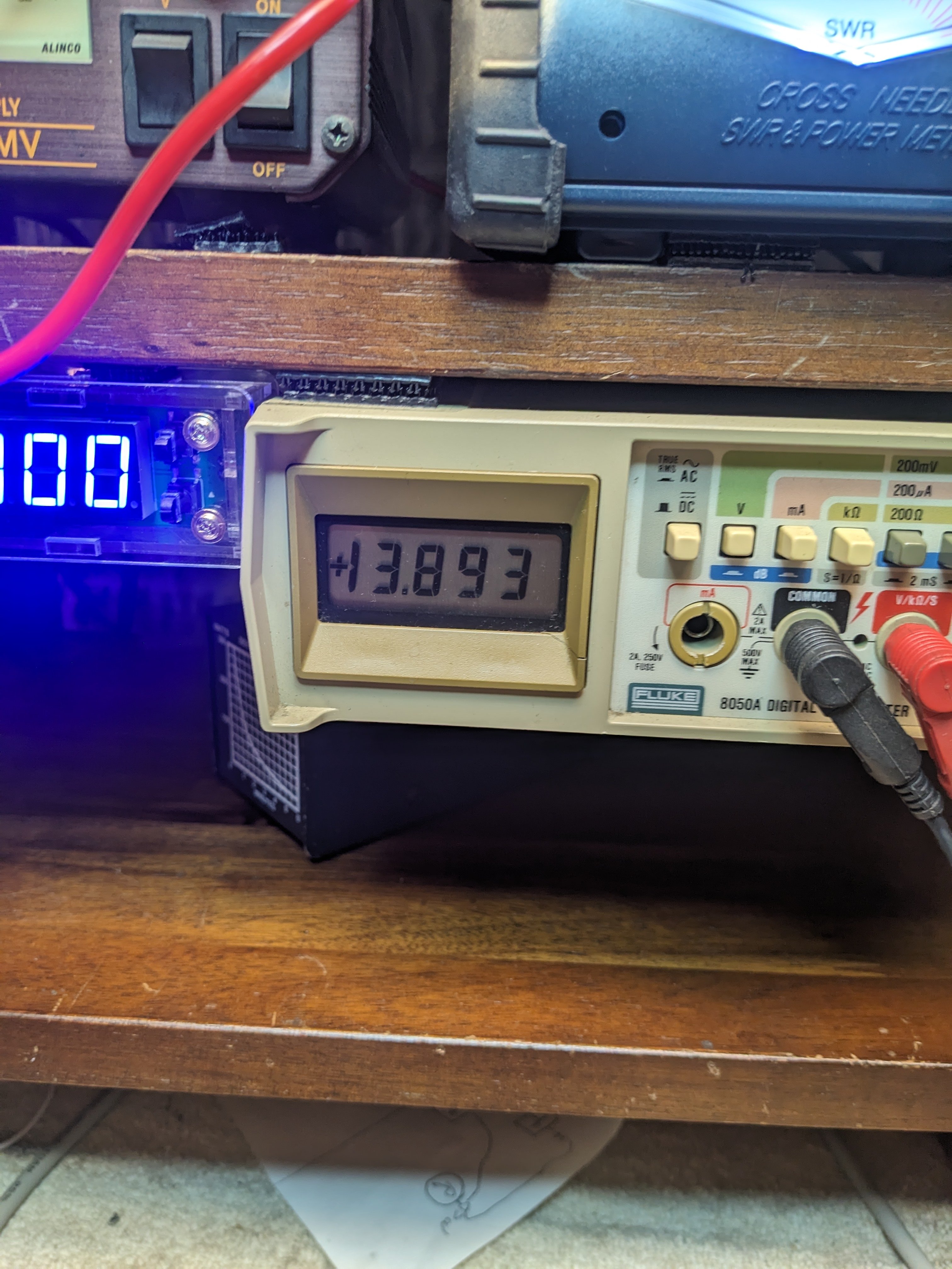

The 1st video is the 350 acting up on the "AM in" setting on the antenna. The 2nd is High on a dummy load. A few more pictures show AMP voltage, Radio voltage and the extra CM choke I rigged up directly behind the amp, and my attic dipole measurments.

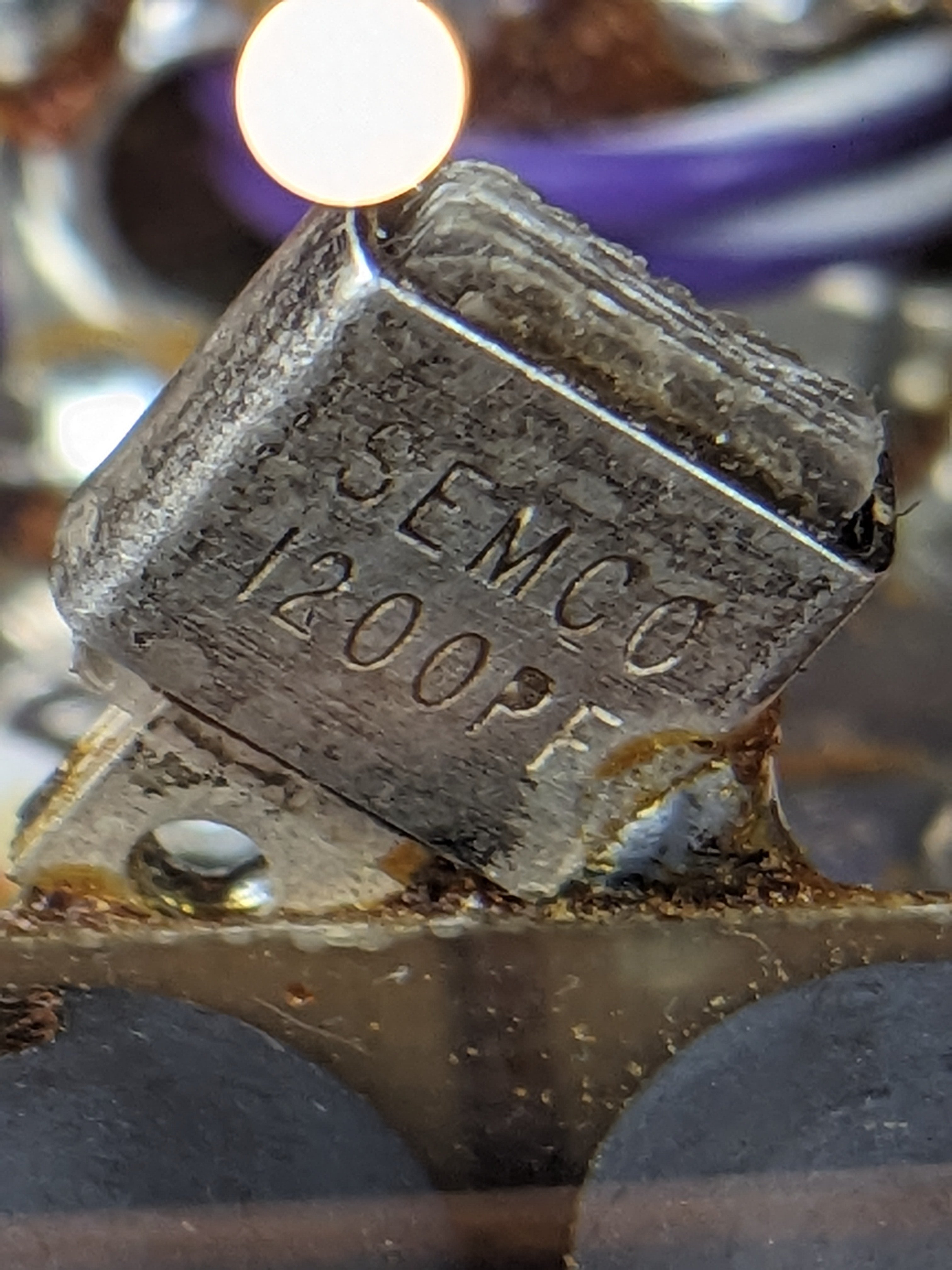

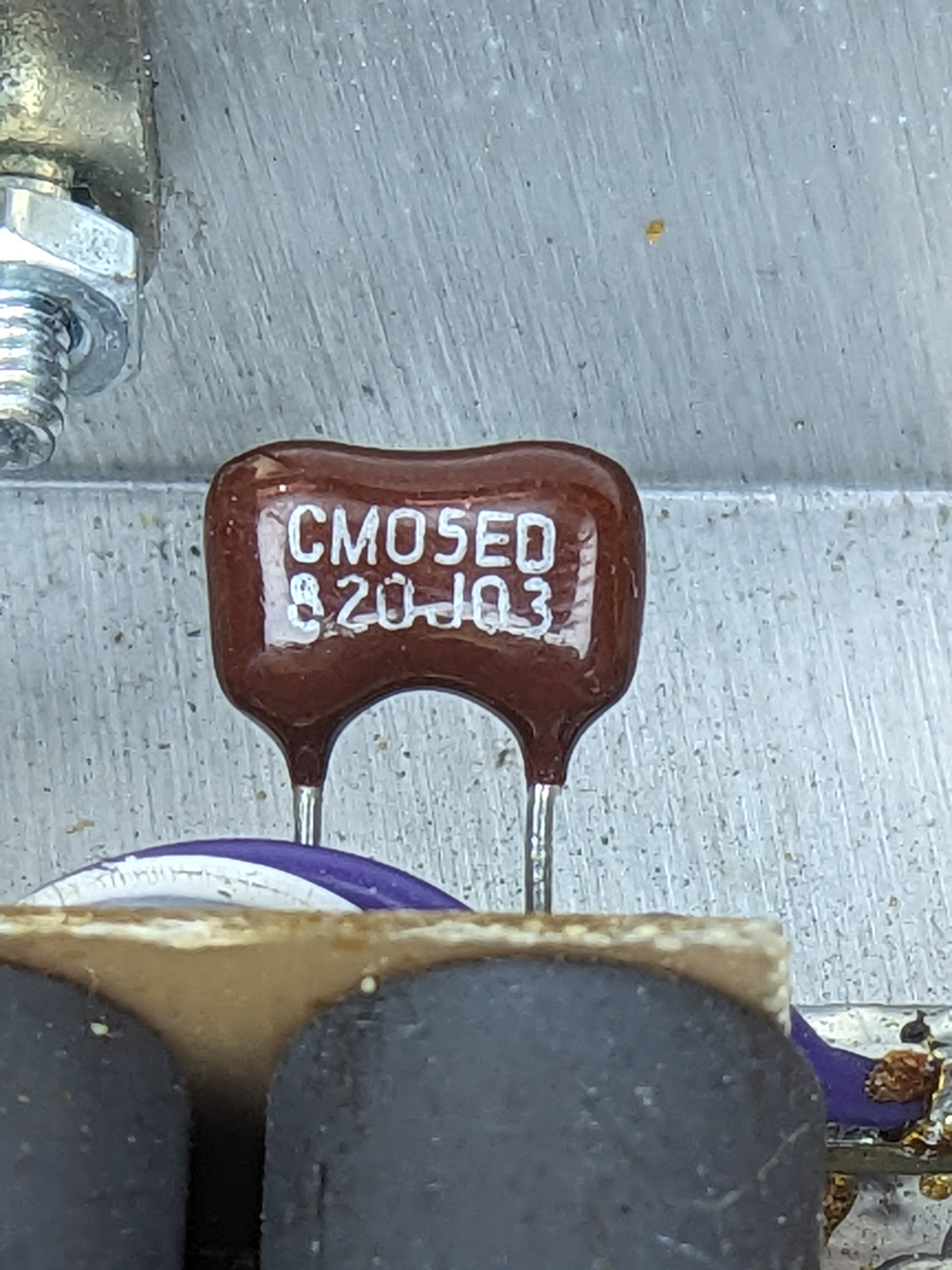

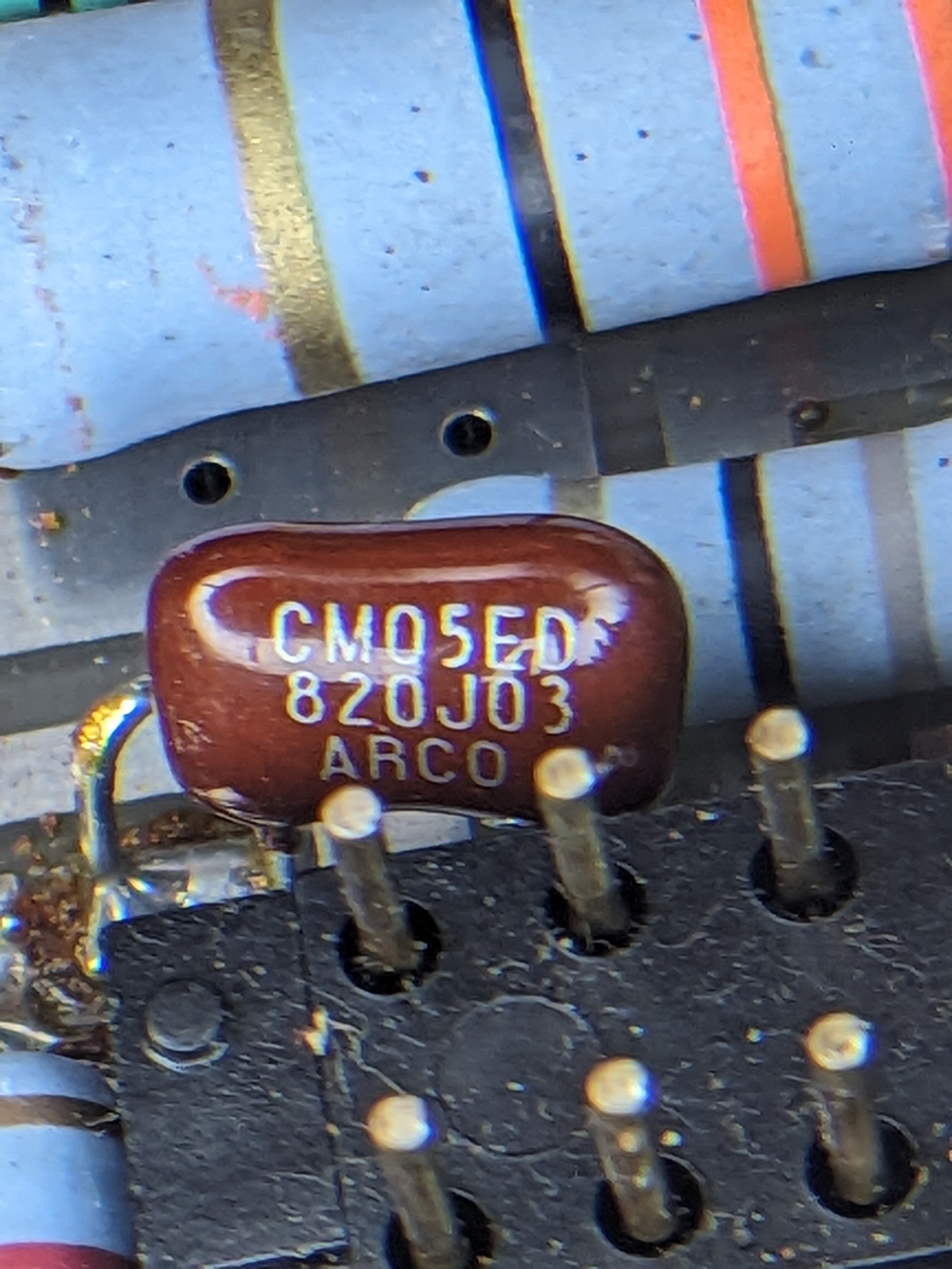

I read somewhere that the metalized mica caps can drift causing issues, coud this be whats up here? What do you think?

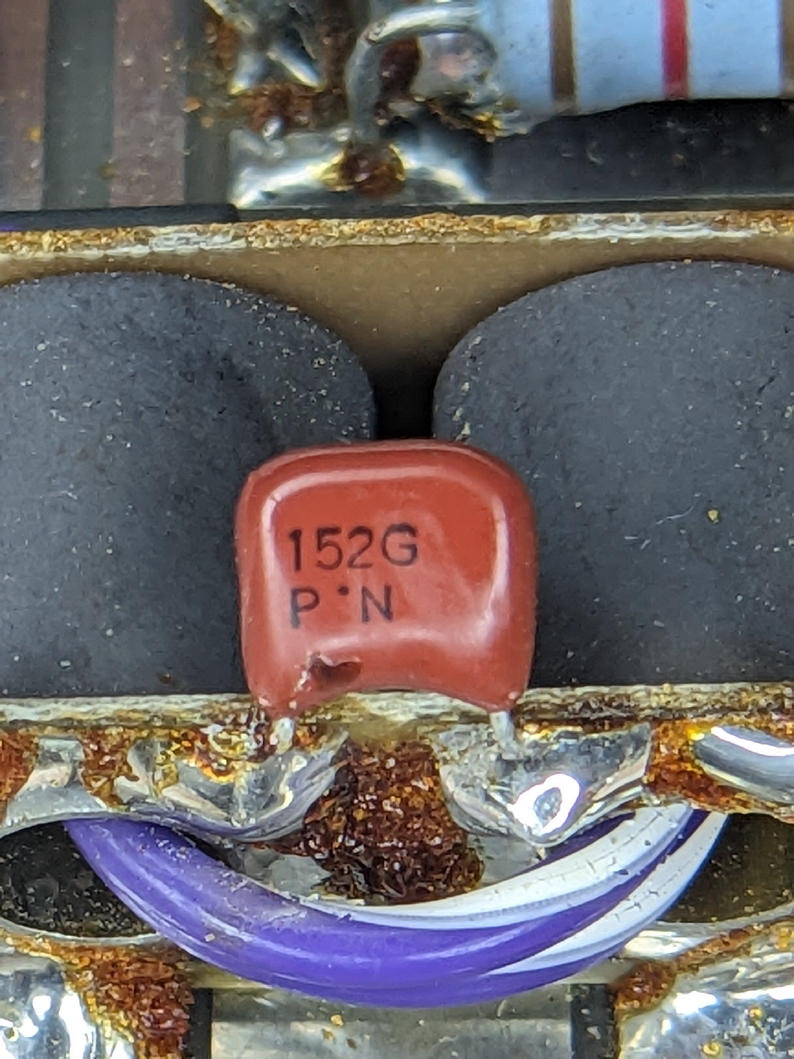

Don't remember seeing the metal-clad mica caps go bad. Does make me suspect either a loose circuit-board screw or missing/ damaged negative-feedback resistor/capacitor issue. I have seen the capacitor on the secondary of the input transformer go bad and create issues. Worth checking.
