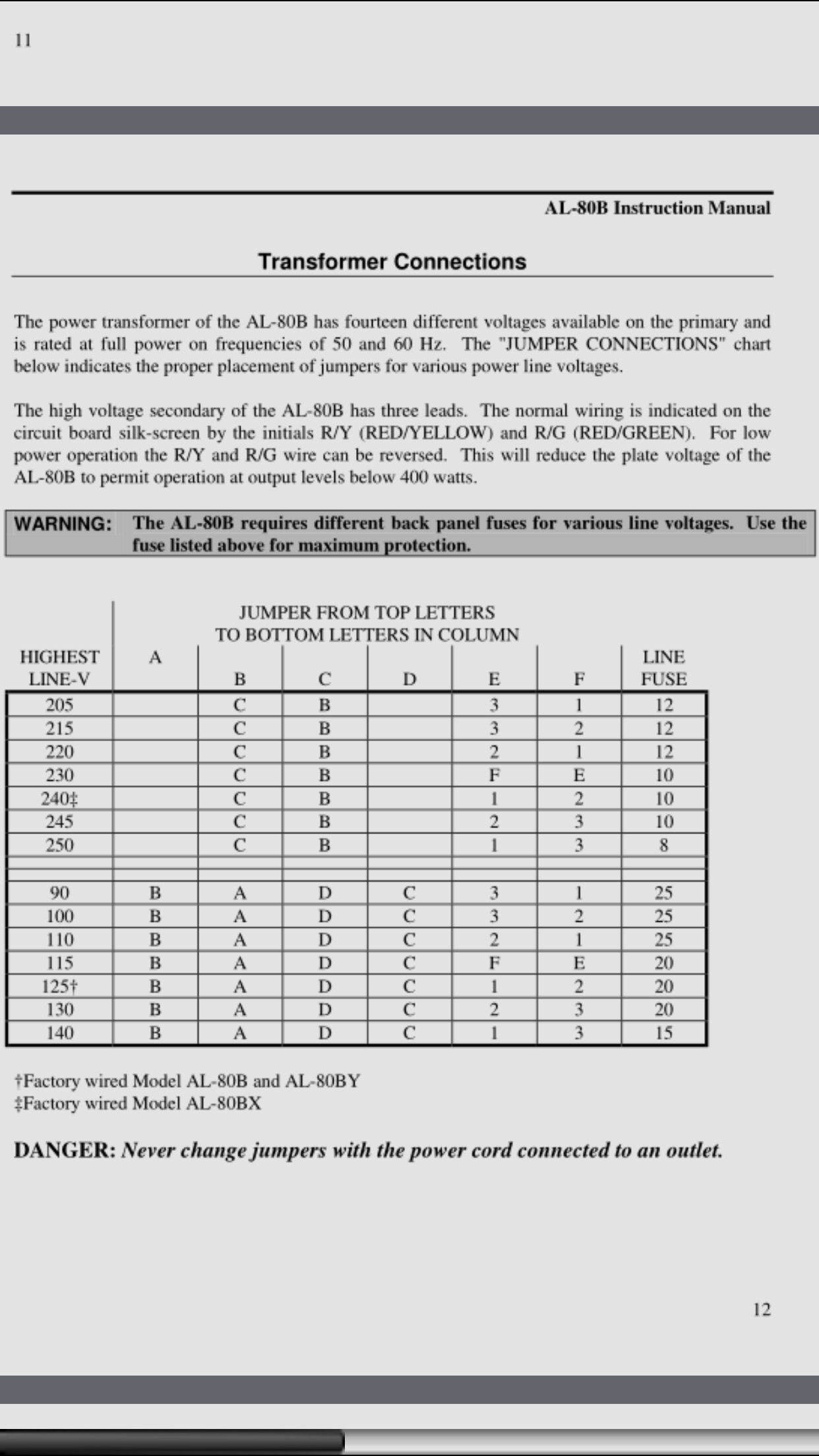

Before laying this to rest, in most amps can set the taps to whatever voltage. My meter outside says 240 volts, I take it that's MAX voltage, in the Ameritron manual says highest line-v so should set it to 240v or to 250v just incase I ever move and it has 250v?
The main consideration is to select the tap that results in the proper filament voltage and not worry about what the plate voltage is. This why I like separate filament and plate transformers. If you ever move some place where the line voltage is different change the taps to reflect that difference.
