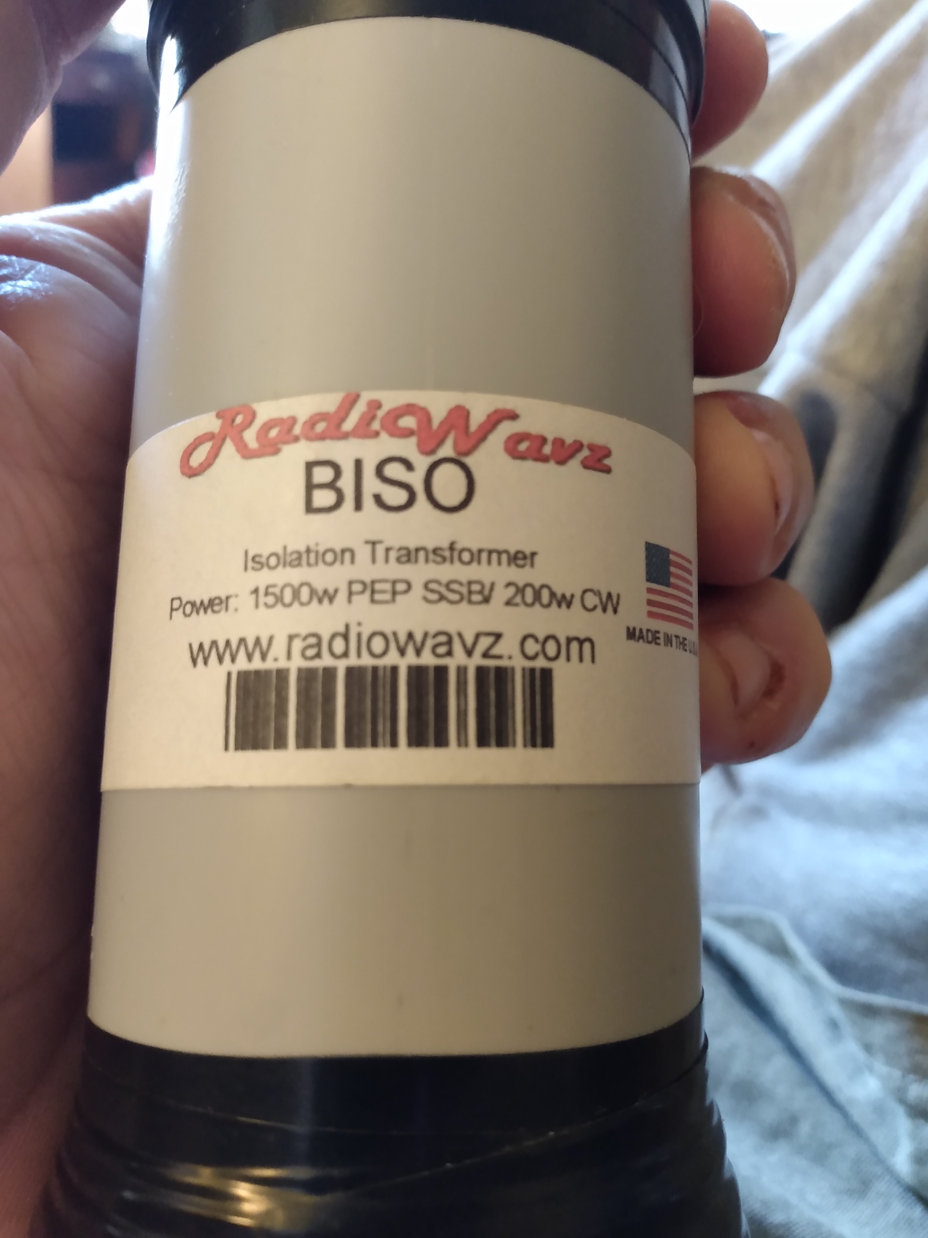

Well, just noticed my current balun is only rated for 200 watts CW. Guess I got fooled, when I read it handled 1500 watts SSB. The 200 watts is in small print. This will not do.
Made by the same guys that make gainmasters ?
Lol,
Radiowavz 1:1 current balun. I can dial back to 200 watts, but I'm sure I'll forget one day and poof it.
