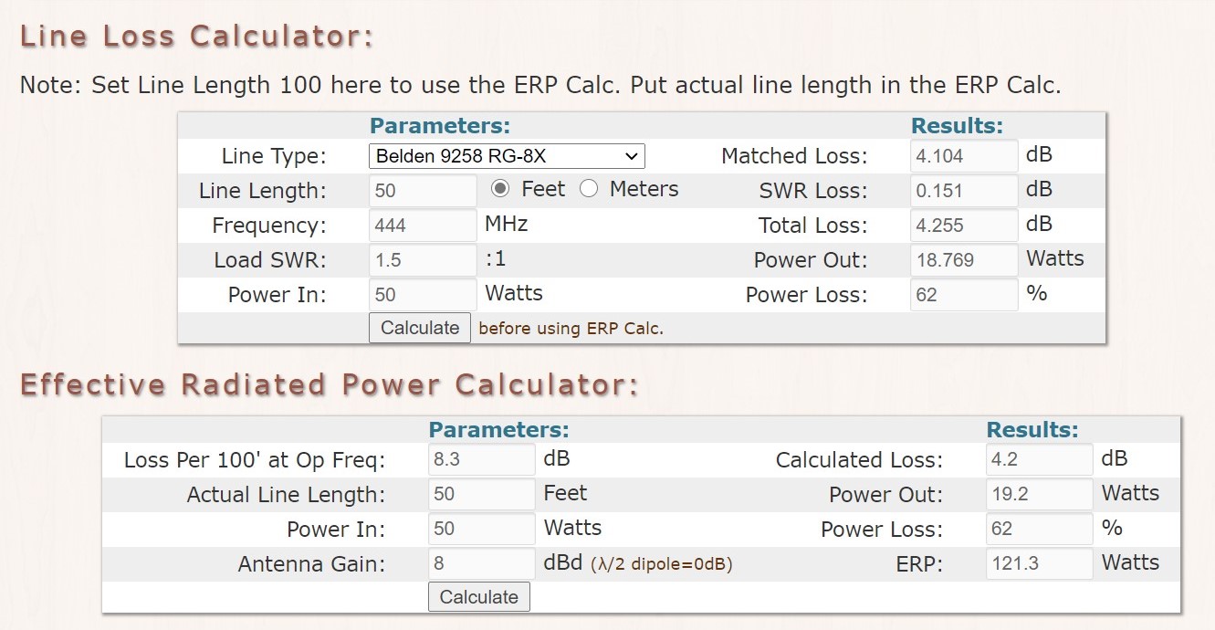

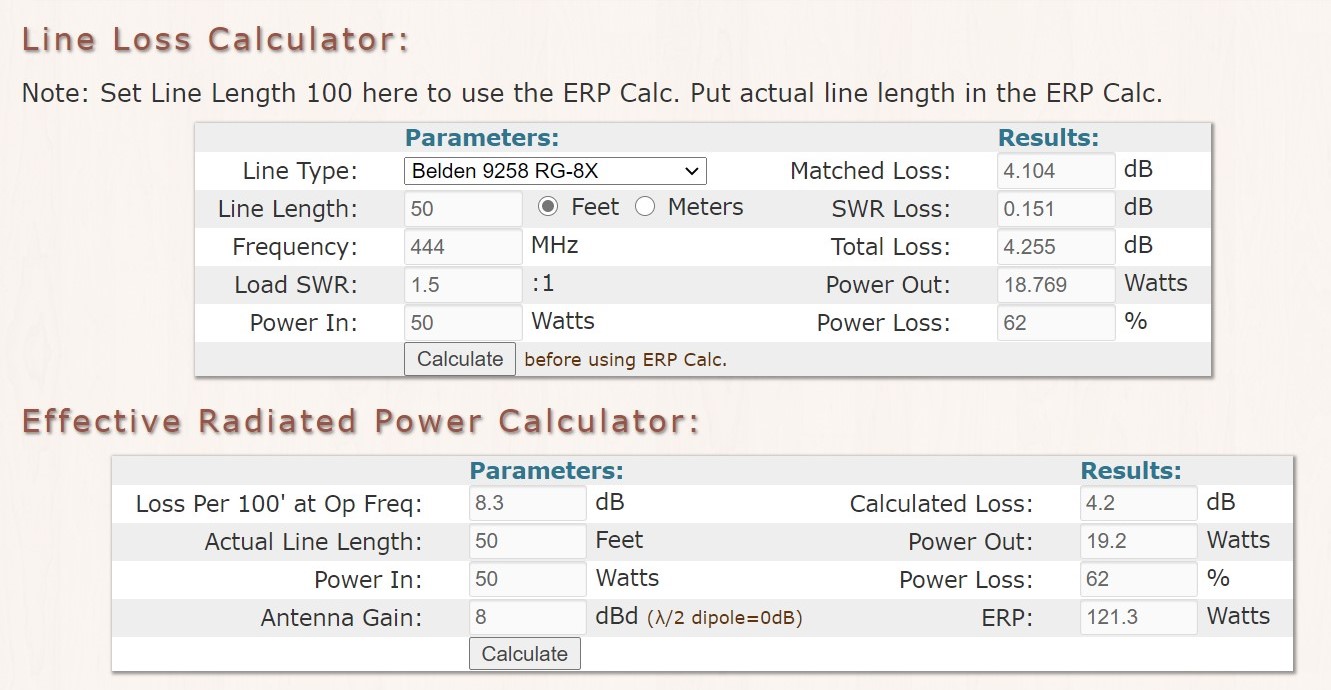

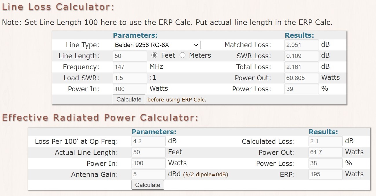

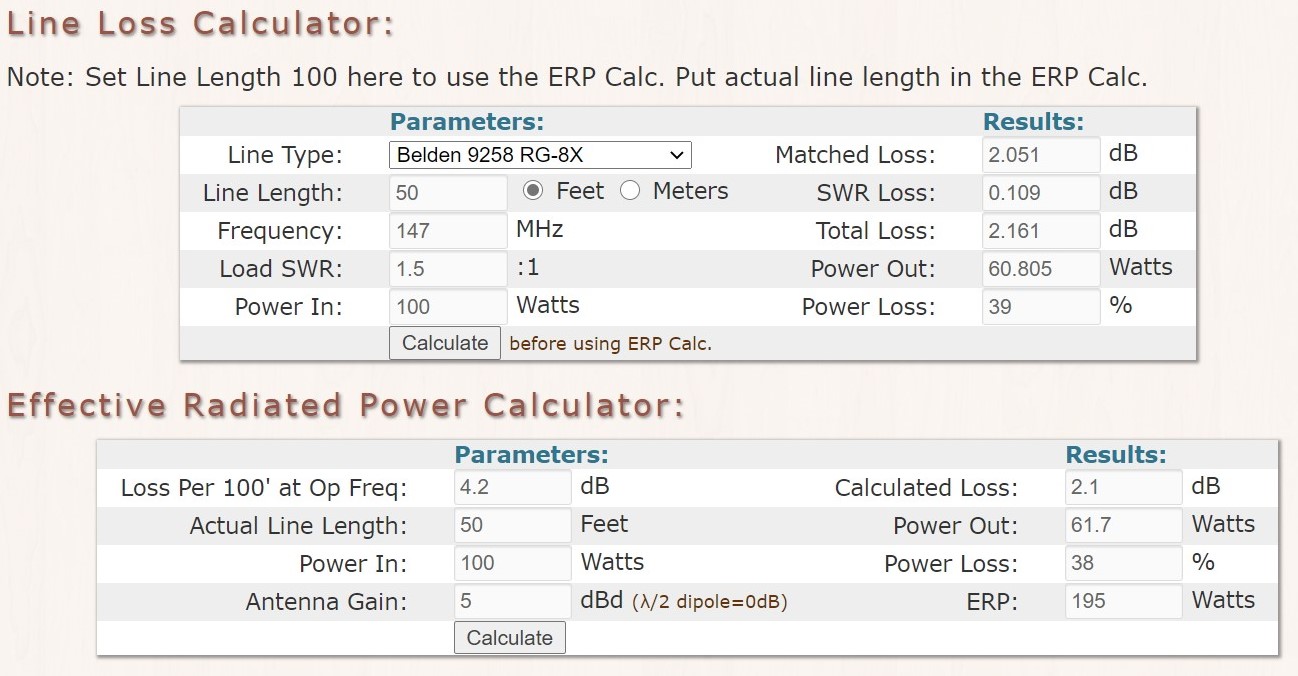

Greg: That RG8x will be JUNK on anything above 10 meters, unless you only plan on less than 50ft TOTAL to antenna.
Then even still to that TRAM antenna on 2m.

That TRAM antenna is fine, but feedline loss is even MORE important than antenna gain.
You will have nothing left at the antenna if it all "bleeds" out before it ever gets there.
Case in point: My 6 meter beam...aprox 75 ft. from radio to antenna, I am running the equivalent of RG8 TRI-SHIELD (LMR400max)...not even close to where I should be.
This Spring will be changing over to at least 1/2 inch Heliax type, both on 6m and 2 meter antennas.
The new 50ft. tower another 60 + ft away will get 7/8ths Heliax from shack to top of tower. Then covert to 1/2 inch superflex around the rotor and to boom of antenna.
This change alone will gain about 2 extra dB to antennas.
You must remember 3 dB loss equals 50% power loss, that pretty much is BOTH transmit and receive ability.
Just FYI before you jump in and put that Dual-Bander up 50+ft (100+ ft. feedline) on the tower and run RG8x to it, won't be much signal left when it gets there,. plus not much coming back either.
