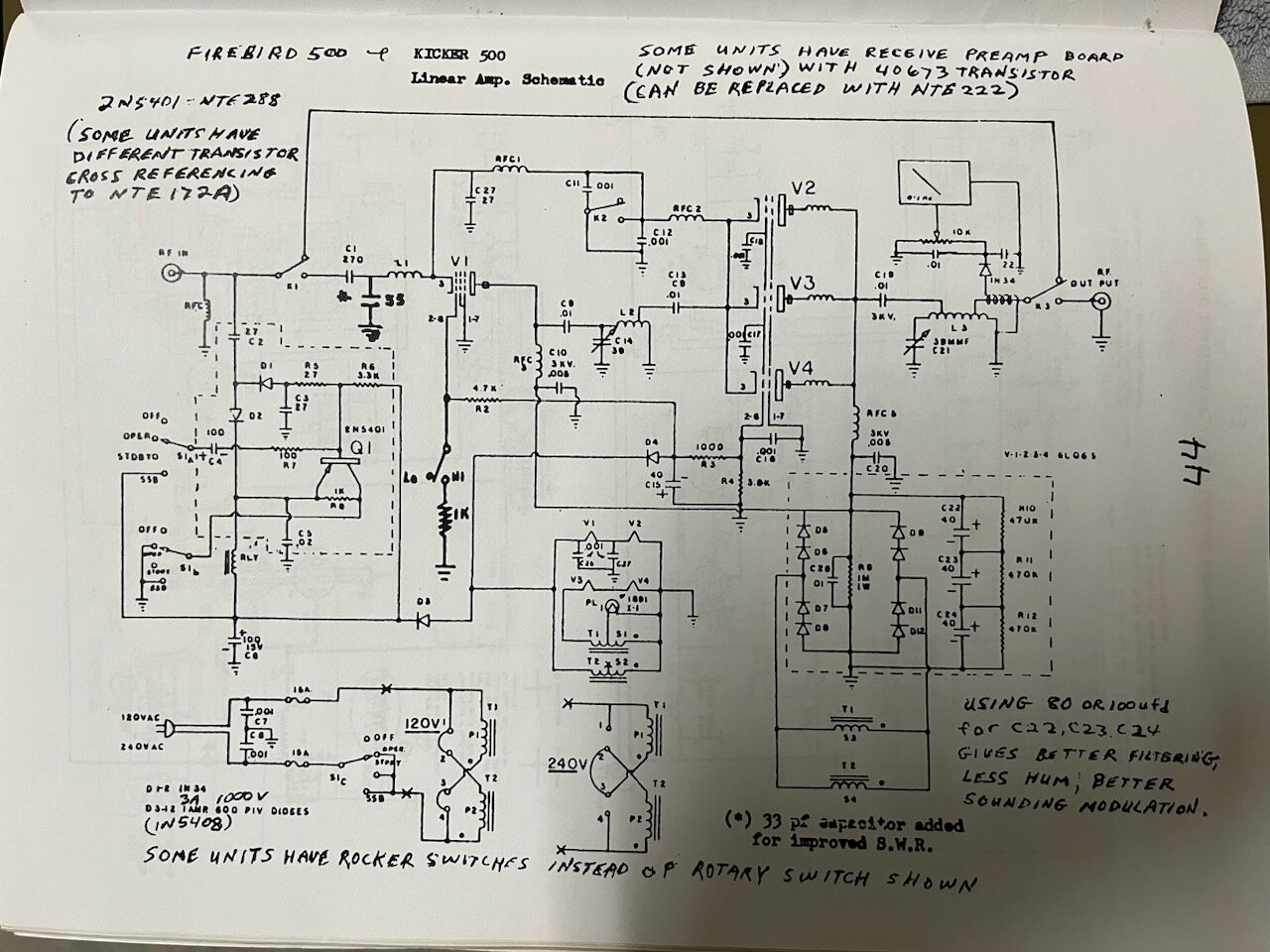

Firebird V 500 Schematic
Try this. Only potientiometer I see is connected to the meter. Shows a value of 10k ohms.

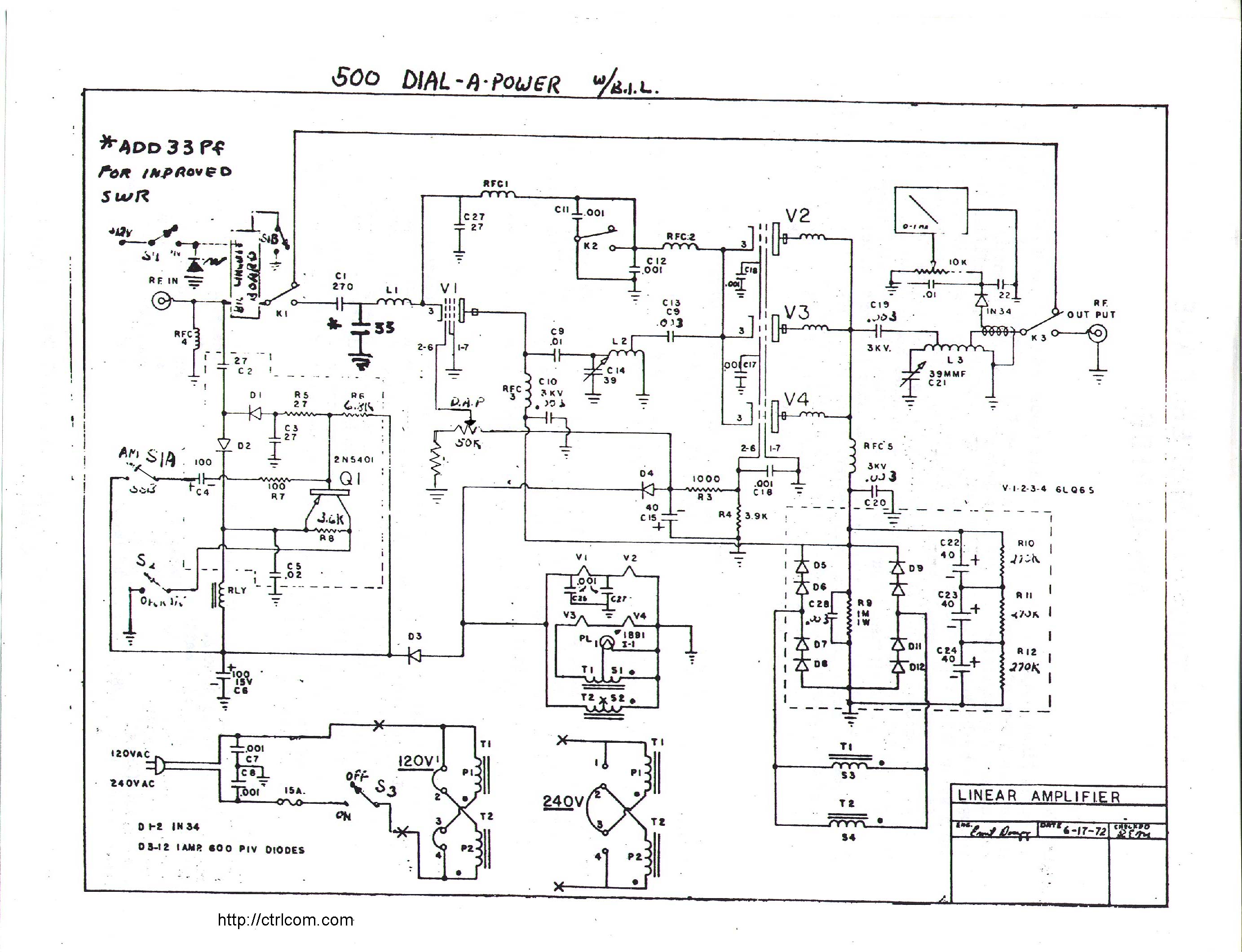

Yeah, the "V" 500 was different. "V" as in variable. Has a carrier rollback pot on the front. Seems to me it was 47k, and prone to burnout.
(brief pause)
Found it! Says "Dial-A-Power", not "V", but I think this is the same thing. I remember this as a somewhat-flaky setup, but it's been a while. Probably just as well.

Oh ok, Thank you very much man, that helps a ton, and yea I sure thought it would be a 10k, appreciate the new info my friend.
