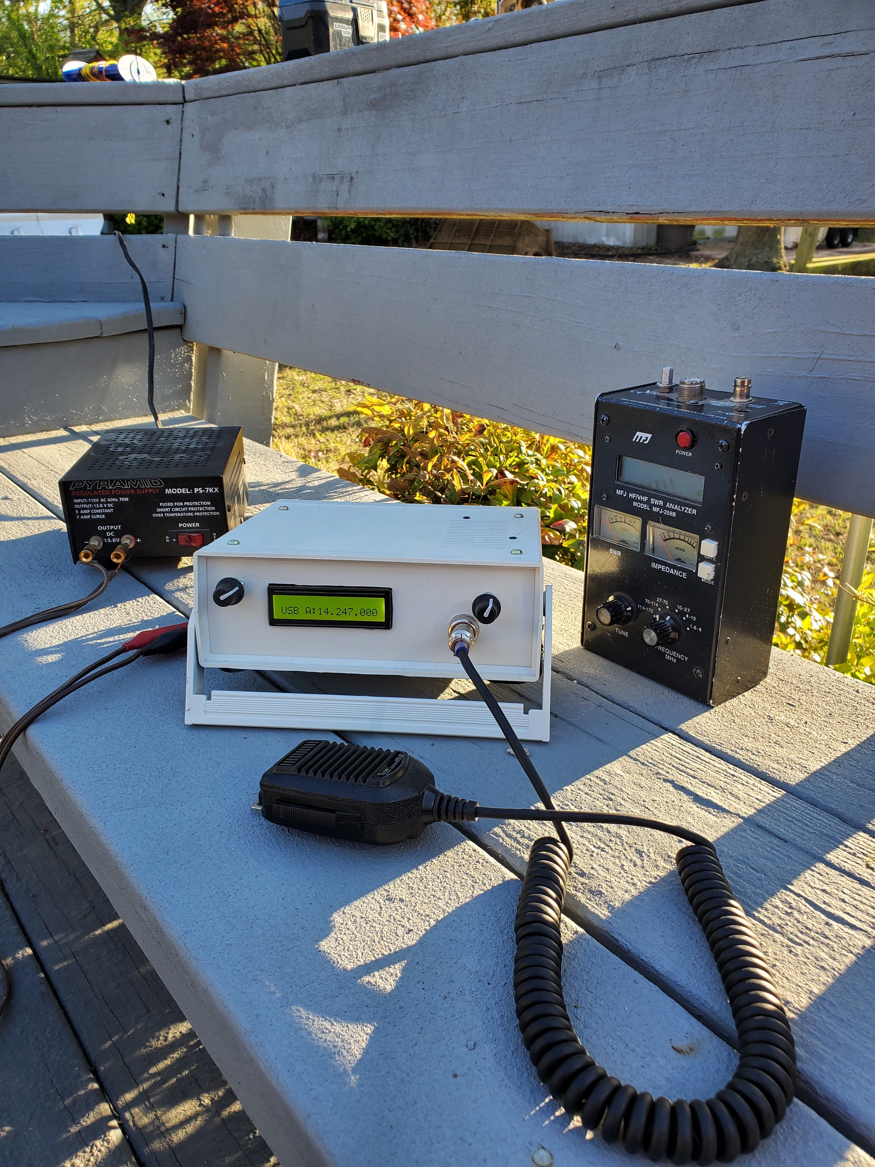

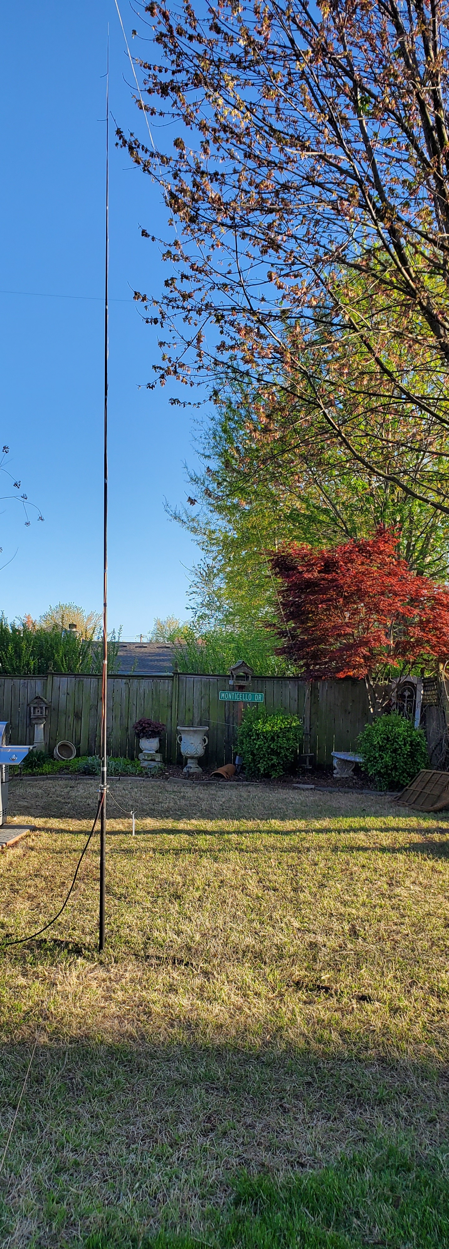

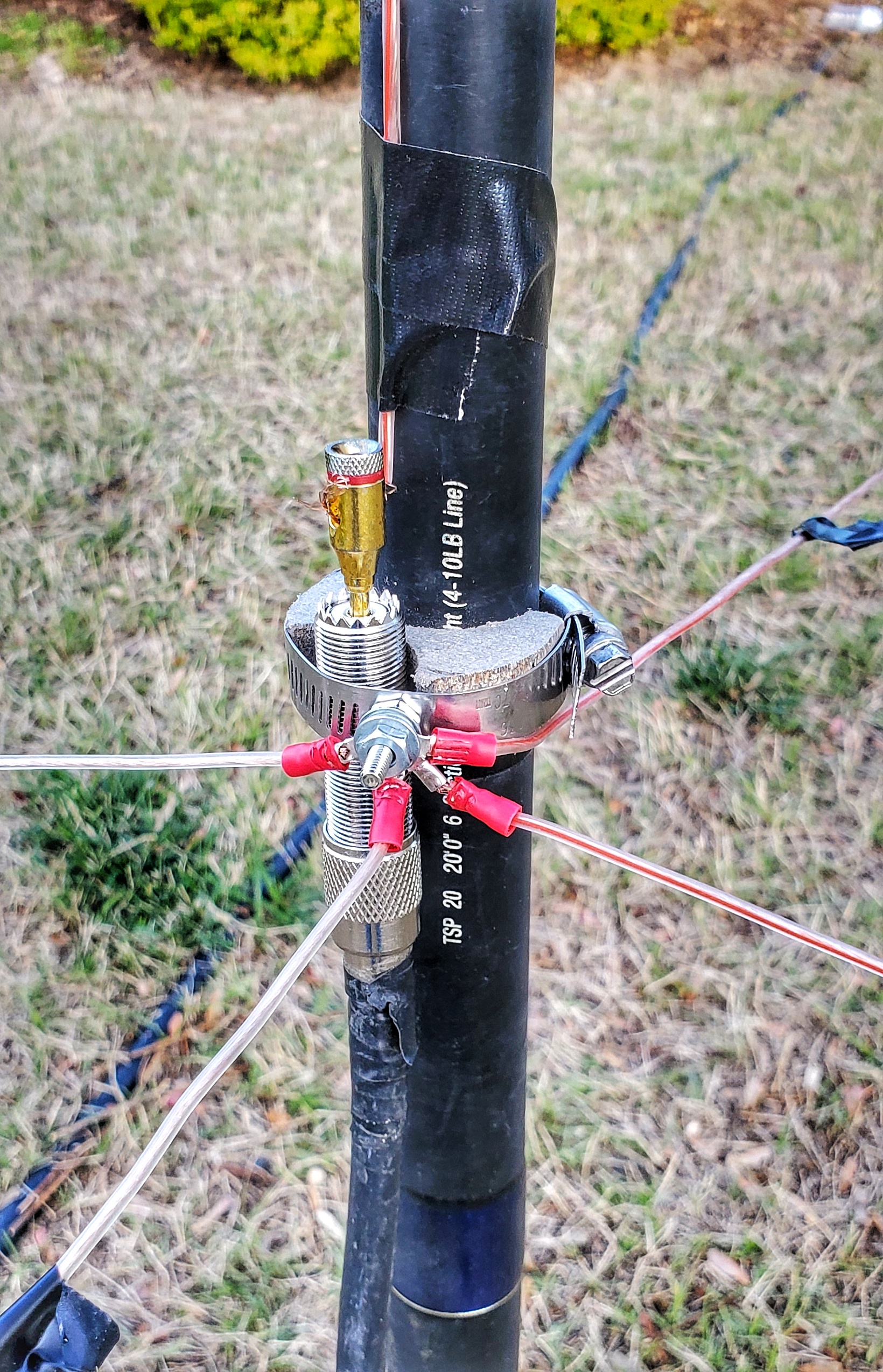

I finally got the uBitx v5 basic radio put together and put up a 1/4wave GP for 20m together. The antenna is a 20' telescoping fiberglass crappie pole. I ran a wire cut for the band and two opposing radials above the ground 3' up at the antenna and 1' off the ground at the ends.
I dialed around 20m until I heard Lee, K7IOC, from Camano Island, WA. I managed to get a call in and he came back to me in Rogers, AR, 1633 miles. He was 59, he reported me 55.
Happy with my first QRP radio contact
I've made a few more contacts.
I had the version 4, but soldvit for money back. A local put it on the air and so I bought the version 5. It sat on the shelf unassembled for months. Fitbit together.
Those with whom I QSO find it remarkable that I work them with 5w PEP. I need practice breaking pile ups...

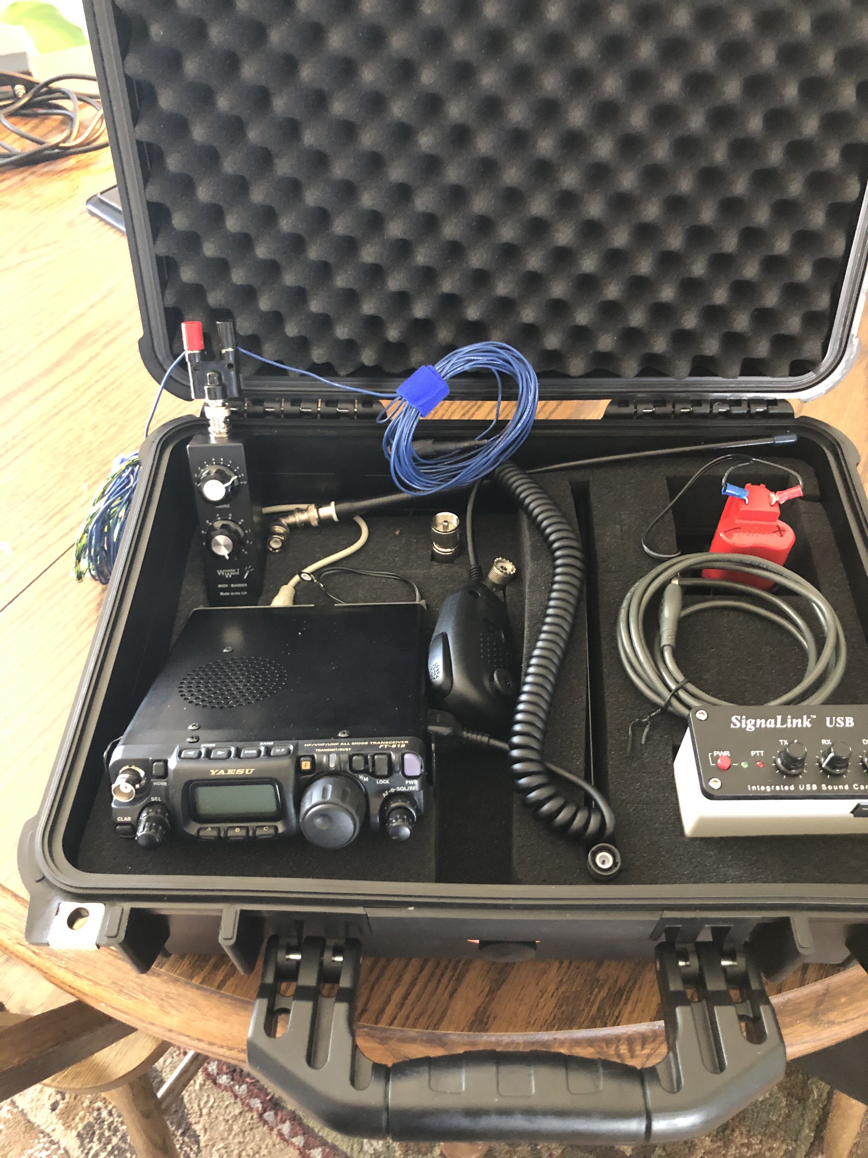

I like qrp,, built a bitx40 a while back and I was using my yaesu ft-891 set down to 10w last summer outside ,, just got the yaesu ft-818 because I didn't want to wait any longer for the icom705 to be released. I was outside yesterday for a few hours and today for a little while. ssb contacts can be made and ft-8 contacts are very easy qrp

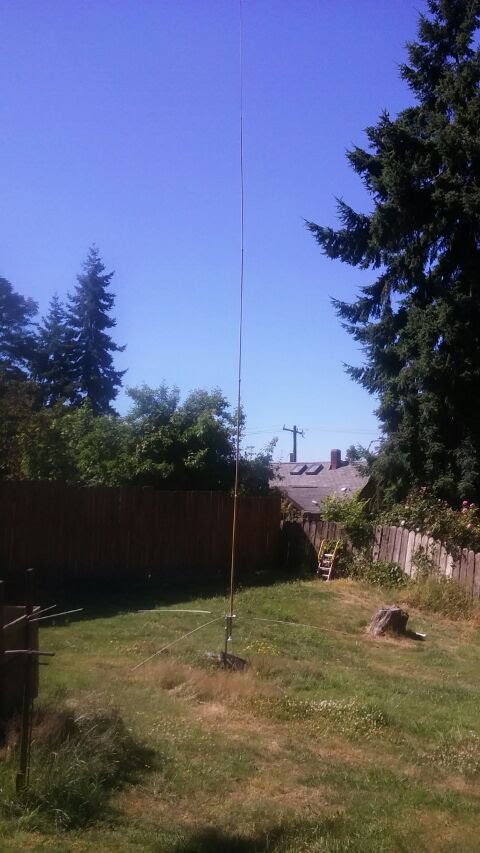

Looks kinda familiar :-)

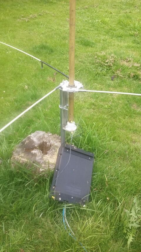

'course I put the SG-230 at the base.
The bracket is an old rat-shack with a lathe turned bottom insulator.
The vertical is an old anodized aluminum telescoping marine whip with
collet/gland nuts at the base of each section, approx 34'.
