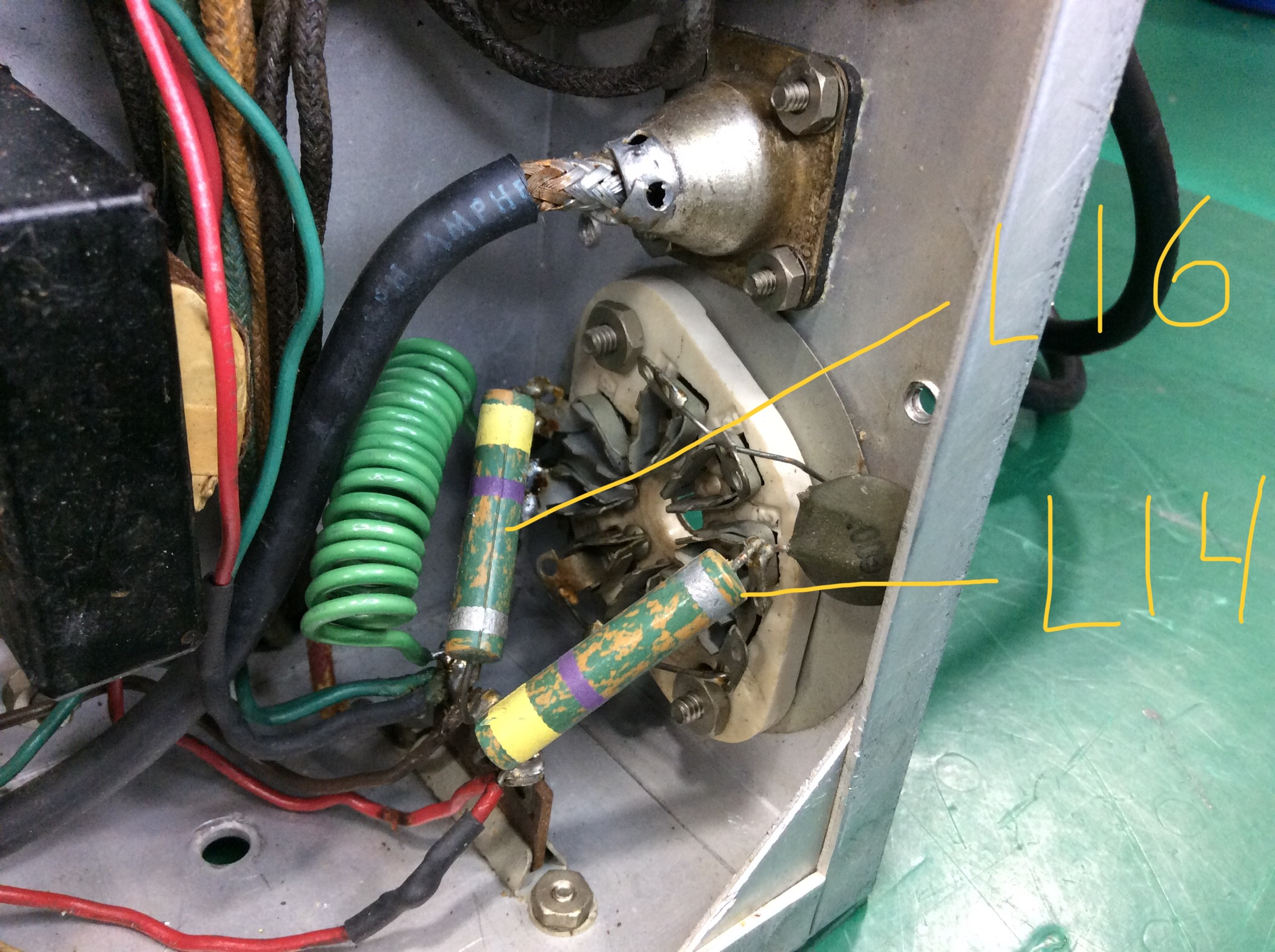

we’ll guys I can’t thank you enough for all the guidance in getting me too where I am with my Viking II I truly appreciate it!
My last question is Viking 122 VFO with Viking II related issue, issue is it’s not working.
Viking II works great when using a crystal, when plug in the VFO I’m not seeing Oscillator current drop in Crystal Position 0.
The tubes in the VFO are lighting.

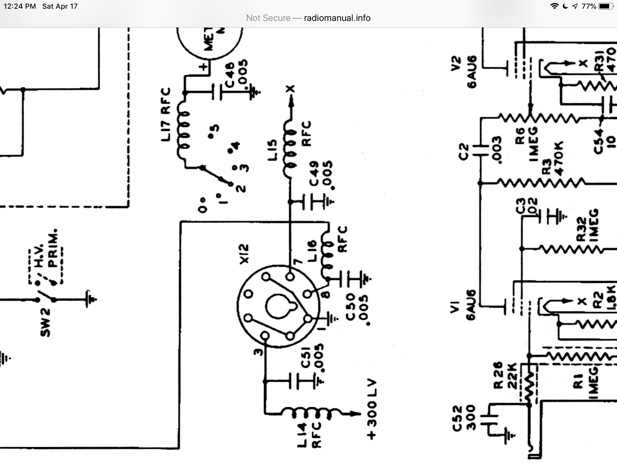

Does anyone know what I should be seeing at the connector/ Plug for the VFO on the Viking II and what voltages I should be seeing inside the VFO itself?
I replaced every out of tolerance component in the VFO and checked for proper wiring per the build instructions.
