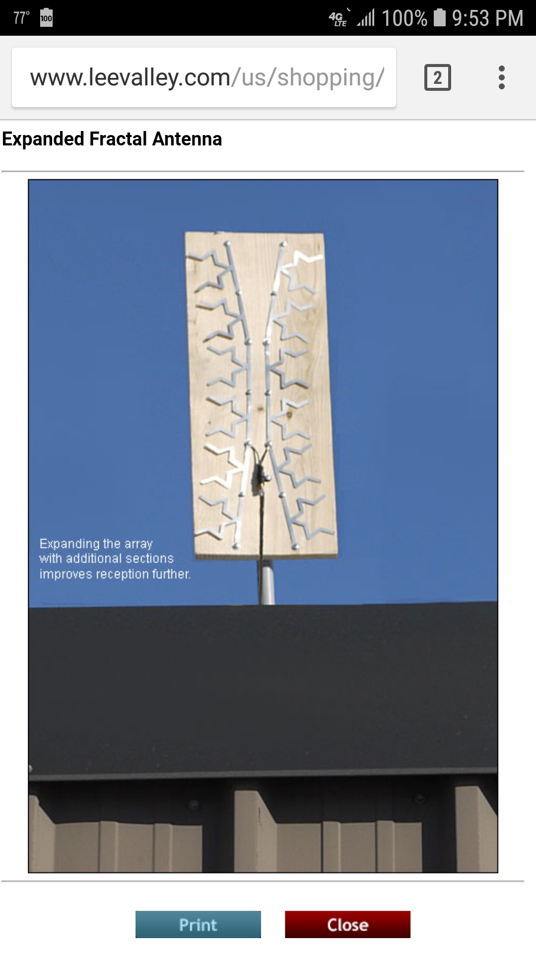

Just lay it on top? Or find plumbing vents and use them as a stand-off with an insulator of some sort? You could use hose clamps and some black PVC for the standoff.
I often use the PVC vent pipes already sticking out of my roof to mount light antennas on.
Like this person did with their homebrew TV antenna.
