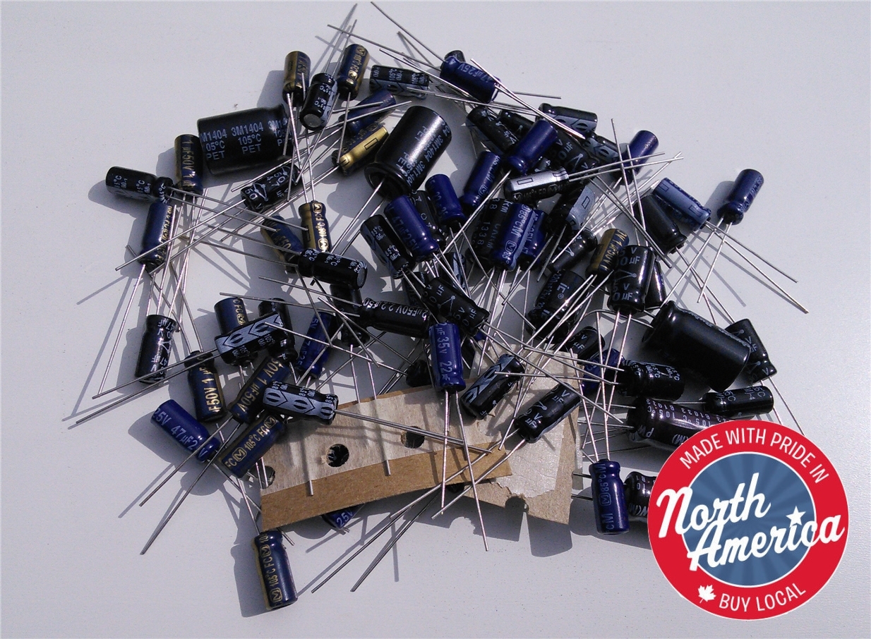

... Yes, I plan to order a few cap sets from eBay.
As a member here @ WWDX, I can give you a discount on my kit. A local North American business with no Chinese counterfeits. Send me a PM for details. See my eBay listing below for more information;
http://tinyurl.com/h3ssbxw
Hey mike, I was looking on eBay and saw a Canadian company selling the caps. I guess this is your company. I will contact you by pm later on today thanks!
