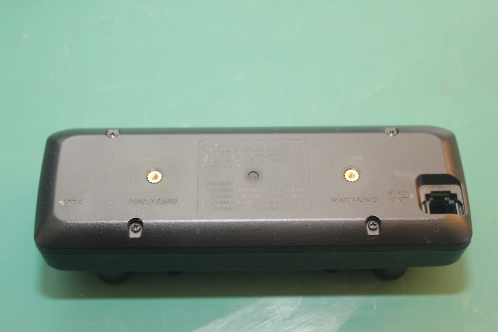

Would you mind posting a picture of the back of the face, without the MBA-4 bracket attached?
I plan on getting this radio and attaching the face directly to a single din blanking plate and tucking the main unit in the center console.
Unfortunately, I can't find any pictures of the back of the face to plan out the install before making the purchase.
Here you go (attached)

Awesome, thank you.
Icom really doesn't give you much to go with to mount it out of the box.
Looks like I may be able to take the back off, make new screw holes in the single din blanking plate, cutout for the board and rj11 port, and mount the face flush with the blanking plate.

I'd probably just make a plate that mounts up to the rear screws or if I didn't feel like fabricating, spend the $30 for the MBA-5 plate bracket and alter that for whatever purpose I needed. That's what I ended up doing with the ID-5100, which turned out pretty good.
My issue with that route is that the back of the face has a beveled edge. I was hoping to have more of a flush look to it.
I thought about getting the MBA-5 plate and just having it magnet mount to the flat surface, but I'm not sure if that would look alright. Going with the MBA-5 will definitely make the install easier, but I suspect it may extend the face out too far.
I ordered a "1 din dash frame" for my dashboard, and the ic-2730 will fit just perfectly on the $5 blank plate, with about 20mm of space on either side, and about 5mm on top and bottom, if centered. Going with the flush look, in my opinion, may make/give it more of a "factory installed" look.
If the flush install doesn't go as planned, I'll definitely give the MBA-5 a shot. I'm okay with losing a few extra bucks to try something a bit more involved.

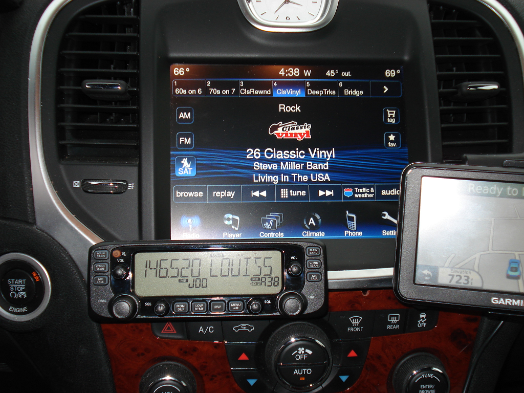

Finally got the radio and parts in and got the faceplate mount fabricated and in place. Here's what the faceplate looks like installed.

I made a L-bracket for the radio control head and placed the assembly between the two sections of the car control panel. NOT as nice as Matt's but it works for me.
