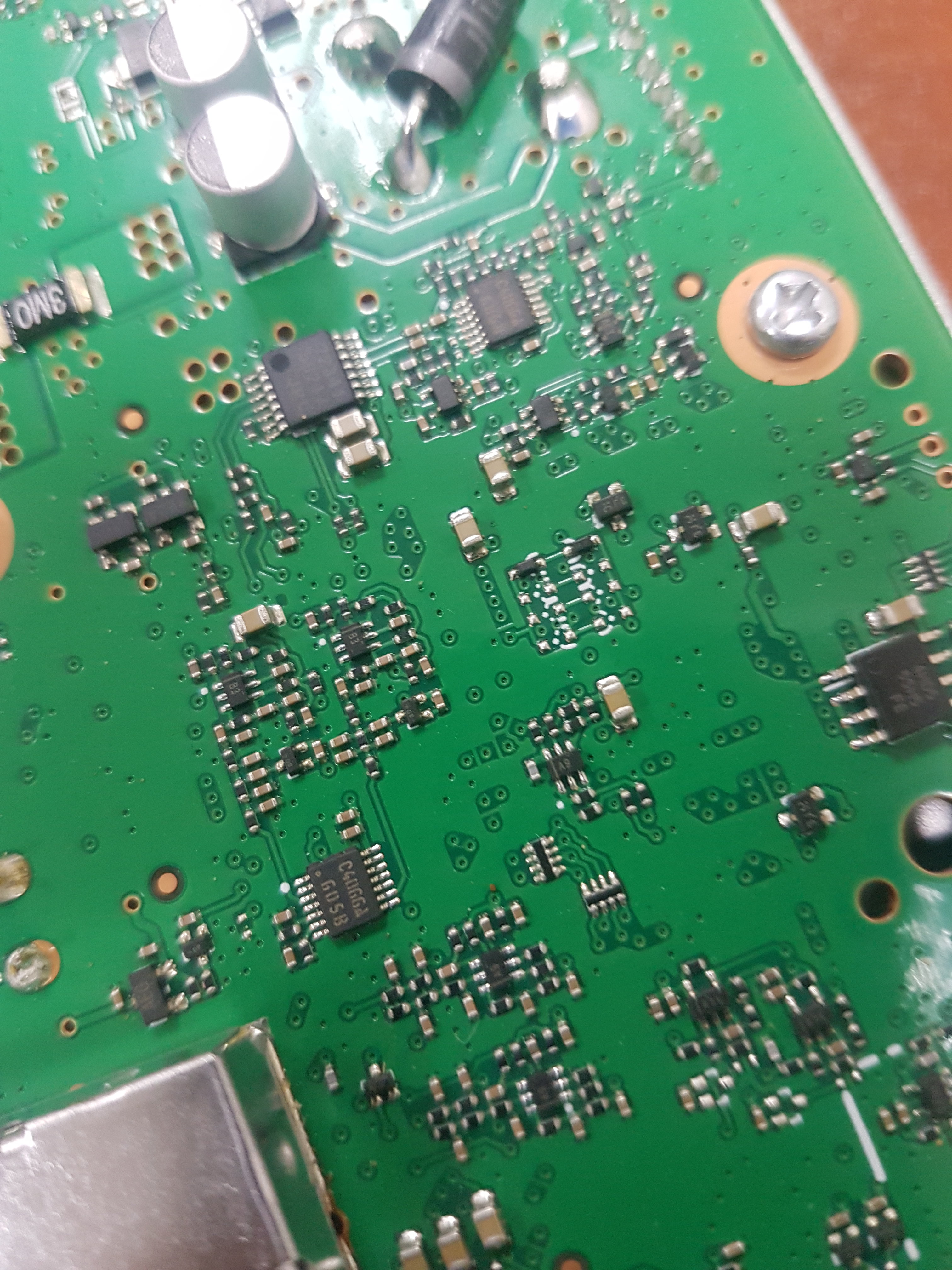

If the repeater menu item isn't showing up after the button press, it might be a good idea to check if they changed the feature selection diodes.
I myself have a IC-2730E and on it, I had to remove a diode D319 for the repeater-enabling key-combination to work. Before I did that, the key combination did nothing. From what I've read, the IC-2730A should come without that diode.
It might be worth contacting Icom dealers about that, for those who are uncomfortable doing it themselves. In one Icom UK video, they mentioned that they will enable the repeater, if it's needed.
Also, some distributors might not be up to date with the changes needed. People at the place where I got my radio didn't know that diode removal was needed.

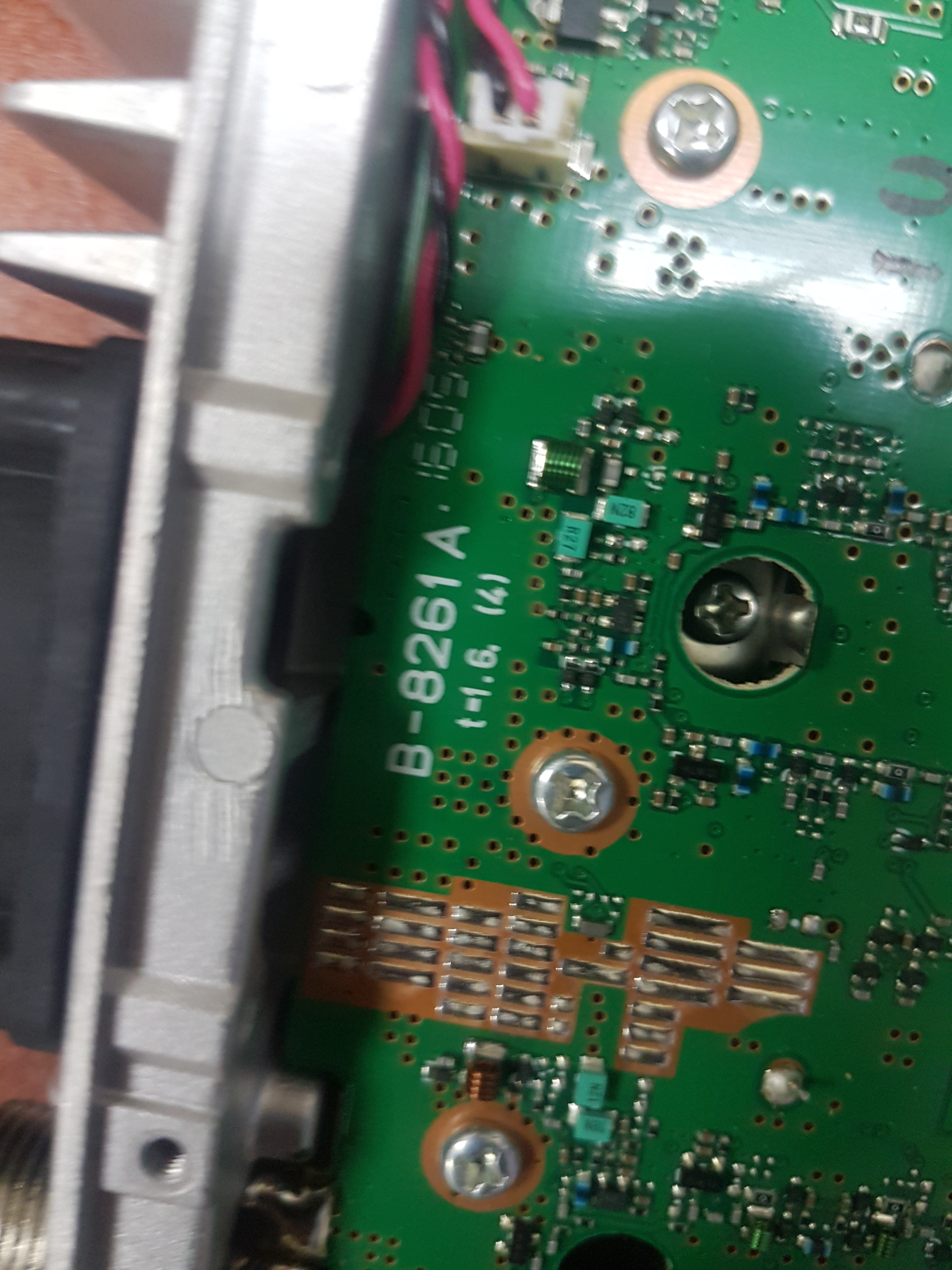

HI.. I believe that this is relatively old but would appreciate any help here. I have the icom IC-2730D and would like to expand the TX range. it currently has a range of upto 440Mhz that is standard. I have also looked up forums mentioning to remove the D307 and D315 diode, which should solve my problem . Unfortunately the unit I have doesn't have these diods and am currently lost. Any help right now would be appreciated. 20170918_113259.jpg 20170918_113355.jpg
