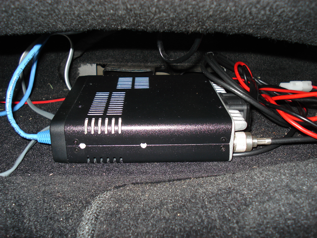

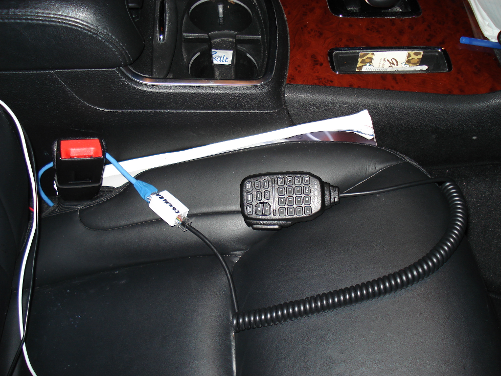

Right now the body of the radio is under the pass seat with a short cat 5 lead to a cat5 coupler to mic.

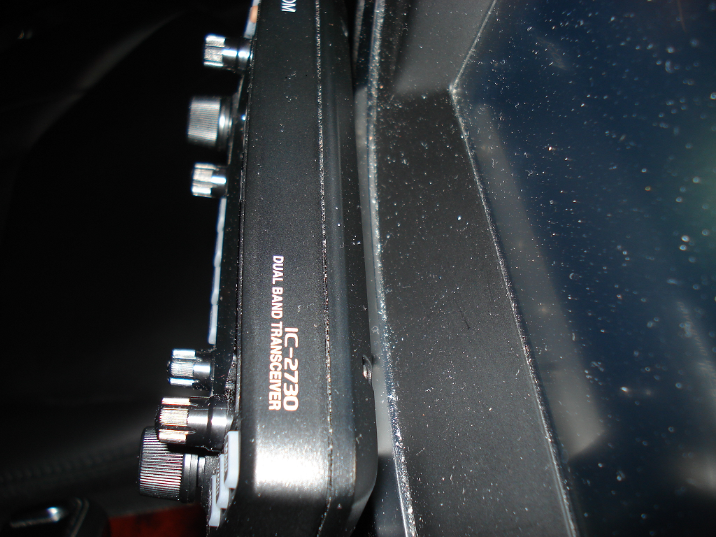

1. head next to dash
2. radio under seat
3. mic cable

@Fuzzybr, Is your radio mounted under the seat, or just sitting there? I wanted to mount mine under there but, I already have an amplifier under each seat. I ended up putting mine behind the glove box. Because the microphone cable is so stiff, I'm a bit paranoid about plugging the microphone into the faceplate. Even though it's mounted, it seems like the pull distance would rip it out.

To extend the length of the microphone, I used a straight through coupler that could be mounted, and Cat5e, since I had it readily available. The connection went from the microphone, to curly microphone cable, to coupler, to patch cable, to radio.
