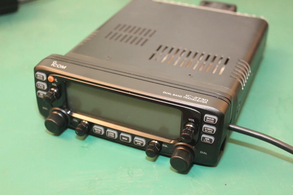

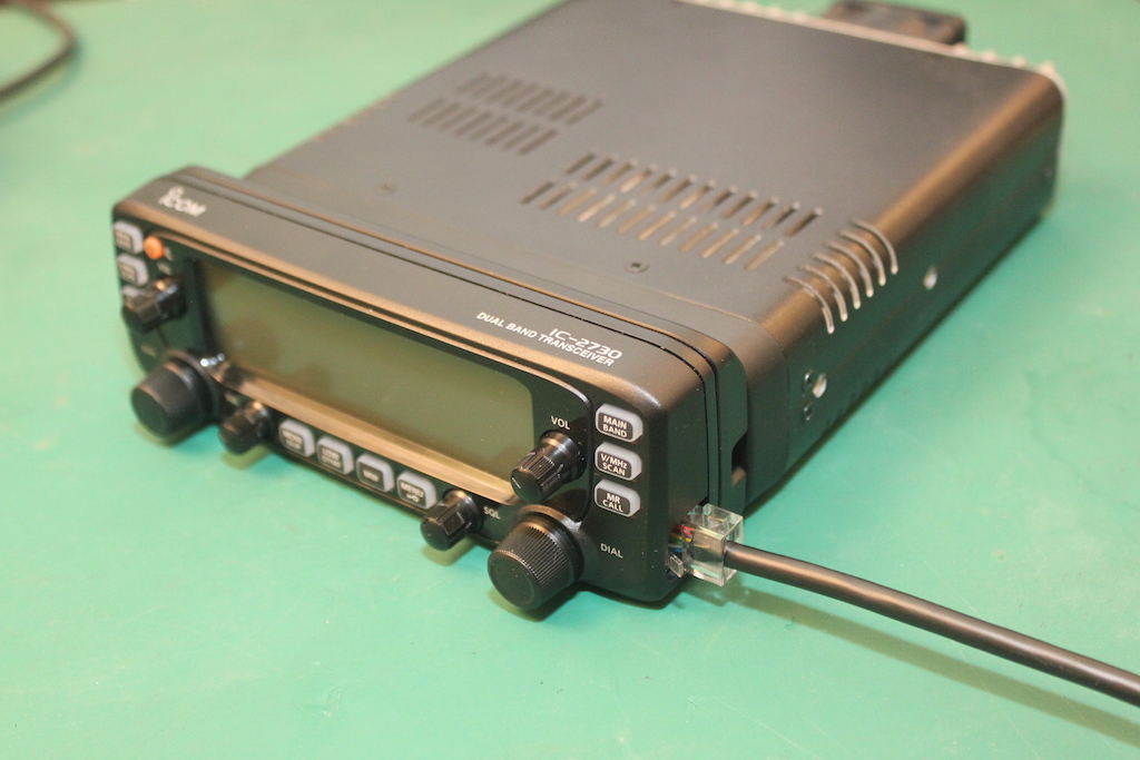

The IC-2730 is Icom's newest dual band (2m/440Mhz) mobile radio which features dual wide RX, 50 watt power output, large display, lots of memories, and crossband repeat. The price-point of this radio (I paid $349) demonstrates the competitive market for rigs in this category. While the price of this radio is pretty aggressive, Icom is packaging this radio in a similar manner to the ID-5100: No brackets for the body or face.

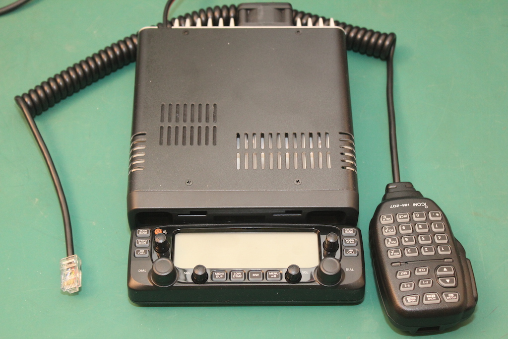

The above picture does not show the power cord, manual, or mic hanger, but it does show you basically what is included in the package. The construction of the body is typical Icom quality: sleek but tough. The mic is the same as the one included with the ID-5100; reports of audio quality have been great and it's also easy to use to control the radio.

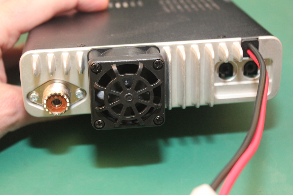

The rear of the radio features the same aggressive fan as the ID-5100, which is both good and bad. It's good because it really does a great job keeping the radio cool, but bad because it is very noisy. You can control how often the fan is active via settings in the menu: "Auto" only keys when you TX or if the radio is very hot, while "Slow", "Mid", and "Fast" are continuously on at the rate indicated. The large rear aluminum heatsink also contributes to keeping the small chassis nice and cool. The two speaker jacks are for left and right band audio, although the inside speaker jack sends both left and right band audio out if that is the only jack in use.

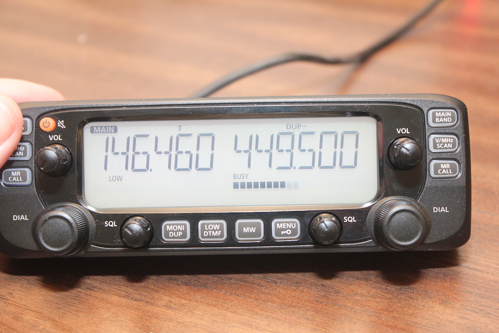

As you can see from this pic, the face is actually pretty small. My first reaction was that the small size would allow me to place it just about anywhere in a mobile install simply using double-sided velcro or tape to the back, but that assumption was quickly proven wrong when I saw that the RJ-11 jack that connects the head to the body is right in the back of the head, preventing any flush mounting. If Icom had placed this jack on the side of the head (like where the mic jack is), the mounting options would be significantly increased.
One of the best things about this new rig is the large display font. This radio is really easy to see compared to most other mobile rigs!
The menuing system is super easy, as well. You just hit the Menu button, then use the left dial to scroll through the menu categories, hit the arrows to go to the sub-menu, and then use the right dial to select the various options
This radio is definitely easy to use; the RX audio sounds great, and all of the TX reports I get are equally good.

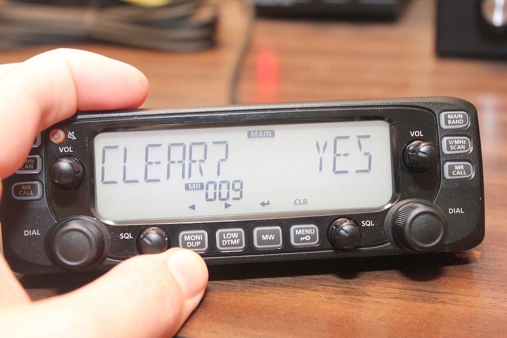

Here's a pic of clearing a memory; you can see from the menu on the screen that you simply press the CLR menu and rotate the dial to confirm the action:

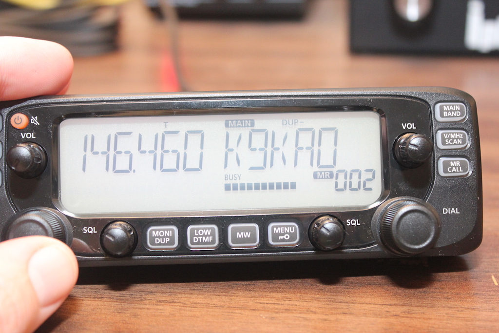

As I mentioned earlier, assigning names to memory channels isn't too difficult once you know how, and the result is a nice large displayed name on the screen:

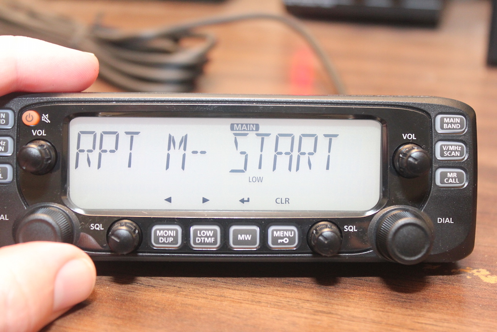

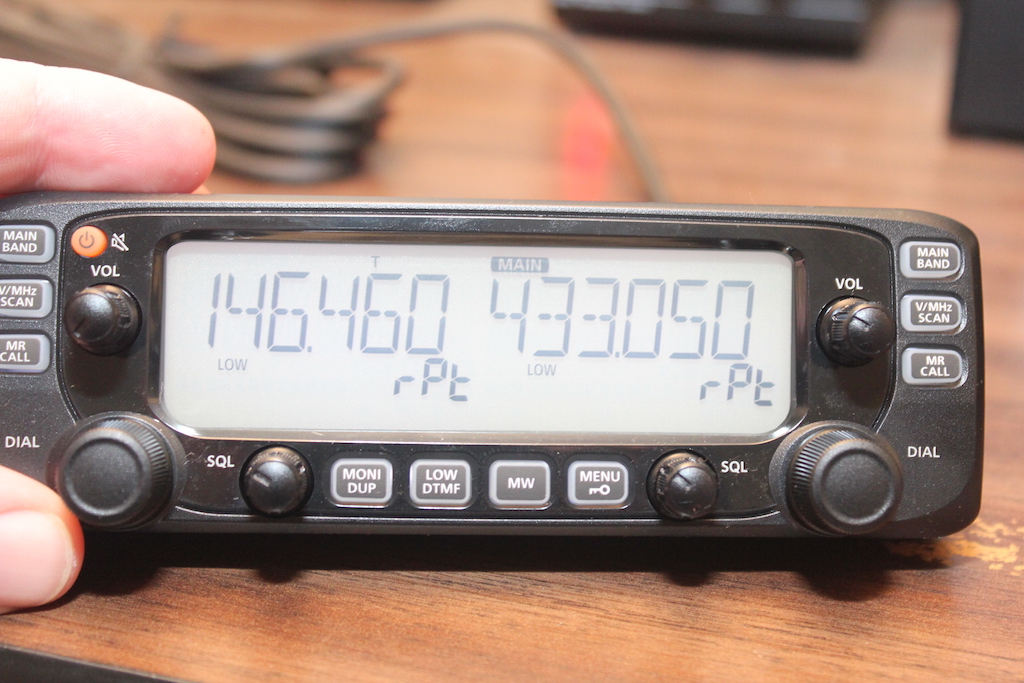

The IC-2730 supports Crossband Repeat, although there is no reference to it in the manual. I contacted Icom technical support to find out how to activate and was promptly sent an manual addendum with the procedure. Here's how you do it:
Before you activate crossband, set the frequencies you will need, including any PL Tones, DCS, etc.
1. Press and hold both MAIN keys, MONI, and then press power.
2. Press MENU.
3. Rotate a tuning knob and select EXMENU.
4. Press MW. Rotate a tuning knob and select OTHERS.
5. Press MW. Rotate a tuning knob and select RPT M.
6. Press MW. Rotate a tuning knob and select START.
7. Press MW. Rotate a tuning knob and select YES.
8. Press MW. The display will show both bands with rPt listed under the frequencies. The crossband feature is now activated and you may operate in crossband mode.
Note: Once you've activated the crossband repeat menu by following step 1 above, the cross-band feature will now appear in the menu unless a full reset is performed.
To Exit Crossband Repeat mode
1. Press Menu.
2. Rotate a tuning knob and select YES.
3. Press MW. To return to cross-band repeat mode, perform steps 2- 8 as above.
Moleculo,
I'm not having any luck.
(nothing is happening after this. Maybe not holding my mouth right????)

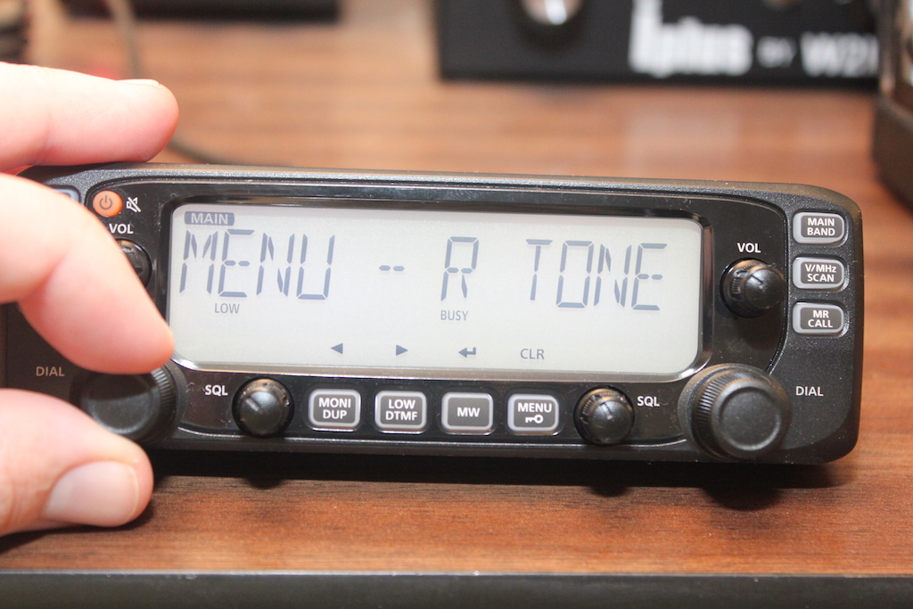

Can you verfiy that the radio can be programmed to accept two different PL tones for the TX and RX of a repeater?
Thanks!
Bubba
Moleculo,
Thanks!
Bubba
Yes, it can do that. First set the desired repeater tone using the "R TONE" menu, then set the desired tone squelch using the "C TONE" menu. Then you go to the "MENU - TONE" setting, select the menu and rotate the right dial to select the "TON.TSQ" option. This will set the TX tone to the "R Tone" value and the RX tone to the "C Tone" value. You can also transmit using a tone and receive DCS and vice-versa. I currently / frequently use the radio in a configuration like this. Incidentally, many other radios have this capability, but it can only be set using programming software - with the IC-2730, it's easy to do just using the front dial.
I know this page is about the 2730, but can the 5100 also do this? If so, with programming software only or front panel too? Thanks.
No, the IC-5100 cannot do this - not via the front panel nor the software. There is a work around if you're trying to use the radio as a remote with crossband repeat and only want it to crossband repeat in one direction, but that's a topic for a different thread ;)

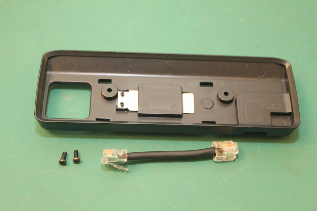

Attaching the Radio Face to the Body
The last few mobile radios that Icom has put out do not include brackets of any kind: no bracket to mount the body in a vehicle, no way to mount the face to the radio body, and no way to mount the face to anything. Of course, all of these methods are available, provided you purchase the optional brackets, and the brackets are a little pricey.
I opted to buy the MBA-4 bracket that allows you to mount the face to the radio body. For $49, you get the following:
Simply attach the adapter bracket to the rear of the face using the supplied screws as so:
Plug the short CAT 5 jumper to both the radio face and the body and mount to face to the body. The whole procedure takes about 2 minutes. With the face mounted, you can attach the mic behind the face like so:

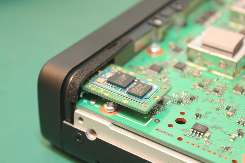

I purchased the UT-133 bluetooth option primarily to test out how well this radio would work with non-Icom, everyday bluetooth devices. The UT-133 is the same module that goes in the ID-5100, so I'll get to test that, as well.

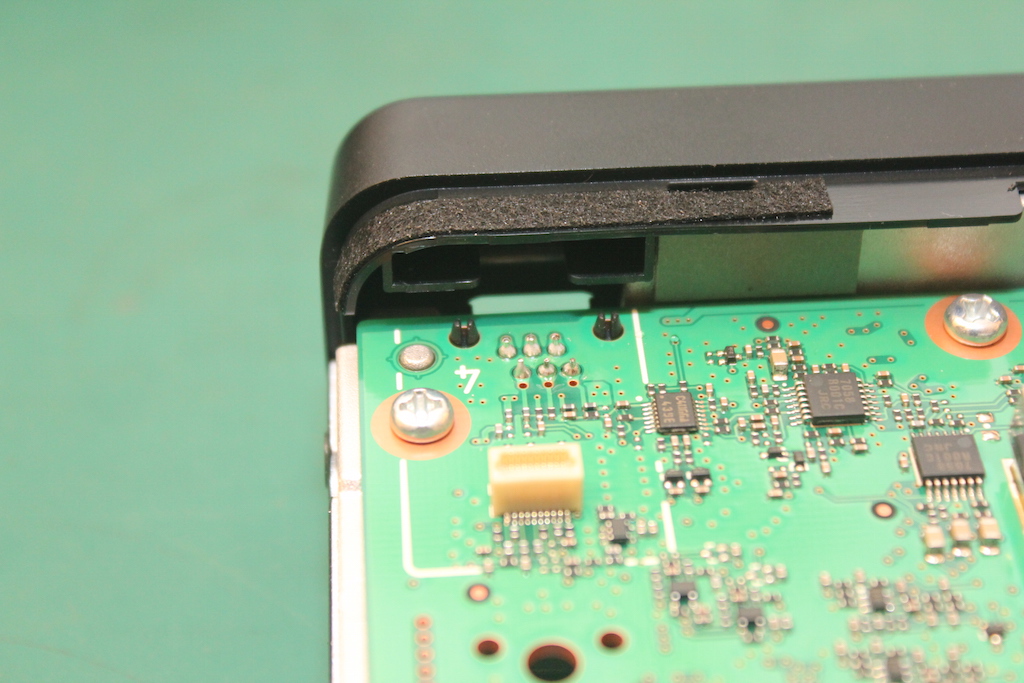

Installation if the module is very straight forward: Remove the bottom cover and find the location where the module plugs in.
Fit the bluetooth card into the slot, plug it in, and you're done.
The radio automatically recognizes it and all of the Bluetooth menu items work without any special configuration. The manual is very clear on how to turn on/off bluetooth, and how to pair with external devices, so I'm not going to explain the entire process, but will be happy to answer any specific questions. The whole process is no more complicated than pairing a bluetooth headset with your phone.

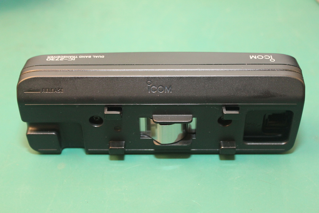

Would you mind posting a picture of the back of the face, without the MBA-4 bracket attached?
I plan on getting this radio and attaching the face directly to a single din blanking plate and tucking the main unit in the center console.
Unfortunately, I can't find any pictures of the back of the face to plan out the install before making the purchase.
