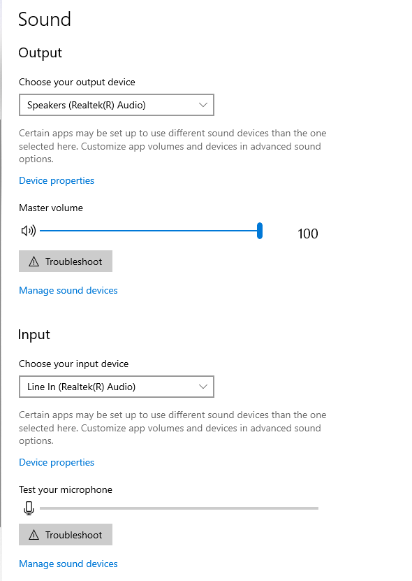

There is documentation on the site and a forum as well. Just install the client software and then run your radio's external speaker into your computer's "line in". Turn your radio's volume all the way down, set your "Line In" and your "Output" to "100" on the volume slider in Window's "Sound" settings:

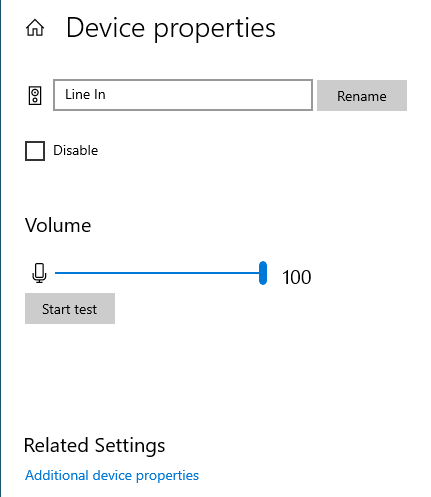

Under "Input", click on "Device properties":

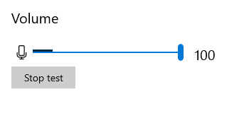

Crack open the "volume" on your radio and click on "Start test". Let it run for 10 seconds and then "Stop test". NOTE: you won't hear anything while doing this.

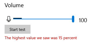

Set your radio's volume level to give a highest value of 15~20%. In my limited testing, this setting seems to give the best S/N ratio. Not now, but later if the volume isn't loud enough, there is an output volume control in the application that can be adjusted to your liking depending on your output device (headphone or speaker).

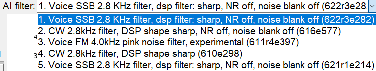

There are 5 different AI filter options:

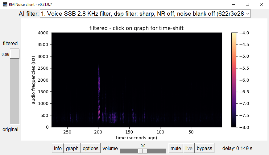

Other than DSP filter set to "Sharp", it is important to turn off all other Noise reduction / Noise blanking on the radio. Under "options", you can set the different input and output options and "activate settings" to select them:
There is a "volume" slider on the main window so you can turn up or down the output volume to your liking. Using headphones, I set my volume to .5.
In use, I have seen default "delay" values from 150~250ms. it all depends on your Internet latency to servers in Texas (2) or Switzerland - the software selects the server with the lowest latency.
The filtering slider can be set from "Original (no filtering) to 1.00 (100% filtering). I prefer to set mine from .97~.98 for just a hint of hiss.
