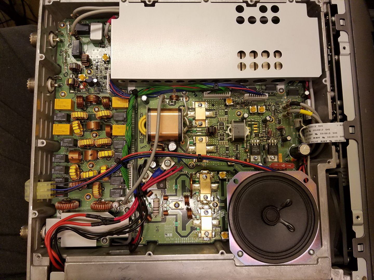

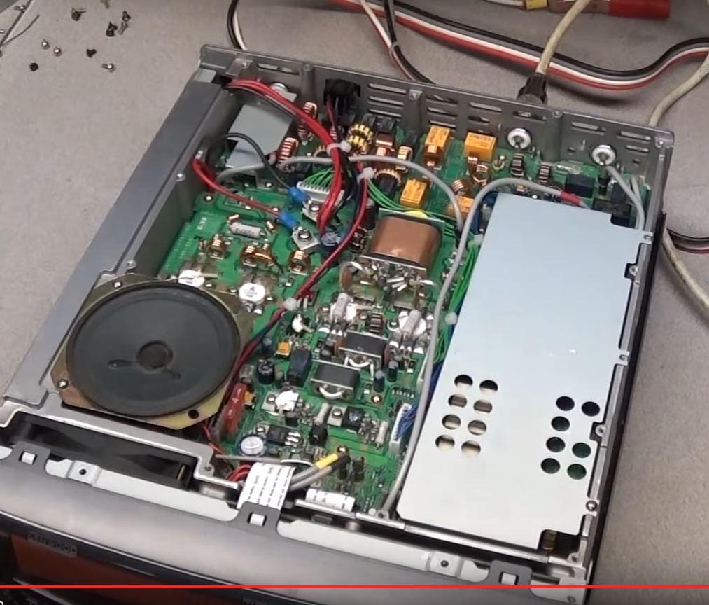

I am having a hell of a hard time finding out what Final Mosfets this has in it.. none of the PA boards look the same and look different from the service manual.. from what i am seeing they switched from bipolar transistors C5125 to mosfets at some point....
My TS-2000
the older TS-2000

Hopefully you can locate the finals for it or get the whole PA section used somewhere.

The schematic diagram I have is for the old Ver... Even the paper work it came from is not right, it is not matching up with what I have so i am flying blind..
