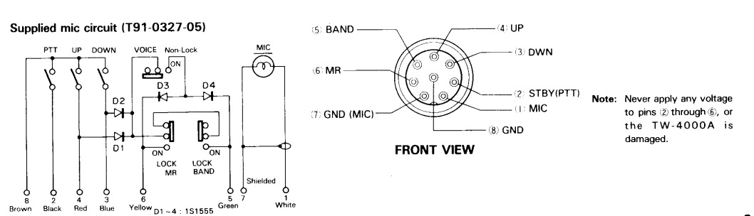

I recall this radio having a strange MIC Hook-up. I believe there are several references even in the manual about using ONLY the supplied Kenwood microphone with this radio. I remember this having a non-standard wiring due to using with tone and voice board.
This rig does not use a Dynamic mic like most Kenwood's of that era. This one had a special electric (condenser mic) element and had special function buttons for tones/voice board operation. (?)
PAGE: 9 of manual

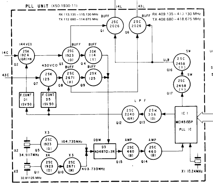

So, The PLL unit, uses two transistors to toggle I'm ok - let's go... moments
Q1 for 2M and Q6 for that 440 band...
IF you don't get any output on those transistors - suspect them or the PLL unit they're on - to need work.

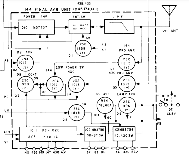

14C and 43C comes off of this to "turn on" the rest of the radio for that band selected...
There is also another spot I find interesting and vulnerable - as in a potential Achillies heel...

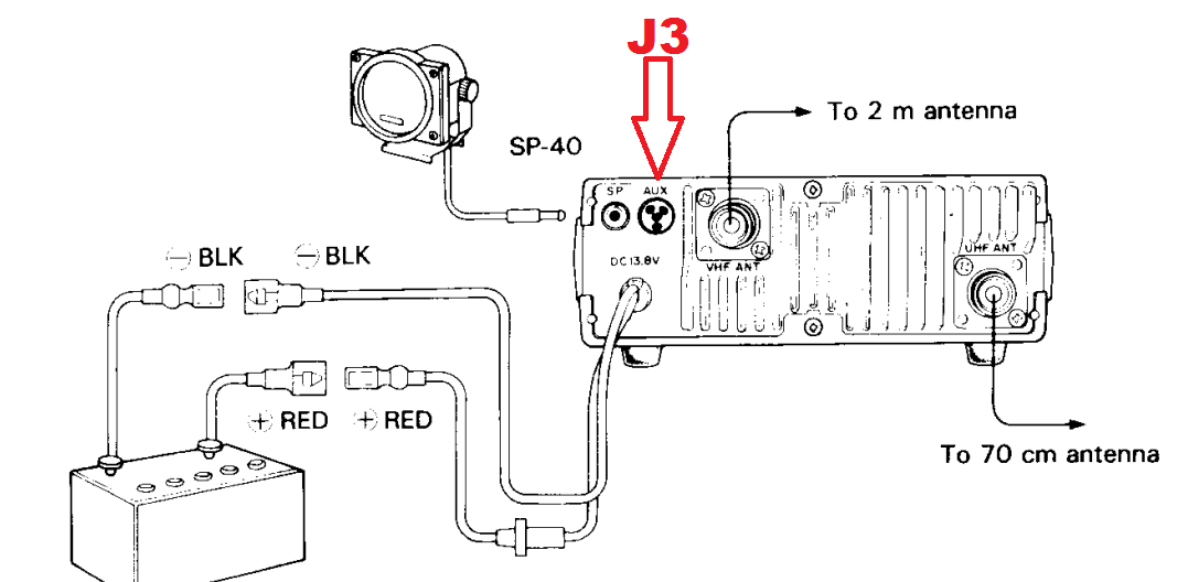

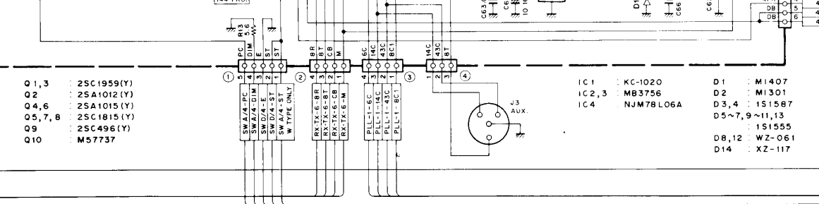

See J3? An external jack in which to use those TX togglers' (ahemn) 14C and 43C (Connector 3 and output on Connector 4) from that AVR unit (main 144MHz board) tap here.
So, to me, I'd look to see if J3 and those TX transistors that run on the TX side - even work - try them on 144 and the 440 bands ...
