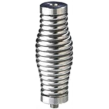

Bought a Hustler resonator spring. It looked small and flexible on the website. Wanted to install at base of the whip. It's stiff as hell. Damn stiff.
I have a 3" spring on my Larsen whip that very flexible and would be perfect. It's aller that 3/8". Any source for a more flexible 3/8x24 spring?
You really don't want a heavy "potbelly" type spring like the Hustler. It's too heavy for the Little Tarheel's smaller diameter coil can't take the stress of that weight and wind loading if you do whack something. I damaged my first antenna doing the same thing.

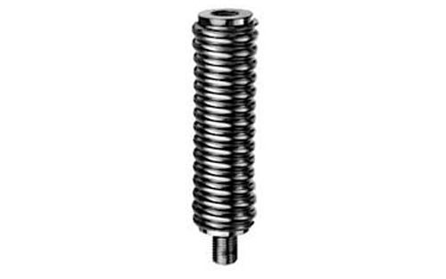

Firestick makes a slimmer lighter stainless steel spring available online with a quick Google search. It is somewhat stiff but a loose spring could make the whip wobble when moving.
The potbelly type does fold over better as some people fold it over their vehicle and strap it to the front bumper to park in a garage.
Firestik SS3H
Firestik SS3H
Firestik SS3H
That's the exact spring I ordered. Must have Hustler brand, too. It looks soft, but it's stiff as hell.
Just for reference, here's a Hustler pot belly spring. This us what I thought you were using.
These are best for 102 whips but they are heavy.
