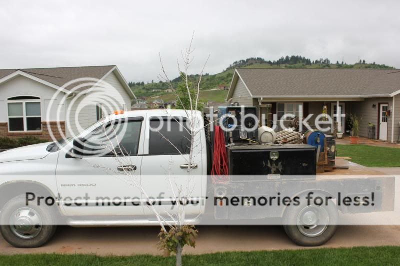

my first thought was to utilize the Headache rack and save a hole in the roof. With the tools/materials in the bed I am sure the mount will last longer than the truck. :biggrin:

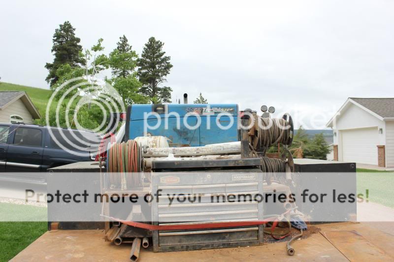

That's a good idea but the bonding must be considered. Bonding the rack to the deck, bonding the deck to the frame.
A friend use the headache rack thing a few years ago with constant pain in the a$$ success. His was onto of the box rails type of rack. It was ok for HF but VHF sucked.
Or, go with what 359 suggests (my favourite) with Sirio or Wilson hardmounted.

Im really thinking that if I bond the bed, cab and welder, mounting to the headache rack would work as well as the roof. I could also fabricate a folding mount if I went this route.
