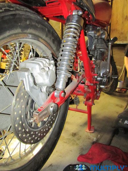

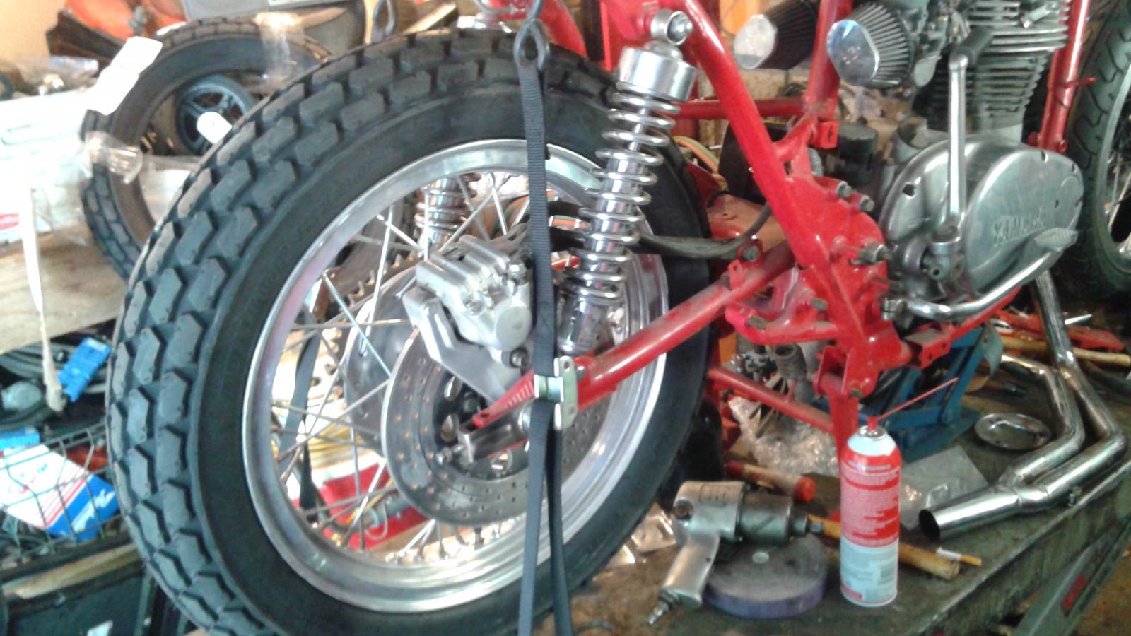

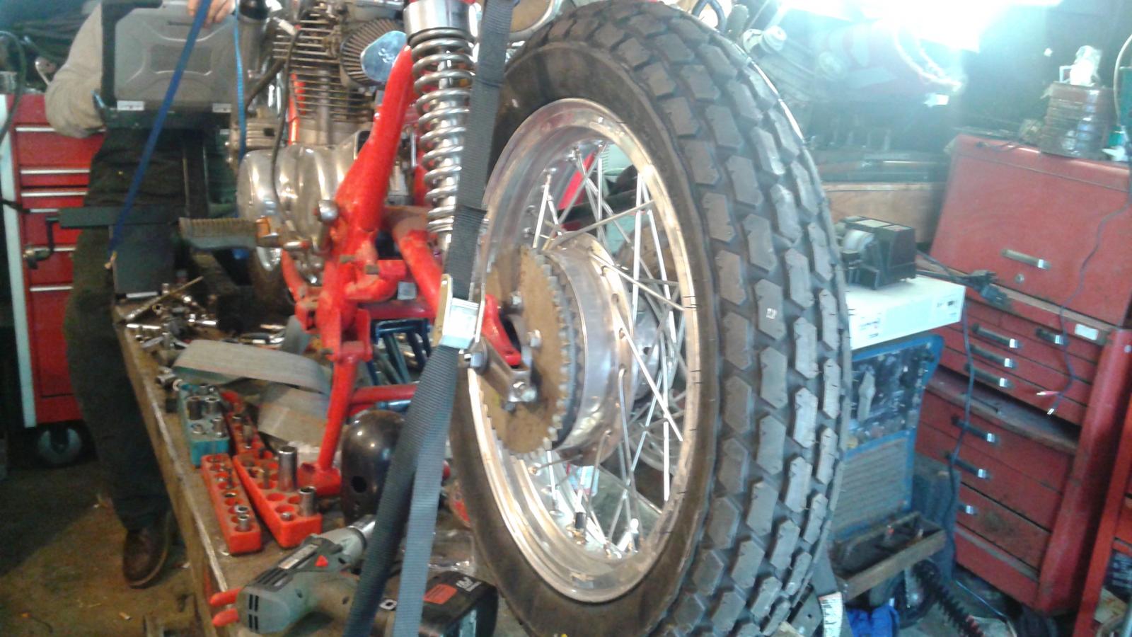

A '79 Yamaha XS650 2FO . I have modified the rear to accept the KZ750B LTD M1 twin 18" disc brake hub . At the moment the front is stock with he the exception of the second brake . The rear is modified only by way of spacers to center the disc in the caliper and turning down the drive hub center to accept more common KZ650 #530 sprockets . The disc itself is a Honda CB200C turned down .200" to fit inside the caliper . The bearings in the rear had to be changed to accept the Yamaha axle .
I found a WM4 2.50" 40 hole rim attached to a Sportster hub and a WM3 2.15 19" 36 hole rim from some dirt bike for the front . Both rims are vintage Akront .The angle of the spoke holes is well within limits for adaptation to the Yamaha and Kawasaki hubs . All I have to do is polish replacement hubs and rims and deliver to the Wheelmaster .

The rear caliper is bone stock 2F0 . I was careful to leave as much of the conversion stock as possible . With the un-modified KZ750B LTD M1 twin 18" disc brake hub and rim the Honda disc centers in the caliper once .200" is taken off the diameter . Now one caution , the disc was "marked" CB200C but I did not take it off myself so I won't swear to it . I'm told that the KZ305 is very similar also so ya pays yer money and takes yer chances . I did turn down one side of the rear hub and I believe it was the sprocket side . I'll know more in a week or so . As the project stands the disc is centered in the caliper and the sprockets are so nearly in alignment that I may be able to let it go . I did have to futz with spacers for hours but it fits . I should say almost fits . I'll have to pull the wheel toward the drive side about .250" to put it on center line but with all else falling into place I'm far beyond complaining. I had considered the modification of the front hub to carry sprocket and disc but going without the dampener was more than I or the gearbox and transmission could tolerate .
