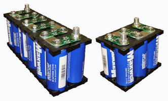

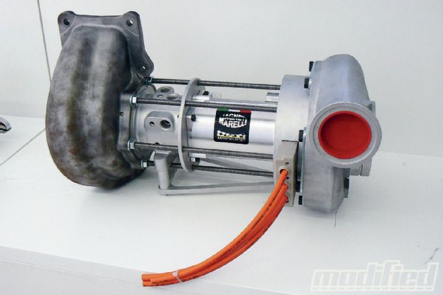

Now it gets weird.
Okay so that makes sizing easier as well as eliminating lag but then adds the complication of an advanced electrical system.
Maxwell is a science all to its own.
Turbo compound. Why not make use of exhaust energy to drive the crankshaft directly as well as feed the engine with compressed atmosphere.
So until you contemplate the entire possibility you don't see all the possibilities or the limitations of current technology. Let's see if anyone sees where this is going :-)
Reactions: Shadetree Mechanic
That is a three phase motor/generator between the hot and cold sections of a turbocharger on a common shaft.
