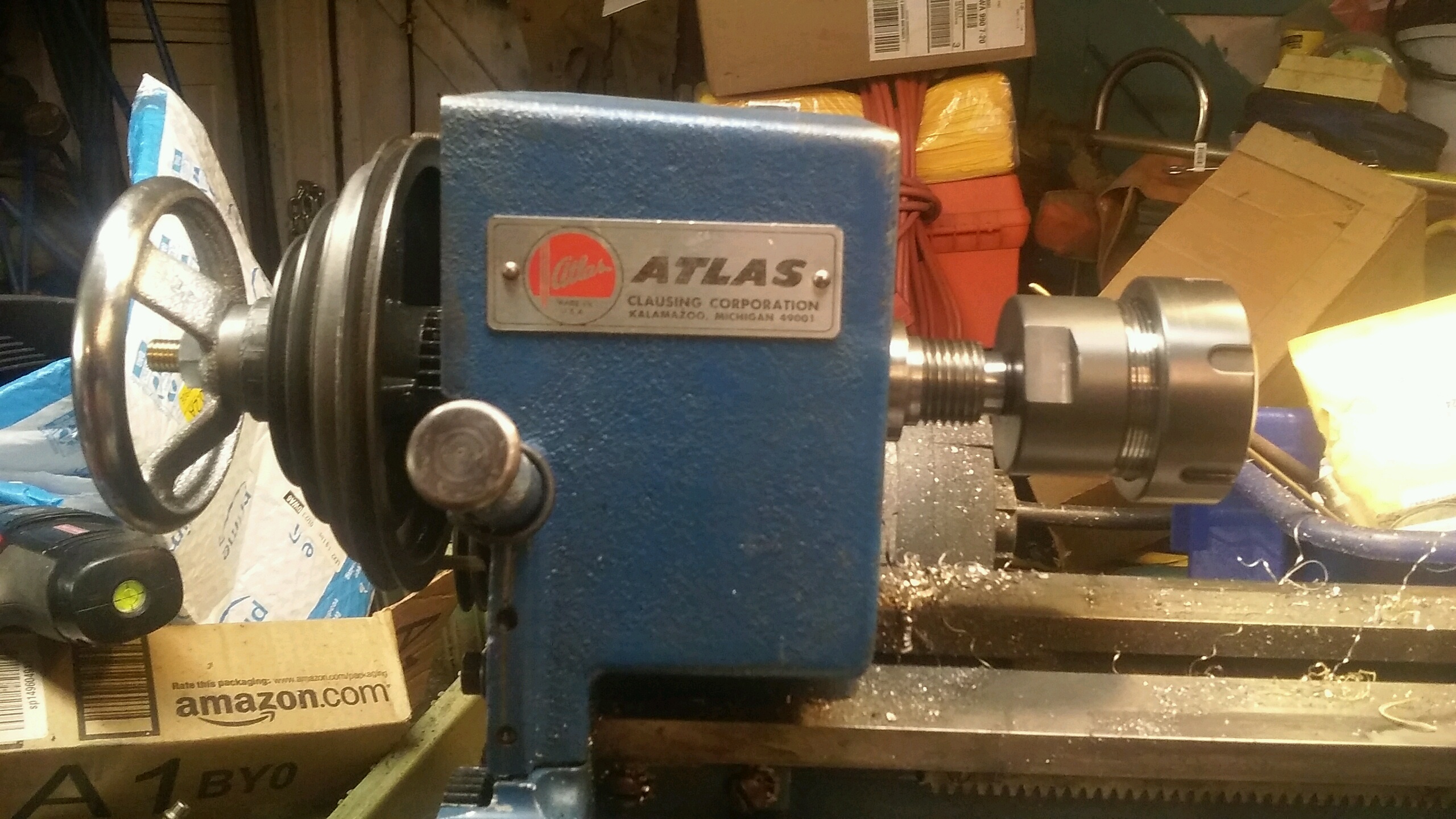

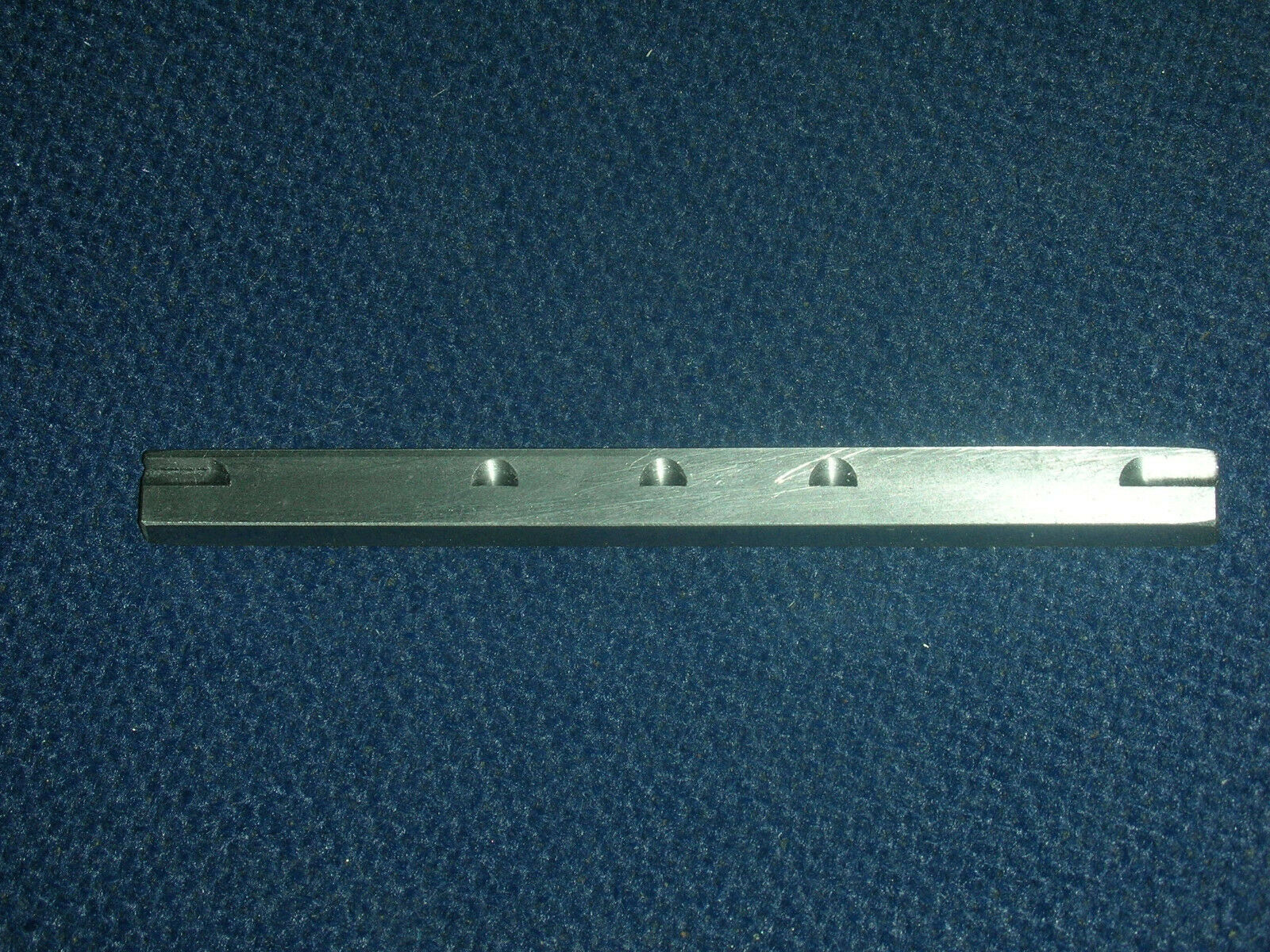

@Rwb , this was the biggest part of it . I got rid of the plastic gibs and lapped in these metal gibs. Huge improvement.
hours.......
Still not quite there. I'm going to let time and use finish the job.
was gonna say take long time getting gibs worked down to perfection. Yes usage will seat them in better.

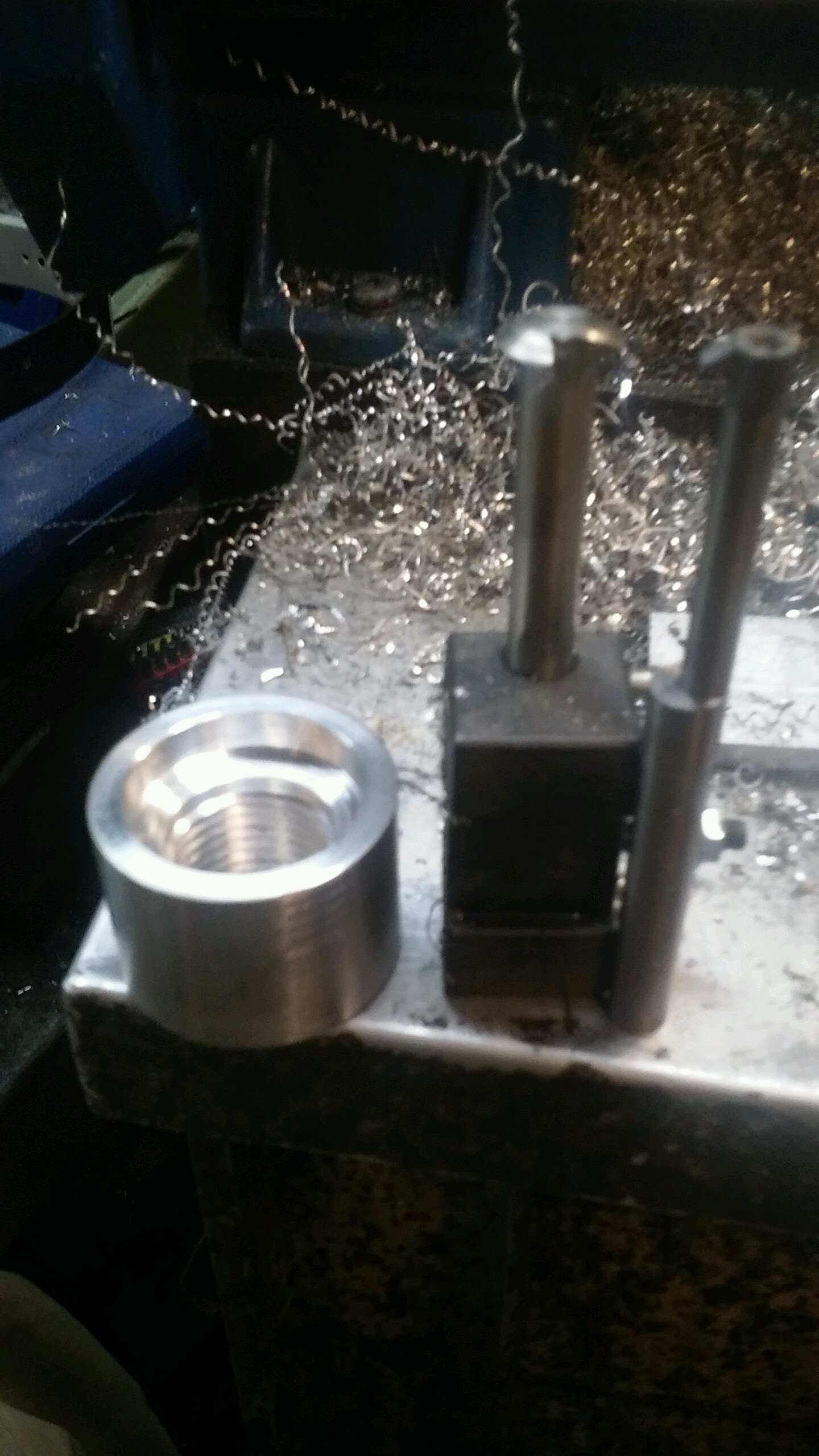

...to review. This is the device in it's natural but very rare state of clean and ready for the next project.
I've been doing quite a bit of work out of the spindle taper. This makes me nervous as the spindle threads and register are exposed to damage and stupidity.
"Never underestimate he power of human stupidity, this includes your own".
The tool on the left just wasn't rigid enough and no amount of spring passes would complete the threading. That and curiously enough the "tune" via chatter that the overhang was playing tended to make the tool holder rotate on top of the compound no matter how tight the post bolt was.
The tool on the right was a close relative of some sort of stainless. More likely a 41xx variety. A total PITA to machine. In the end I got the tooth profile in. Without hardening it took and kept an edge and appears to have changed it's tune (resonance).
Once I got it to begin threading I ran maybe 6-8 spring passes with naphtha (zippo fluid) for cutting fluid. The counter bores are 1" to clear the register and 1.63xx" to clear the shoulder so that the threads, register and shoulder are protected.
I feel a whole lot better now when a chuck isn't protecting the threads.
