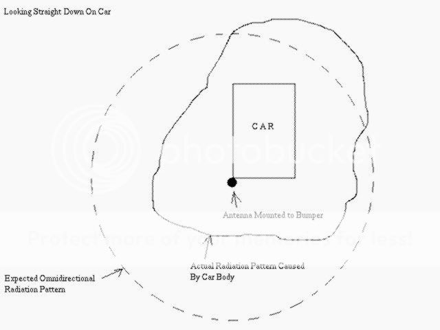

You might want to keep this in mind when mounting an antenna ...........

mounting on the roof is the preferred way since it gets the antenna as high as possible and it also ensures that the coil for the antenna is above the vehicle also . its provides maximum transmit and receive performance . mounting it in the center of the roof gives the most omnidirectional pattern for that TX and Rx . mounting towards one end or corner or side of your vehicle will make the TX and Rx favor the opposite end or corner or side . will in make a huge difference for your particular install ? that depends on a few things . but , you should notice some positive effects on your TX and Rx .
