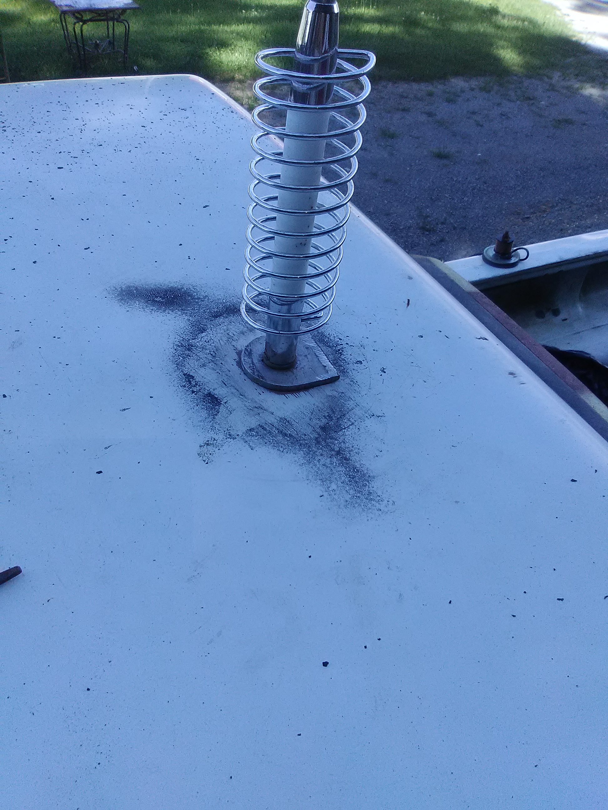

Thanks for all the input guys. Guess I will leave the stock mic on it. If it ant broke don't fix it what I was always told. So what would be the best bet about my antenna situation?
Several options, use what you have and relocate it to either the center of the front bedrail or roof mount it.
Or install a 102" SS whip on the front bedrail, or roof mount a Wilson 1k\5k. Whatever works for you. (y)

Gonna try like this first wish me luck

In the past, a lot of guys would mount a 102 inch whip on a 6 inch spring on the corner of a truck bed corner. The 102 inch whip is also called 'the quarter wave antenna'. This antenna also provides no gain; but does attain 'unity gain'. Nothing gained; but then again - nothing is lost - either. They don't work well while rolling, because it will whip around quite a bit and therefore doesn't provide a stable transmit pattern. But when parked on a hill, they are the king of it. At least, as far as tx and rx is concerned, and the best that a mobile system can do . . .
I ran a 102" whip on a small, 2 door, Saturn. Made a trunk mount and it worked great and looked like a RC car, hahaha!
