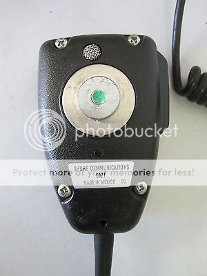

100hz-20,000hz for less than 20 bucks. Let's see who gets this done first......
http://m.ebay.com/itm/LOT-OF-3-SHUR...NDENSER-MICROPHONE-ALM24-CABLES-/322481625755
Reactions: rabbiporkchop

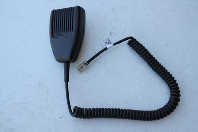

You're going to drive yourself nuts trying out all the very usable and highly affordable condenser mic elements available on the market. Just pick out a frequency range and response curve you like and go at it. Even Rat Shack had a desirable version for like 2 bucks.
It's not too often you run across the perfect housing with an opening on the front and rear..
I just figured I'd share that in case somebody decided to take on a project.
Without a doubt a perfect housing for a NC project, but w/o looking on EBay, how readily available is that old model Shure?
I would bet that mic would have better voice quality if the impedance was 600 ohms or less since most mic input impedances are around 600 ohms.
When you use a high Z mic into a much lower impedance input its like forcing a 4 inch water line into a 1 inch line. The result will be too much resistance, not letting all the water pass. With mics this will mean many voice quality frequencies will be blocked from being passed. In the pro audio world, this would give a dull and lifeless sound that I doubt any sound engineer would accept unless purposely going for an effect.
Impedances don't have too be matched, but they shouldn't be substantially higher than the input. Many pro mics are around 300 ohms and will pass excellent voice quality audio just like running a 1 inch water line into a 4 inch line, no problem because the all the water will flow into it.
RK 56 mics are high Z mics and while they do have thier own sound, I find it to be dark sounding where as the Astatic 636L is 200 ohms and sounds more open and clear to me.

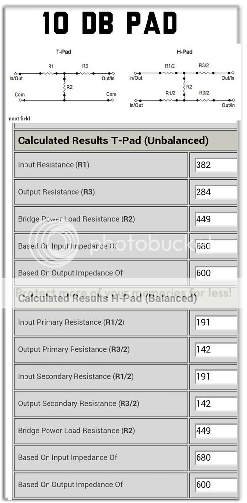

It's really easy to build an Attenuator pad to match the impedance as well as attenuate the signal to whatever amount you need.
