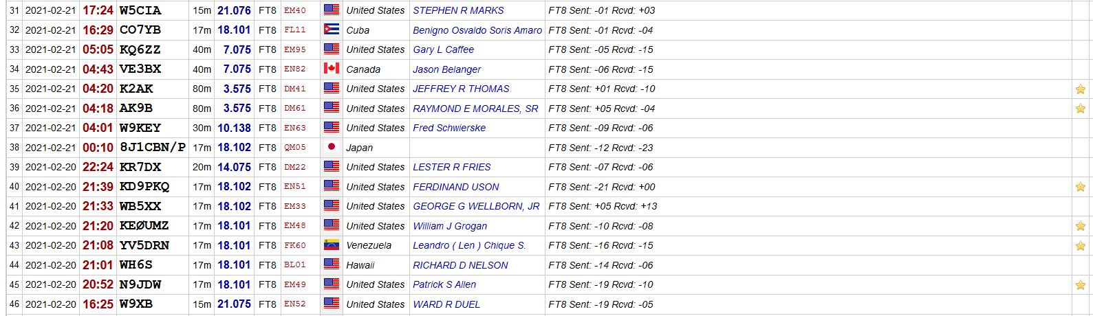

So my 80M Dipole started acting weird after our last windstorm... so I had a reason to put the new Palomar End Fed Bullet 71" I had.
Set it up as an Inverted L: 17' vert up the tree, the rest heading across the back lawn about 25' AGL in a South direction...
Threw down the 2 15' counterpoise wires, a 45',a 10 ' and drove a 8' ground rod into the earth right below where the antenna hangs... connected the Bullet to the Ground rod with some 00 gauge wire I had...
40 watts on FT8 was pretty fun:

This is the most Amateur radio contacts I've made... in a VERY long time...
First time I've made it into Russia
hit a operator in China, but couldn't seal the deal

I'm pretty happy, pskreporter showed I was getting out.
