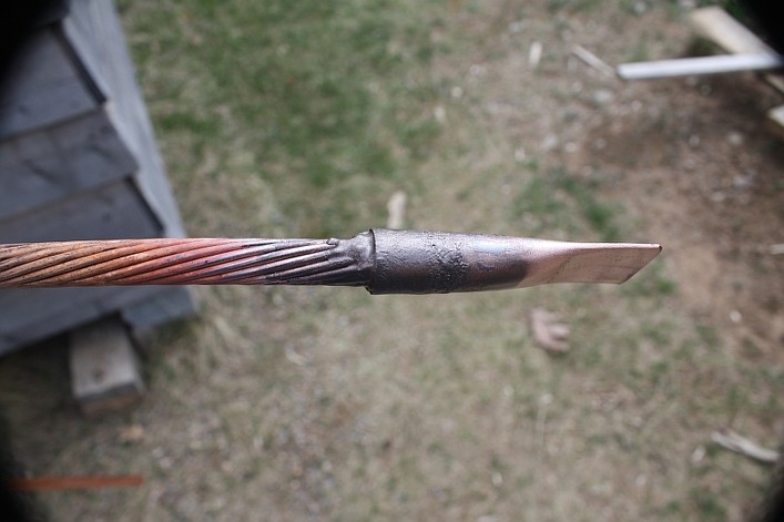

Triple ought (000) gauge ground cable with home made lug brazed with Selfoss.

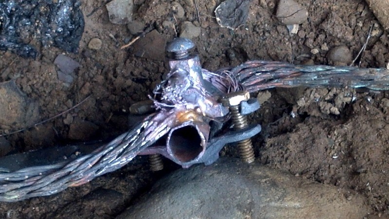

Not my best work but better than clamping alone since this will be buried.At least it is bonded to both the copper pipe and the ground cable.

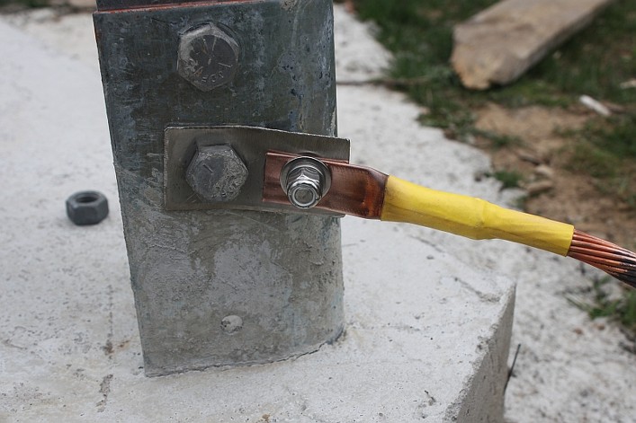

Stainless strap between the copper and the zinc galvanizing.

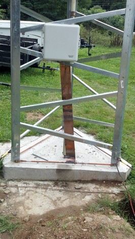

Four inch copper strap connecting lightning arrestor panel to ground buss at tower bottom.
