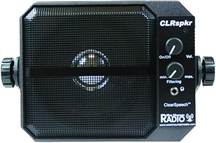

There isn't "noise cancelling" headphones I know of, just speakers with noise filters on them that do have headphone jacks but they get expensive. The West Mountain radio speaker has the better if not best DSP filtering but it's a $200.00 speaker.
