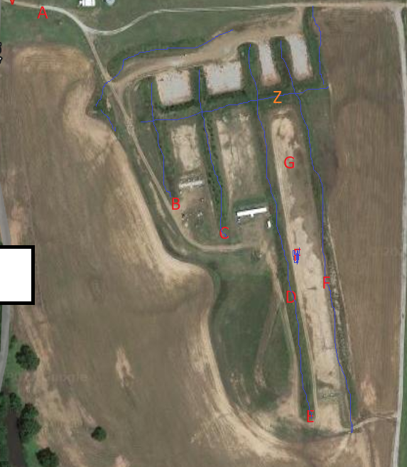

Here is the type of geometry/distances I am talking about:
A is the alert location.
I am located at G.
The blue lines are 20-30ft tall mounds of dirt. The mounds of dirt are up to 30ft thick.
The distance between A and G is 325yards.
I have tried the MURS-base antenna at A and it could not get to G.
The stock antenna even has trouble even getting from A to B, even though it is line-of-sight, except for some 6ft tall grass.
I also tried tying a rope to the receiver and throwing it up to the top of the mound at point Z. The stock antenna STILL could not get a communication to that receiver on the top of the dirt-mound (could not accomplish A-to-Z-to-G communication.)

Beam antenna in a tree? There must be an easier answer. What is the distance?
There are absolutely no trees. There is a tall silo in the upper left of the picture I posted in the post above. But I am not really supposed to be climbing up on it. Also, even though it is tall, it is still not tall enough to get line-of-sight to location G.
On top of all of the above, I have tried putting a tall pole on the top of my vehicle at G, a total of 11.5ft off the ground atop of which I placed the receiver radio. Still a fail in getting from A to G (that's with or without the MURS-base antenna at A). The pole was a hollow metal broomstick if that matters.
I tried duct-taping uv-5R's together with VOX on one of each pair, trying to get the repeater effect --it did not make it past point B. (I had an intermediate pair about half-way between A and B.)
I have tried zillions of things, but not the right thing, at least not yet.
The only thing I have not yet tried with the equipment I have right now, since I only just got the amplifier partly running two days ago, is to run the amplifier with the MURS-base antenna at point A.
I am not optimistic. I don't think you can penetrate 30ft of dirt just by using an off-shelf-amplifier, at least not with 2meter wavelength.

Put a cross band repeater using two baofengs at location X (well, a little south of that, picture too small). Repeater at X receives MURS and transmits on FRS.

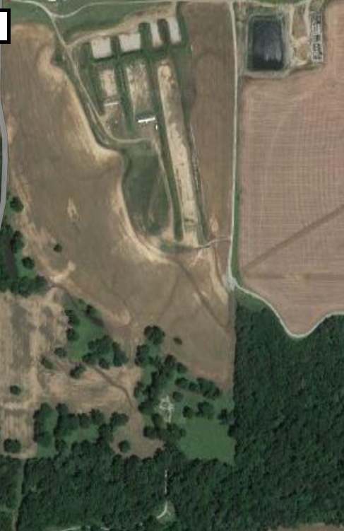

Also, here below is a bigger picture. I will have to check to see if point X is in cropfields where I cannot walk....
