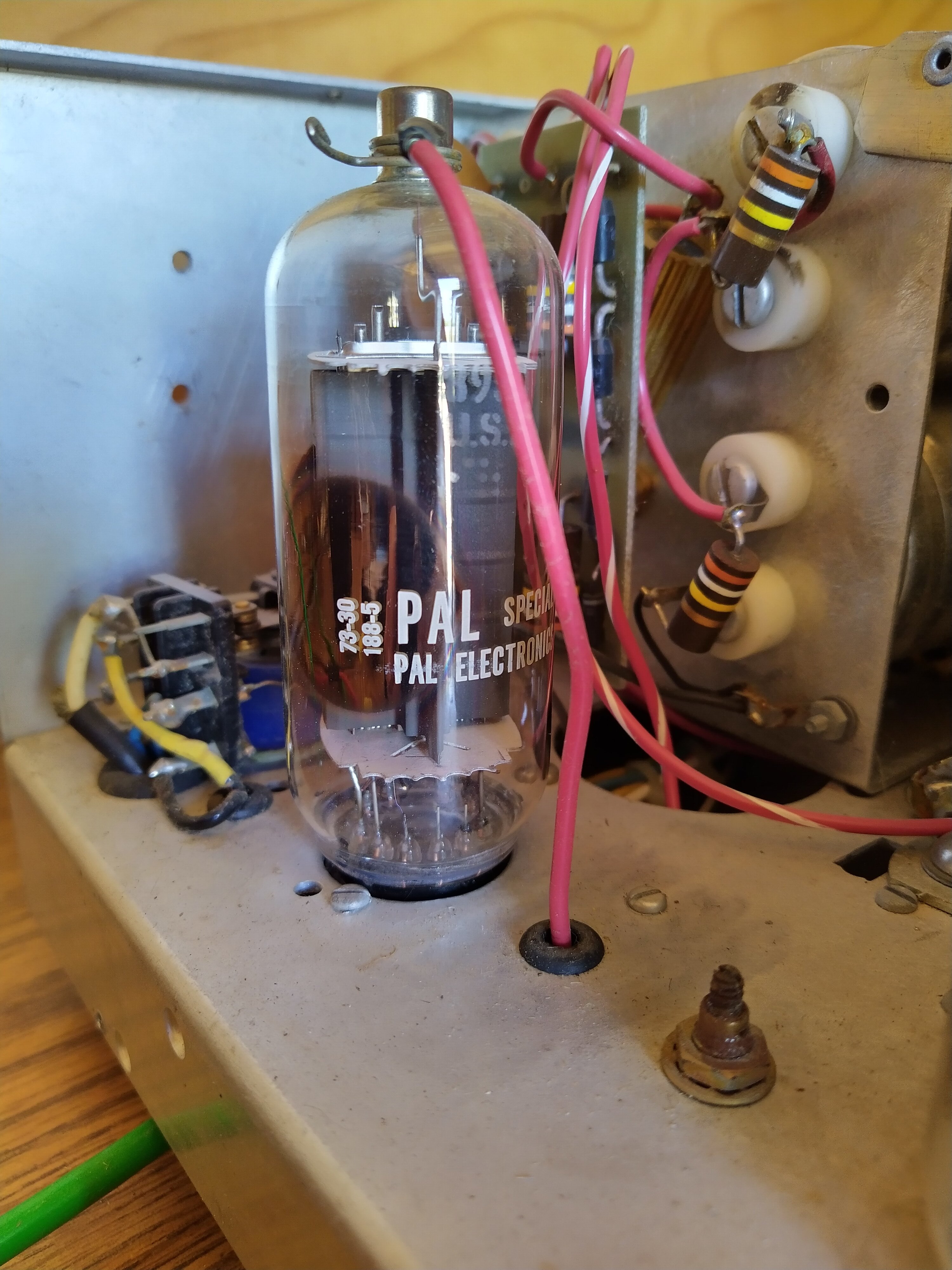

Well, I got to stop by & take a look at that amp today. Got to look inside as well. I'm thinking that the tubes are starting to go bad. Then again, they all had Pal electronics silkscreened or painted on them. Either they have never been changed, or the previous owner was able to buy replacement tubes directly from Pal electronics. I checked all mine of them & got a box of the easiest to see.

That tube has an "open" 4-digit date code. Tubes sold in bulk were marked this way, two digits for the year followed by two digits for the week of that year, 01-52.
The tube in the pic says 1973, 30th week.
Tubes sold in individual retail boxes one at a time would normally have an encoded date, usually two letters. This way, a retail customer would not gripe about a 'new' tube having an 'old' date when he bought it. The tubes that PAL bought to make this box were delivered in 'egg-crate' style trays in a box of 144, typically. Those tubes usually had an open four-digit date marked on them.
The age alone tells you only so much. The mileage counts for a lot more.

From the looks of the one driver 8950, that tube shows zero signs of having suffered any abuse. The silkscreen is not dark, the getter flash marks are completely intact with no migration off the glass and the entire envelope is clear, even around the focal point of the beam plates. If it's dead, the cathode "fuse" on one of the two pins (8950's have two chances) probably opened or it had a nice easy life with enough hours to finally deplete the oxide coatings of the cathode. I'll bet it's still good. If the rest look the same, get them tested before replacing.
One thing to note about the 6LB6 is that it has about the same plate dissipation as most larger sweep tubes. However, the difference is in the peak cathode current ratings and they are lower on the 6LB6 because it has a much narrower cathode than the 6KD6. It's all about surface area here and you can see the difference in the middle of the tube and on the PEP watt meter in many amplifiers. It is not enough to notice on the signal meter and these tubes are still good substitutes when found economically.
You might want to take and post more pictures because one of us may be able to spot whatever the issue is, in the event it's not the tubes.
