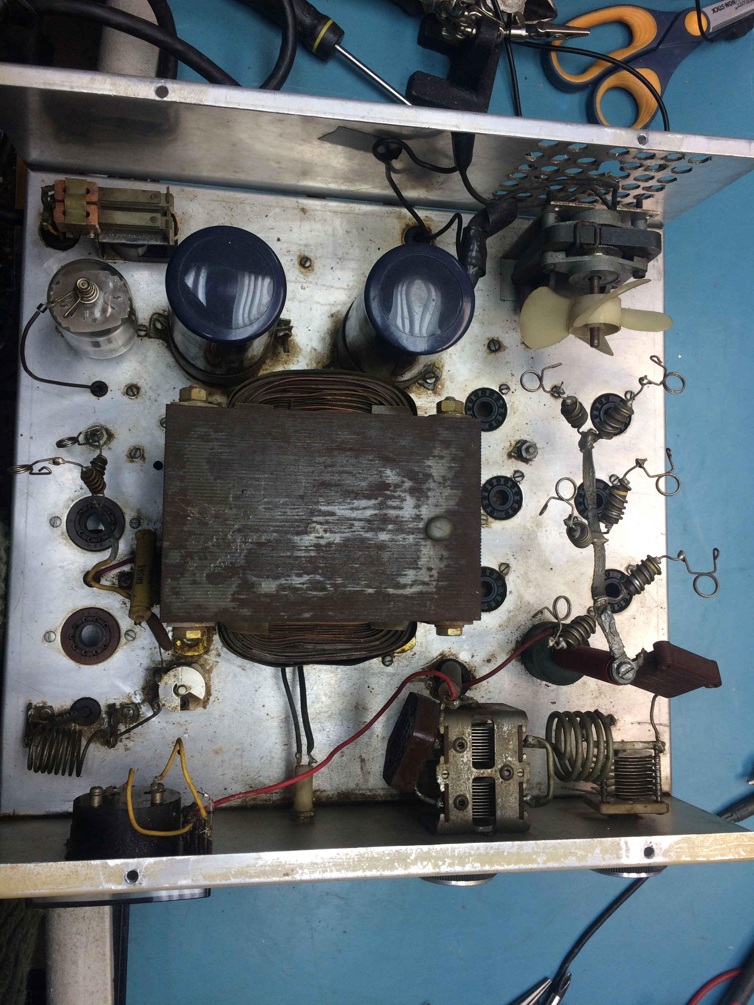

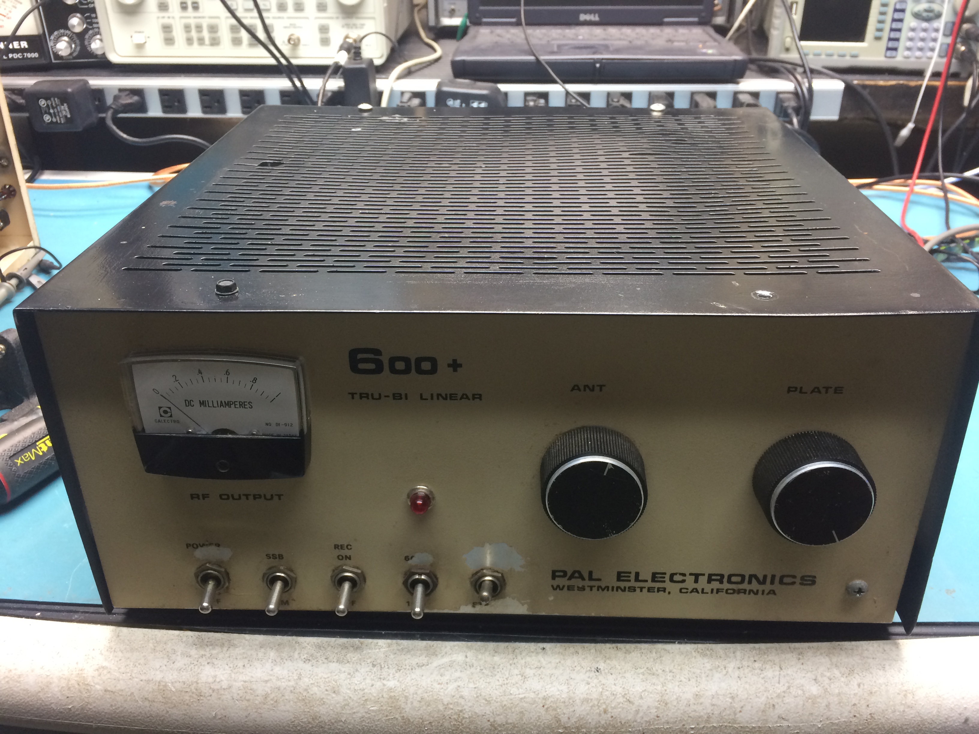

I had this amp given to me for some work I performed. I wouldn't mind re-doing this amp but I cannot find any info on the net about it. I would like to know what tubes it uses, It only had one tube in it when I got it. Thanks.
If the sockets are wired 6v then 6lf6/kd6/lb6 if 12v 8950 would be my guess as I believe I see 12 pin sockets.
Not too tough to convert to the cheaper 6v tubes. Youre going to have a small fortune in this box before youre done as 6lf6 tubes are $40+/tube compared to $125/tube for the 8950 if you can find them.
Reactions: 2NC995
Nope, upon further inspection I see 9 pin sockets which means 6lq6/mj6 maybe. In that case 6mj6 will be your better tube but again more expensive. There are other 9 pin tubes it could be also. What tube is in it now?

I can also see where it looks like the deck was partially cleaned but really needs to totally stripped down to get all the gunk out. Looks possible it was in a smoking household for some years. Cigarette tar is an sob to clean out of a ham amp and sometimes impossible to clean so you have to replace components like relays. You might be able to get it cleaner with a bunch wooden cotton swabs, some denatured alcohol and several hours of tedious swabbing lol.

6KM6 has 2/3 the rating of a 6LQ6.
First thing I would do is lose the 1-tube pre-driver stage altogether.
Most any base radio has more than enough power to drive the two-tube stage plenty hard enough.
Just about every three-stage amplifier I have ever seen just has too much gain. Makes them hard to keep stable. Hard to find a radio small enough to match a single driver tube.

Looking that OLD girl over, the price to retube plus adding more cooling. That amp will be a money pit.
I see new caps, tubes, relays, fan for driver stage, fan for the final stage plus new chokes. Then add the time you're reaching the point where you could buy a nice clean used AL-80B Ameritron and get the same results on the meter.
NOMAD: Agreed, that 1 driving 2 is a meltdown waiting to happen. Today's radios have ample drive or more for even 2 tubes, let alone the single.
GL Bro, even with used tubes that amp is going to be a big investment, 6LQ6/6MJ6 amps in that caliber are just getting too hard to justify.
A 4 tuber is my limit in the final stage, just not enough power vs. investment there.
I have a couple HULK maverick 250's here, won't touch them, I did covert one just to a final deck (4 tuber) removed the entire drive section.
The old amps just with 6,8,10 God forbid 12 tubes, even converting to Rusky tubes looking a couple hundred $$ in tube cost alone. 10/12 tuber more like $3-400 maybe more!
