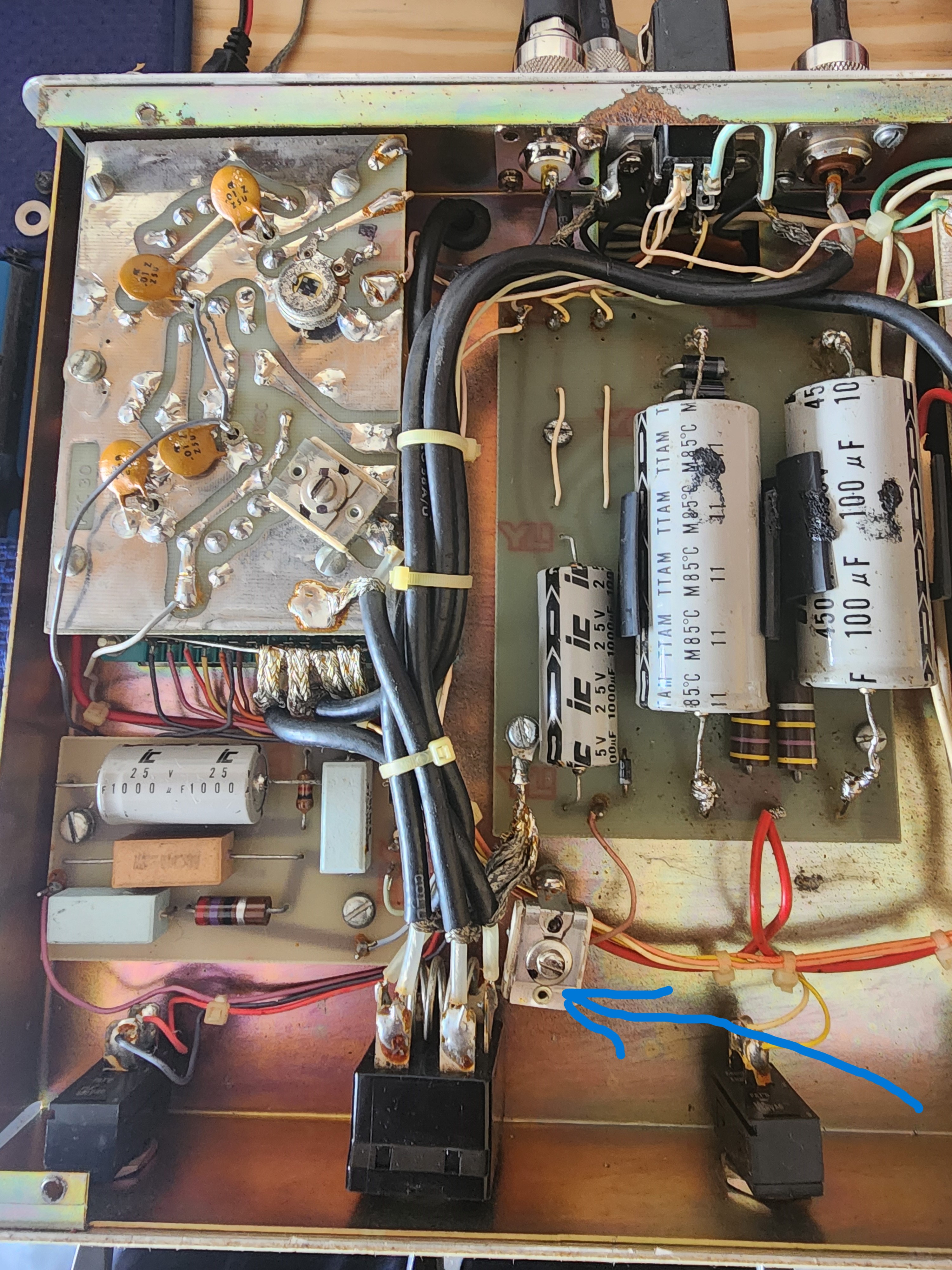

Is there a way to make the 20,40 band on a Palomar 300A have a lower input as it does on the 10-meter band with the input and output trimmers
I was tunning on 20 meters today but my Yaesu ft-890 kept flicking a high SWR light I turned the auto tuner on it kind of helped but made the tuner get hot quickly being SWR was past 3.5 I turned it off and put my MFJ auto tuner in line radio show 1.2 I want to make it work with out having to use extra equipment in line if all possible

Here's your problem. The band switch only tunes the plate circuits on the output side of the amplifier. The input is tuned for 11 meters only. Or 10, if you like.
The band selector does not include a section to select a separate input circuit for each band. I really don't think they anticipated anyone actually trying to use the other bands. The band selector was just a fig leaf over the private parts. A way to pretend that it was a legitimate amateur gadget, but without spending any more money than they had to for the pretense. This "loophole" got them off the hook until 1979 when the FCC tightened the rules defining a legal amateur amplifier. That's the year that 10 meters disappeared from the front panel of legal ham linears. FCC said 10 meters is too close to 11 meters. The year that spelled the beginning of the end for Varmints, D&A and Black Cat stuff.

so without sending it to a shop, it will be cost-effective, and cheaper to buy a ham amp. 300A will be a splatter box on 40,20 ??
If you don't overdrive it, it won't be a splatter box. However, you will need to use an antenna tuner with it in order to get that input SWR manageable. As long as the output Tunes properly without the load or tune control all the way to one side, it shouldn't be too bad.

There were a few 3-band Phantom amplifiers that had a "band" switch on the rear panel. It would bypass the 11-meter tuned input circuit, and feed drive straight to the four driver tubes. Input-side SWR was really high using the straight-through option, and power would drop.

being that the driver section is not being used. would 40 to 60 watts drive from the radio be considered a safe zone.?? For SSB
Here is an update my OCD and Marine attitude would not take defeat after a phone call this morning I fixed my problem the trimmer shown in the picture took care of my input best I can get is 1.4 from almost 2.8
