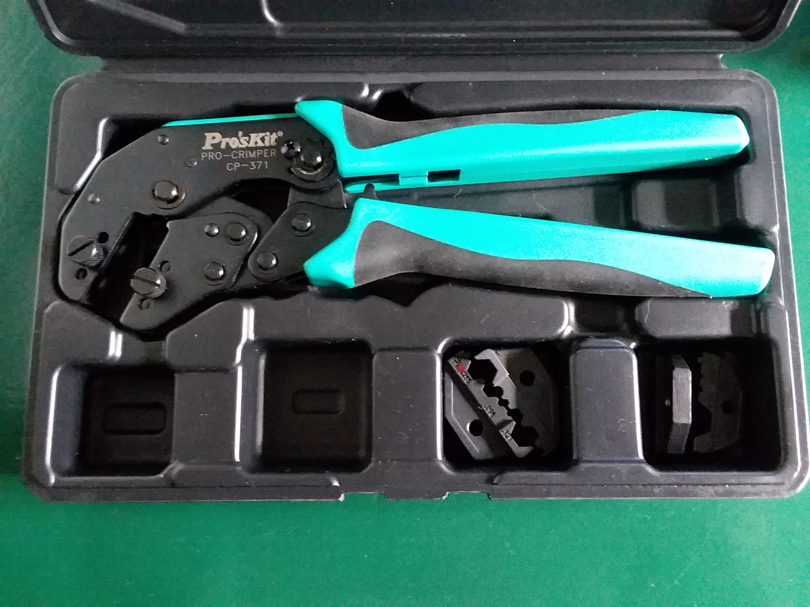

I am using a set of Pro'skit crimpers model CP-371. I also have a smaller set of pro'skit crimpers I use in the shop for auto crimp terminals. I believe the CP-371 is the same crimper that DX Engineering sells but with red and black grips instead of green and black grips. Pro'skit sells a huge assortment of dies and you can buy direct off there web site. I will post a picture shortly.
